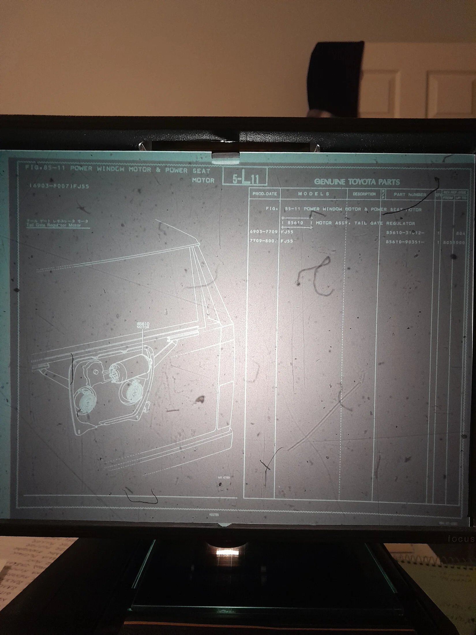

The p/n for the 03/69 to 09/77 motor is 85610-31012. Sorry about the pic quality.
Actually the answer is no if you are going off part numbers. Of course they are probably still interchangeable as it could be as simple as a different connector.
85610MOTOR ASSY, TAIL GATE REGULATOR
85610-31012(03/1969 - 08/1977)
85610-90351(09/1977 - 06/1980)
