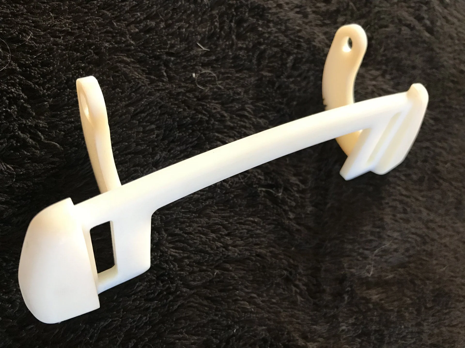

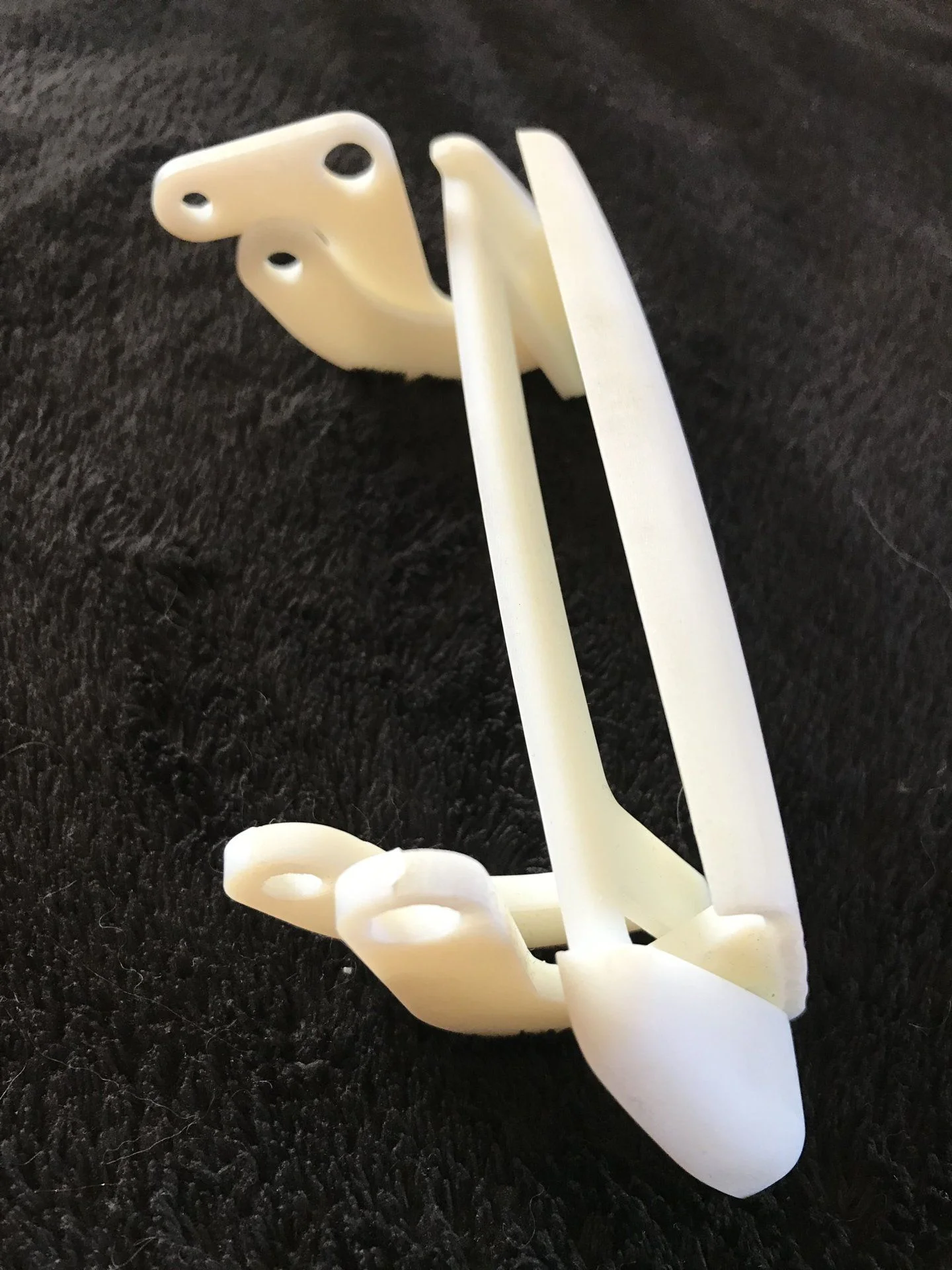

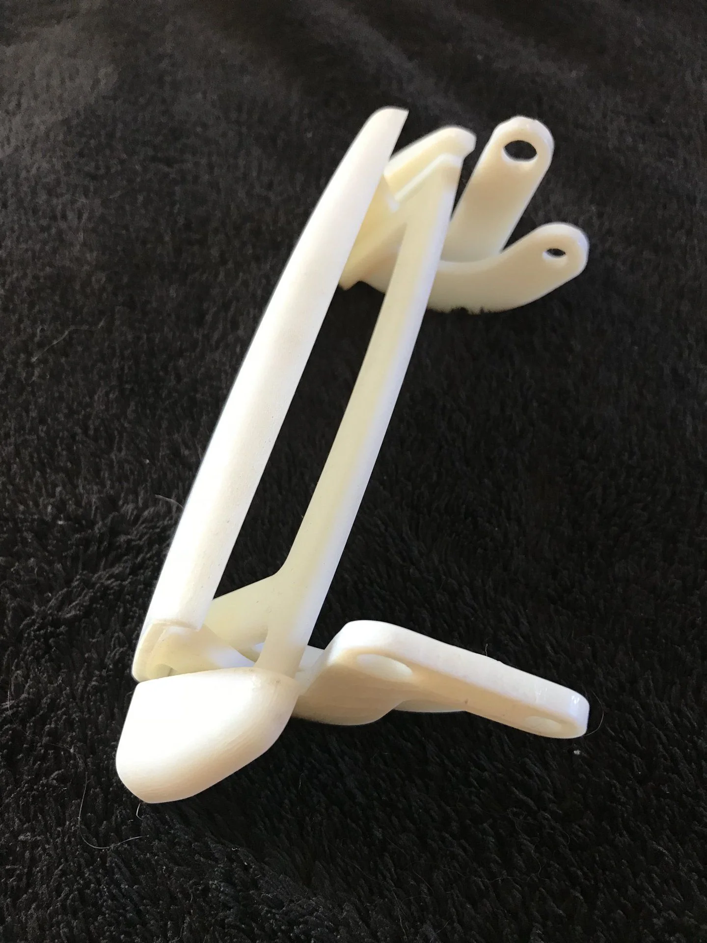

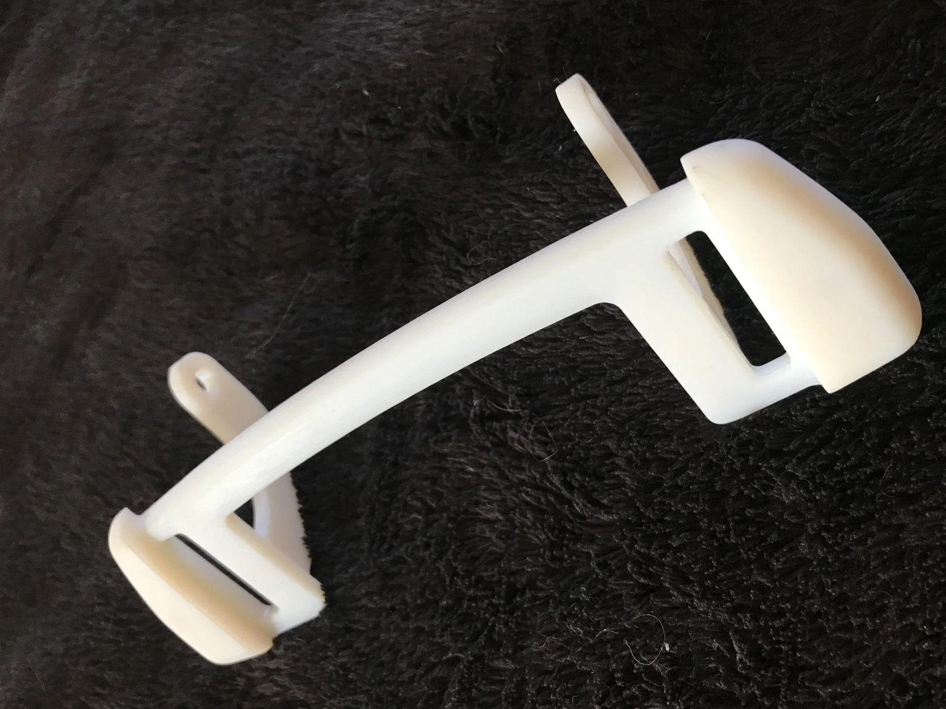

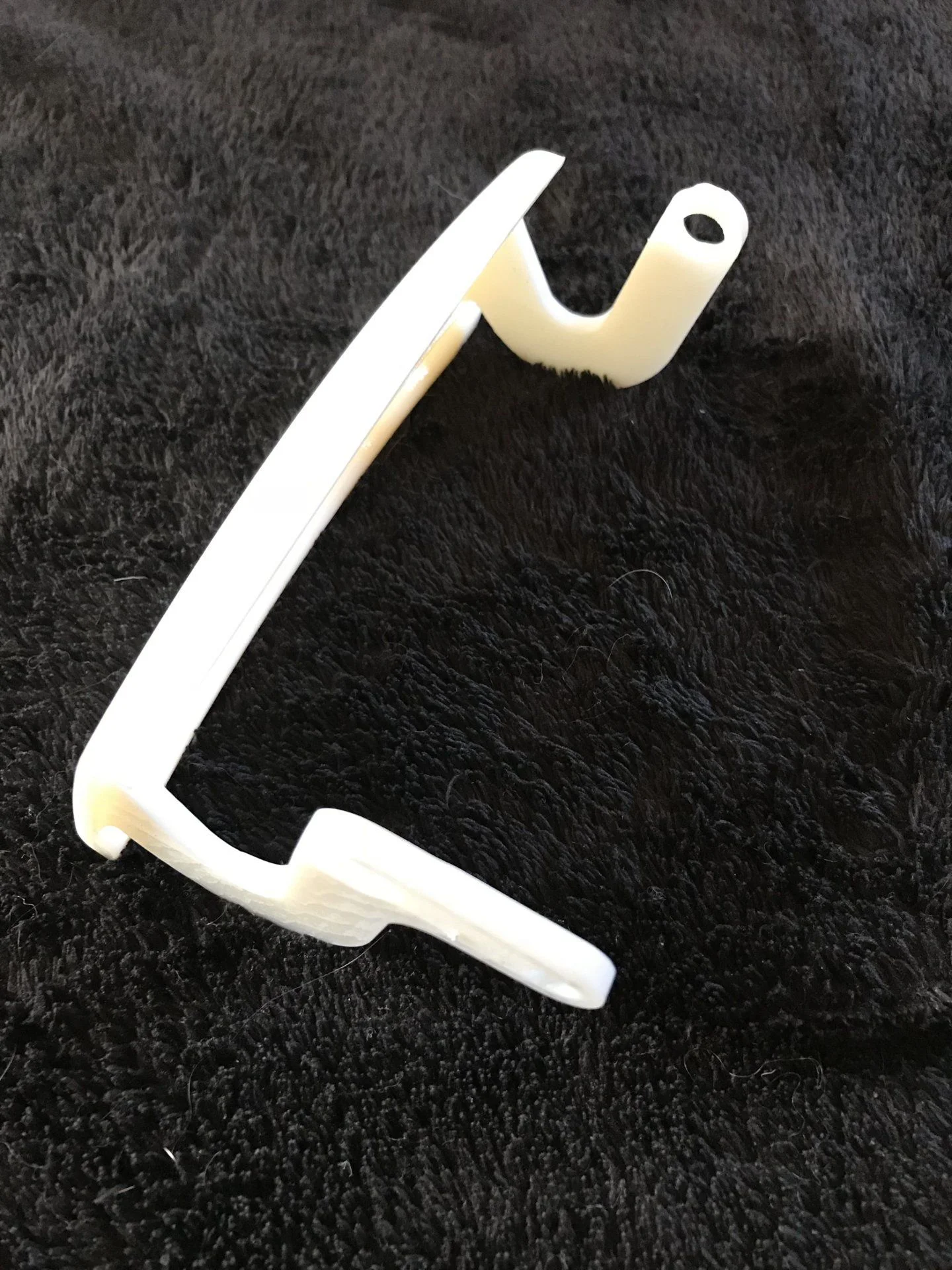

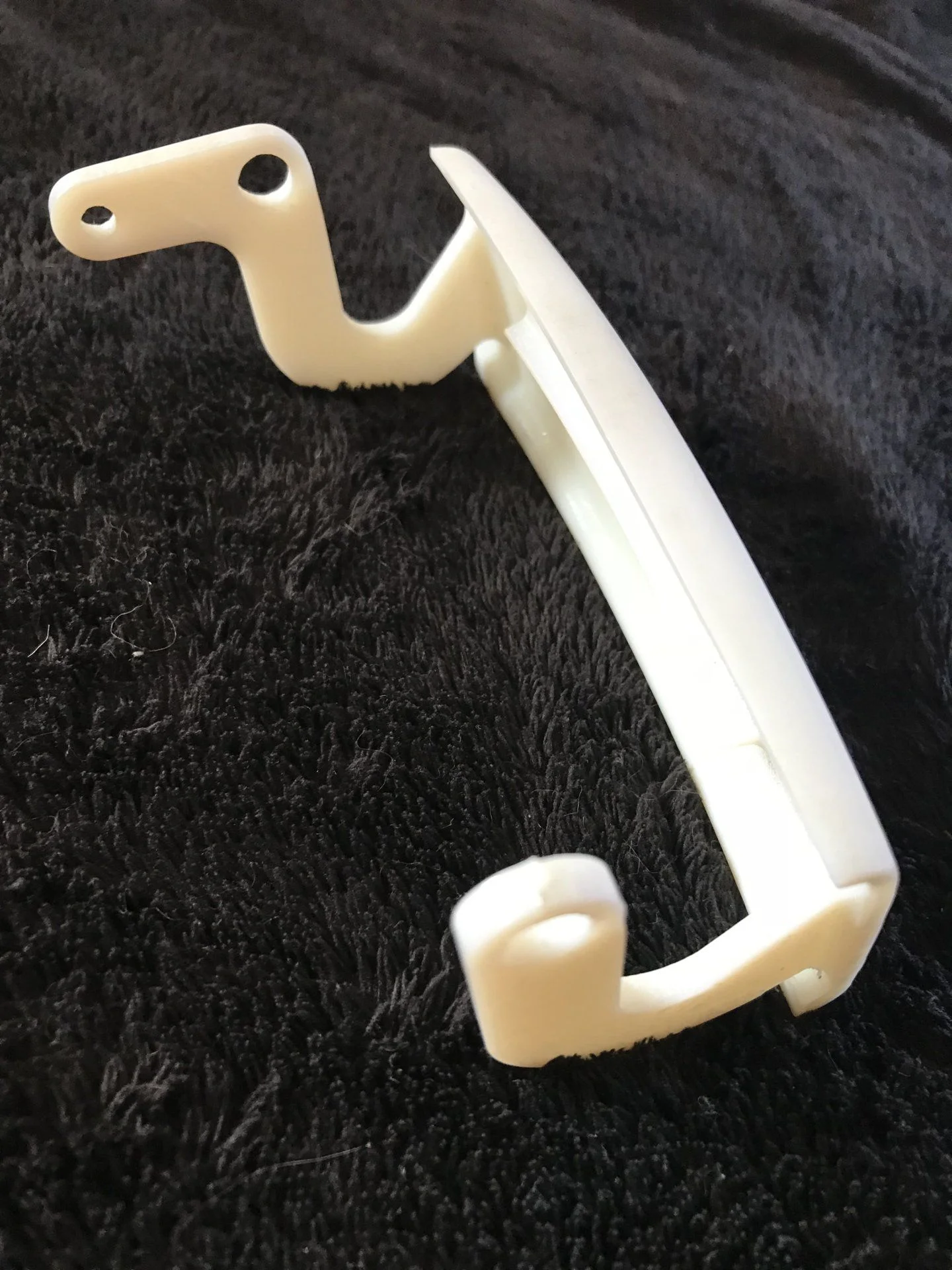

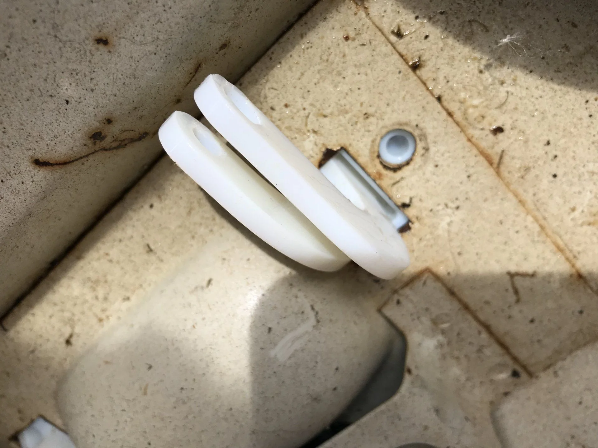

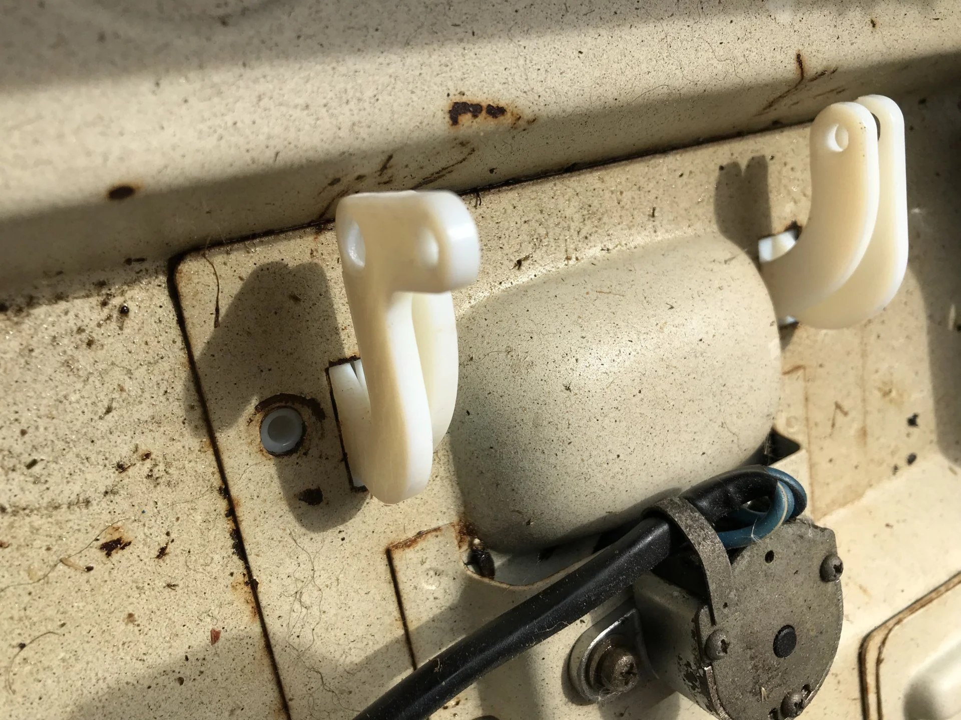

@DoubleNickels and I started talking about printing the tailgate handle in stainless, how that could polish up into a nice piece. We agreed to start with a plastic prototype that I would test fit on a spare tailgate that I have lying around (thanks Ige @nuclearlemon ). So @DoubleNickels (aka Calvin) printed the plastic piece you see below and shipped to me. BIG thanks Calvin! I will go try that now.
This piece would likely require polishing. It would be a reproduction of the older style handle that screwed together. You could use your old fasteners, or I have a line on some new shouldered bolts. You would have to re-use your old spring. I do not have a line on a replacement spring.
The one think we do NOT have figured out is how to tap the piece that is fastened to the tailgate. I believe it is an M10 fastener. We can discuss this.
Does this sound interesting at all?

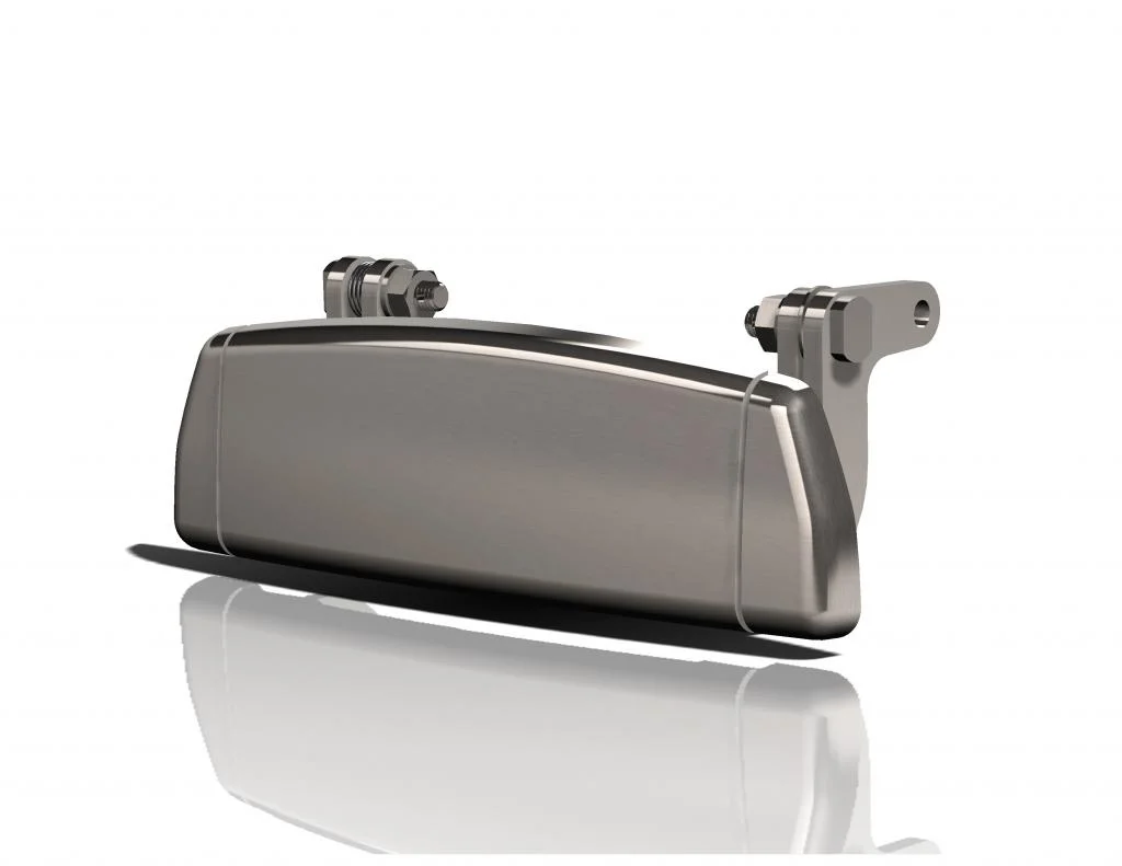

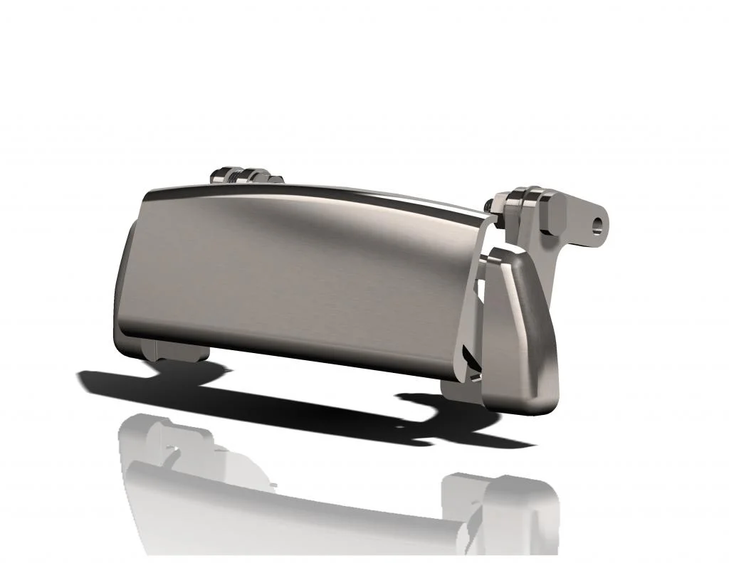

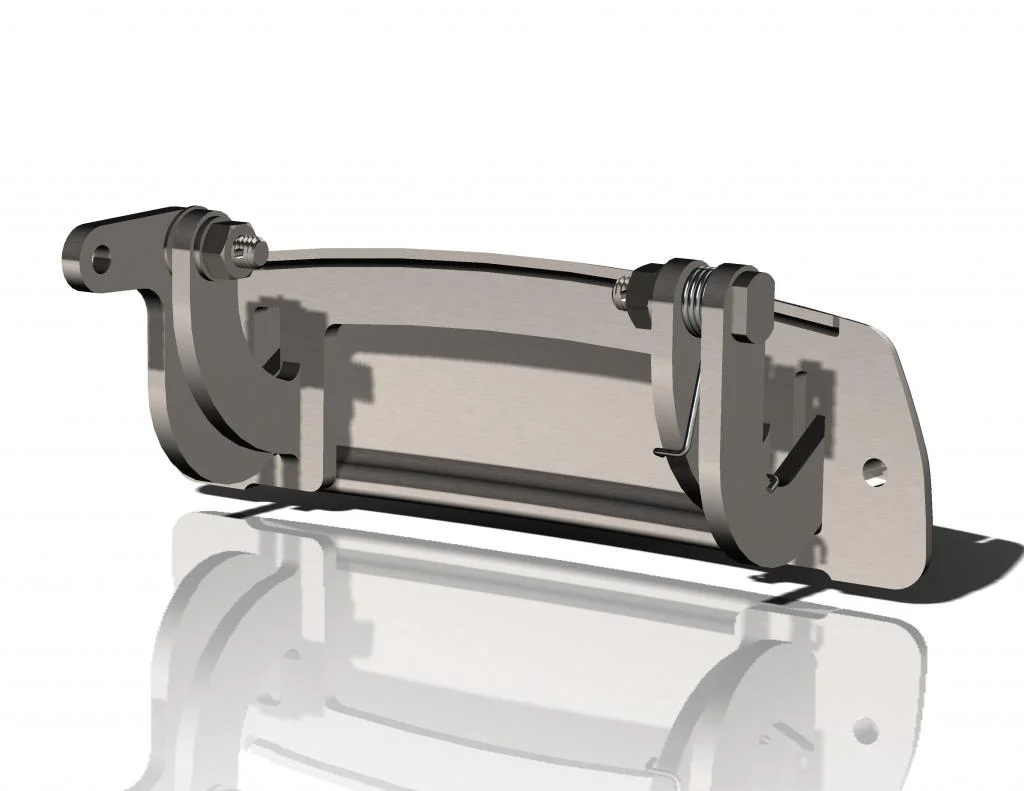

Here are some renderings from the design file:

@DoubleNickels and I started talking about printing the tailgate handle in stainless, how that could polish up into a nice piece. We agreed to start with a plastic prototype that I would test fit on a spare tailgate that I have lying around (thanks Ige @nuclearlemon ) I will go try that now.
View attachment 1661740 View attachment 1661741 View attachment 1661742

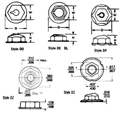

Or better yet print a stud and use a “Thread Cutting Nut/ Emblem Trim Nut/ Washer head thread cutting PAL nut”..
Link, https://www.boltproducts.com/palnut...capped-type-lock-washers-c-463_471_473.html#1
OR, Thread Cutting Nut 5/32 Stud Size
Man, those things do not have a lot of surface area to grab the stud. I am not sure if they would stay tight after repeated use of the handle.
Or do you mean just for the cutting, and then use a regular nut?
I would just use a die to cut thread.
Yes just print the stud on the back side.
Read the link I posted again if you're concerned about these style nuts being usable for the handle.
Palnut® Capped Type Lock Washers

Tinnerman Palnut - Single-Thread Engaging Self-Locking Speed Nuts® provide a dual locking action- an inward thread lock combined with an arched spring lock- ensuring strong and reliable holding power. Made from heat-treated high carbon spring steel, these versatile fasteners:
  • Are engineered for easier handling and faster application.
  • Eliminate the need for lockwashers, spanner washers, or other loose pieces.
  • Are designed to resist loosening from vibration.
  • Will not freeze" to threads or clog with paint.
  • Provide maximum fastening power with minimal installation torque required.
Our Self-Locking Speed Nuts® are available in a wide range of standard and custom variations and work with all major screw types and sizes.

I had read the link. If those are the stamped steel nuts that I am thinking of, I remain skeptical.
But I have been wrong before, I'm sure I will be wrong again!

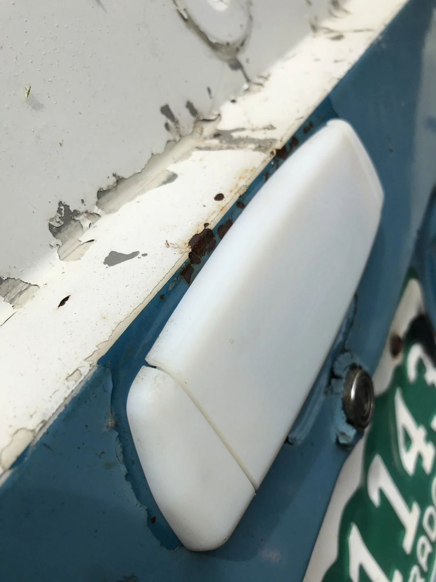

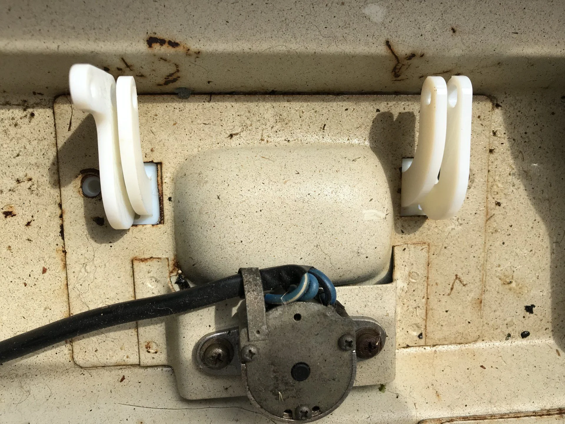

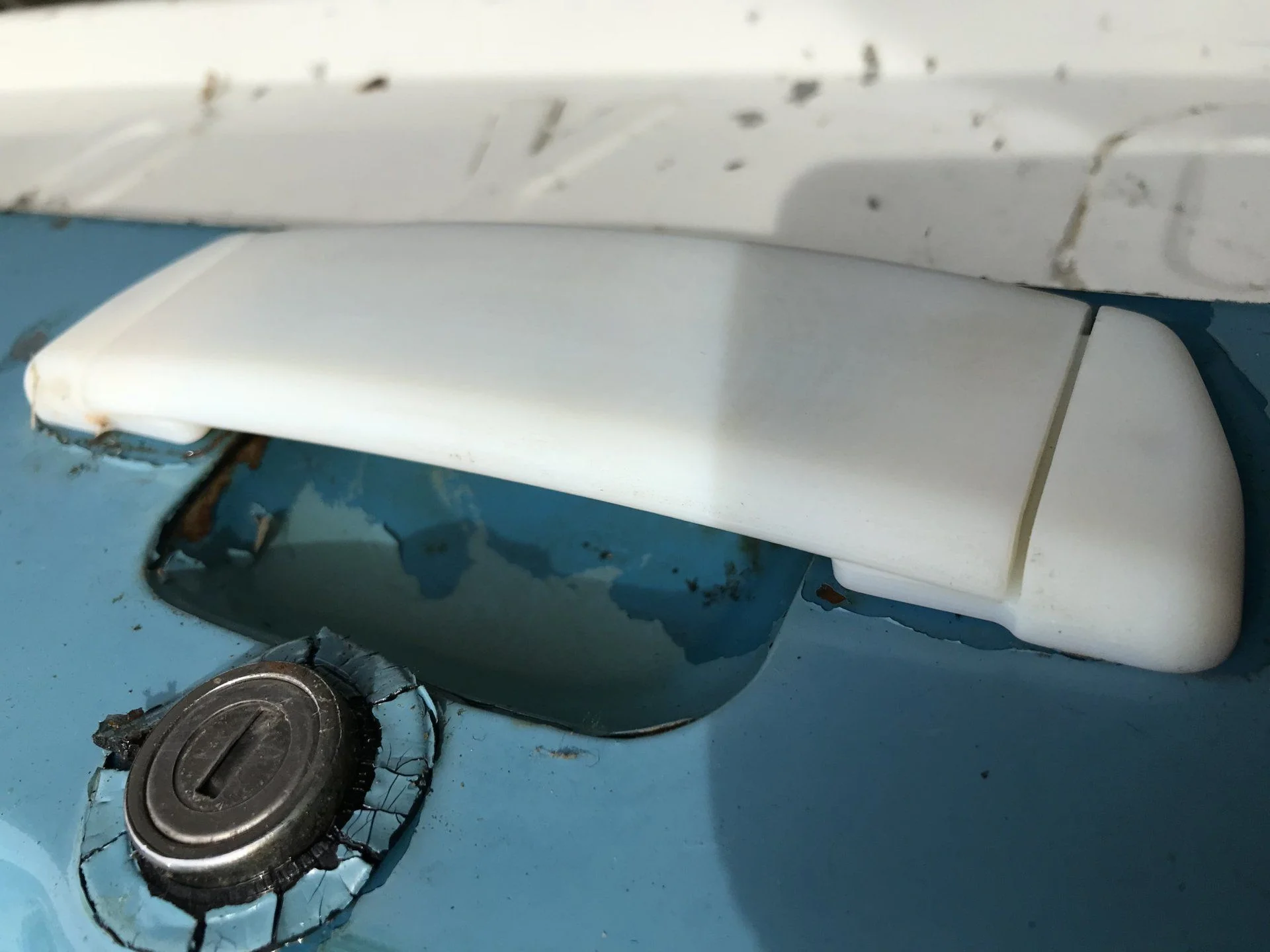

It was fun holding the tailgate up, holding the handle in place, and trying to get useful pictures by myself!
Not sure what year this tailgate is, but maybe it has the smaller openings for a handle with rivets that Ron was talking about.
