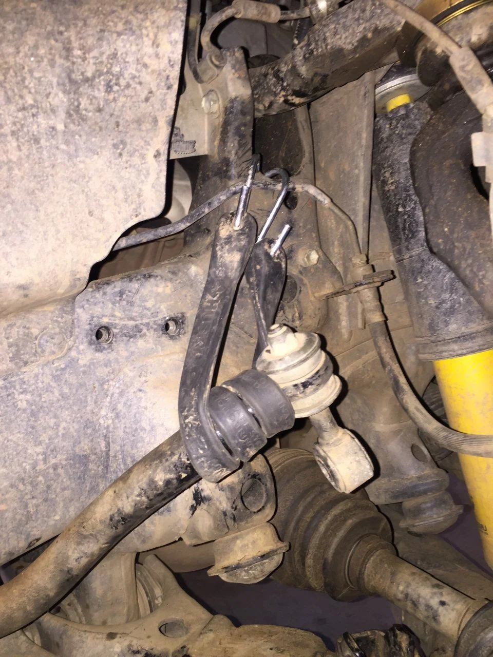

Easy enough to do it by yourself. Here's my solution: Drill out the bolt holding the sway bar and replace with a pin. I believe I used a ⅜" pin. I hold the sway bar up with an S-Hook rubber strap from HD. The only crappy part is reconnecting the sway bar on any road that's not level. All in all, takes about 10 minutes to disconnect and reconnect. Worth it, IMO. LCP offered some excellent info for AHC owners thinking about doing a disconnect lower down on this page
Right on.. Yeah, doesn't look like it'll be too hard to figure something out. Have you had any problems with your CV's over-extending due to the extra articulation in the front? Didn't even think of that until Staggrlee mentioned it might be something to consider.

Honestly, the increased articulation is nothing to write home about. It's not enough that the CV's give me worry. I did it mostly for smoothing out the front end while off-road, not for more travel.
