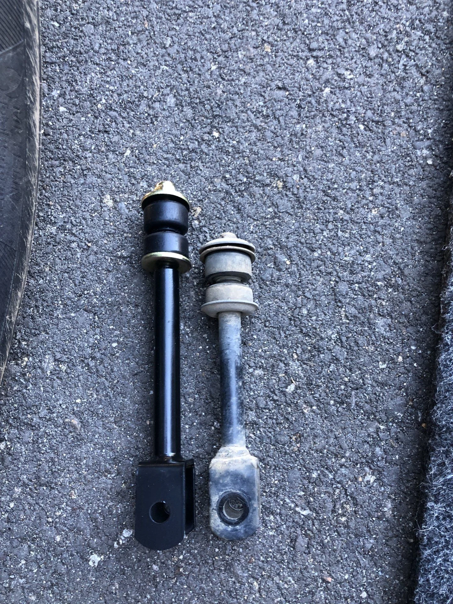

Phil nailed it here. The IFS extended links put the sway bar back to the factory parameters that Toyota designed them to after a lift has been installed. Handling is improved on and off-road. The front extended links do very little for articulation on the IFS fronts. This is a handling modification only IMO.
I could feel the difference immediately after swapping the front links, in reference to tighter handling and less roll.

The links (front or rear) correct the sway bar geometry after a lift is installed. Only time ride quality changes is in rolling and windy terrains. The lift changes the angle of the bar and if not corrected the vehicle will encounter more body roll before the sway bar reacts to the movement and functions as designed. Most that drive in a normal city environment of straight driving from stop light to stop light or driving down a highway will NOT really notice the correction. Unless changing lanes as fast and hard as possible is your driving style.
Now take someone that lives/drives in a windy road area or hit trails regularly and they will feel the difference as it has put the bar back into a better geometry and functions like Toyota designed it to. Restricting roll sooner since it is corrected. RTT, loaded rack owners notice it quickly as well.
Several sway bar mfg companies have confirmed. When the link and bar are at as close to 90 degrees the reaction/response is optimal. So when you raise the rig the bar angle is changed and needs to be pushed back to the OEM geometry for it to react quickly to body roll on windy roads or top heavy rigs as originally deigned without a lift.... This has been done on rear AND fronts for decades whether for a lift on offroad rigs or the links are shortened for sports cars when dropped lower for speed and cornering enhancement.

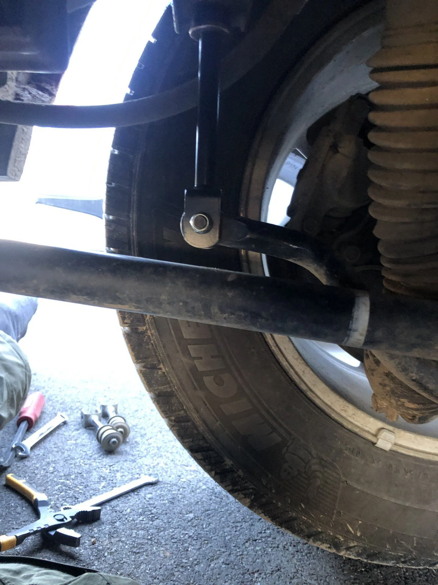

I'm the latter person with windy highways. Ordered your extended links for front and rear. I'll give it a shot. Thanks!
Apologies for the continued thread jack. The @trailtaylor rear links are installed. My write-up would just repeat the (positive) effect observed in the tlc link above. The more I drove the more I was sure I wasn't just imagining a more progressive roll-in vice the flop before. Thanks!
