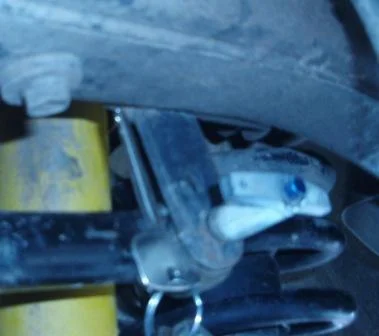

I'm using these on the front. Mine are the "T" handle double ball locking type & say PN MS17985C613 on them but I can't find them on their site.
https://www.avibank.com/index.cfm?fuseaction=home.hotlist

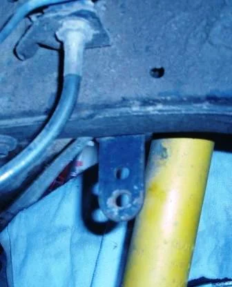

I also welded a tab with a hole dirlled in it to the frame just above the axle mounts so i can just pull the pins, swing it up and pin it up out of the way. These pins are strong. I've flexed numerous times without pulling the pins and they are still straight as new. Running on the same set over 4 years now.

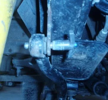

A quick search revealed two pics of the sway bar pinned out of the way (after disconnected) https://forum.ih8mud.com/80-series-tech/22921-front-sway-bar-disconnect.html
I did the same thing and it works out well. However, in my case, I'm connecting the sway bar directly to the frame holder w/o the intermediate short piece as shown in the pic. Credit goes to LandcruiserPhil.
Here's a pic of my QD up front:

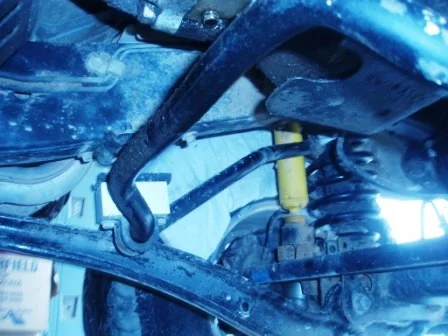

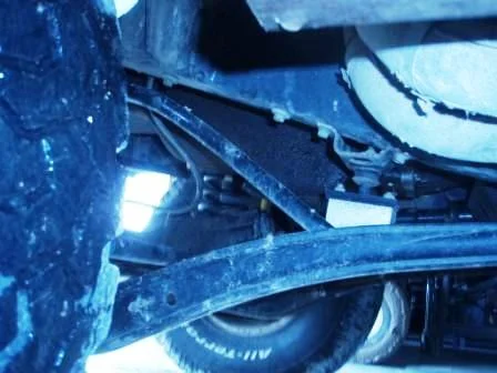

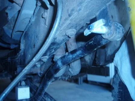

finally got some pics of mine.I'd have to blame my tardines on rain, darkness, & memory (not all at the same time).
more:
and one with a cruiser key for size reference:
