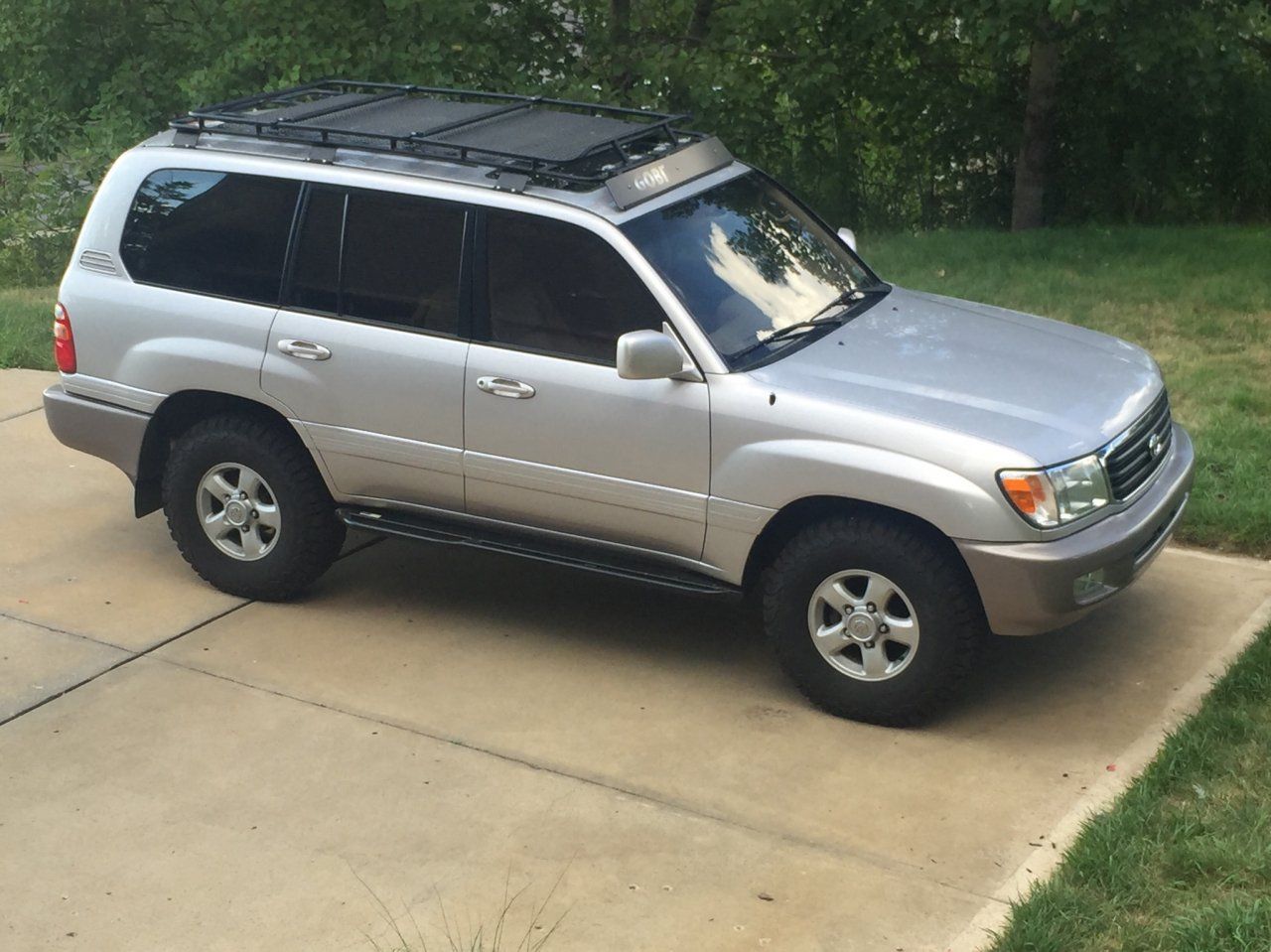

Installed my Metal Tech Sliders- I had been waiting for months to get availability of them and they finally had a set come available from an order that didn't get paid for. Lucky me. They aren't making them regularly for the 100 anymore, and I think they are going to be redesigned. So these might have been the last ones of the current design.
Finally got around to installing my rear coil springs and finishing my lift. Ironman Toy13B (0-200kg additional weight). They were approximately the same length as the factory springs but- they sure didn't let the back end compress much. No doubt they yield at bit over 2" of lift, since I couldn't get out of my garage- lol- I had to remove my rhino cross bars from the factory rails, and even then I only had a few mm of clearance.
While underneath there, I also replaced the sway bar links with Mana-Fee extended 80 series links, and replaced the sway bar bushings as well. It was all going well until one of the bolts holding the bushing brakes froze, and then snapped. That took another 30min to drill that out and clean up the threads. Back end sure handles differently with new springs & sway bushes.
Picked up some Metaltech upper & lower links, and a whitline adjustable pan hard while they were on sale, and waiting to install next time I have a day to spend crawling under the truck. Ready for rear bumper & drawers to settle that back end down.

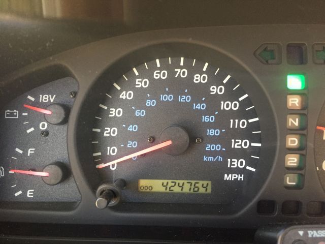

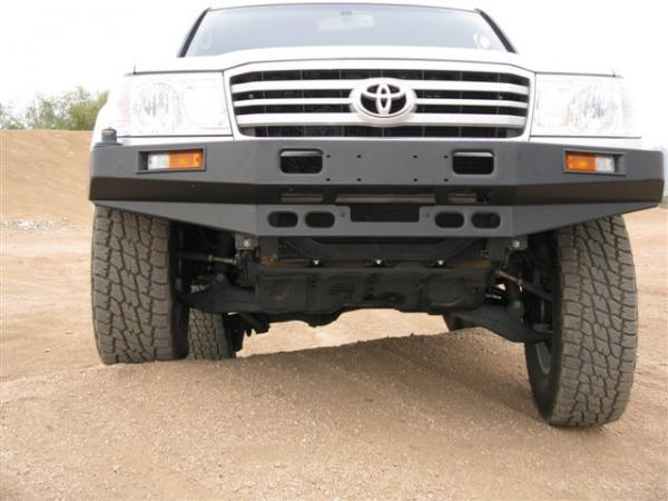

Guys with larger tires and stock t-bars need to be aware/careful with swaybars disconnected if you are able to achieve full travel. Bump stop adjustment may be needed to avoid tire fender issues.
AHC in Net. setting with sway bars connected
