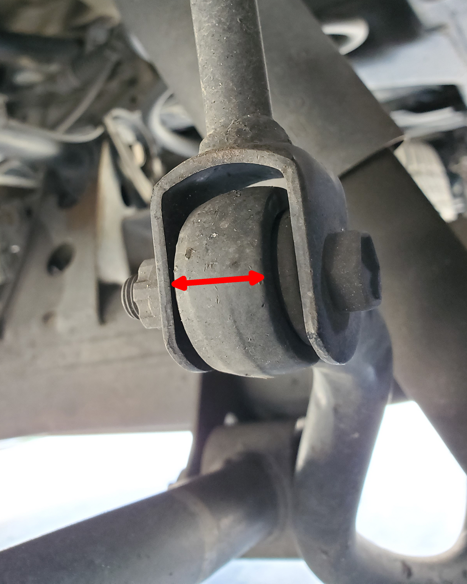

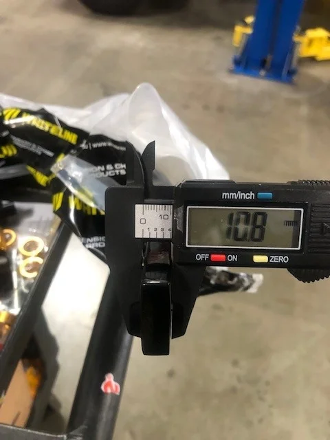

The end of the stock LX bar is rounded and pretty thick - 18 mm. Are the aftermarket bars also this thick, and if not, is that going to cause a problem? Wouldn't they be too loose in the stock end links?
Youre correct, aftermarket bars are not that thick.. and the endlinks are too wide... I use washer to fill in the gap.
