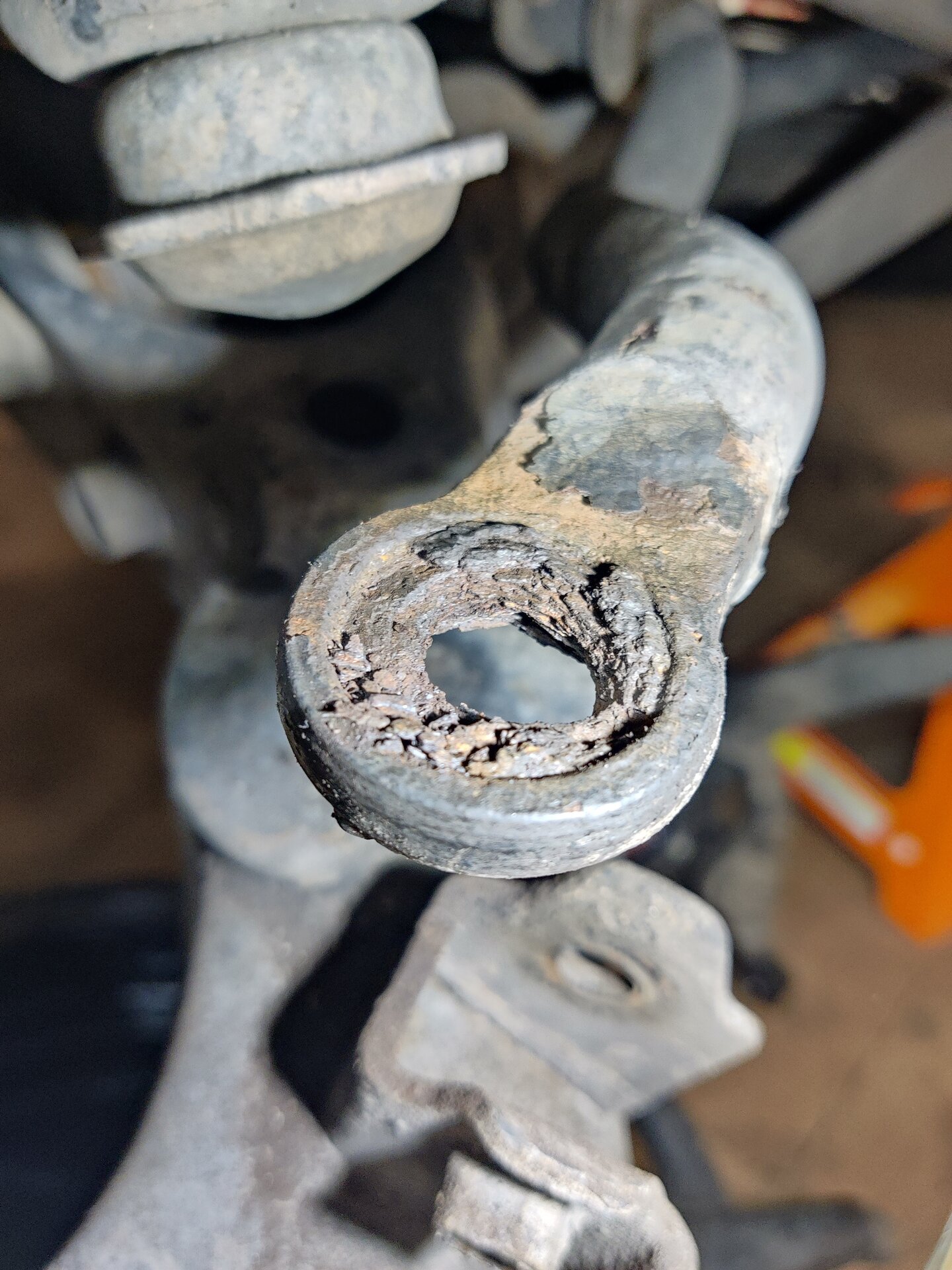

Great timing on this discussion...I'm in the middle of a brake job / front hub rebuild and I was going to put on new end links and sway bar bracket bushings but this evening I found a ton of bad corrosion on the end of the sway bar. I'm thinking let's replace the sway bar while I'm in there.
I don't do any aggressive off-roading but I do a lot of daily and long distance driving and want to tune for comfort and on-road handling. 3 simple options:
1. LX OEM bar - ~$150
2. LC OEM bar (1mm larger?) - ~$150
3. Superpro front bar - $319 size unknown
Would the Superpro bar be too aggressive, would I sacrifice some comfort during daily driving and highway cruising?
Would the LC bar be a noticeable improvement?
Thanks in advance for your input!

My experience is that the LC sway bar, even with new bushings/end links, was NOT a sufficient difference. Despite a very well-working AHC, I wish I had gone fatter for less body roll.
