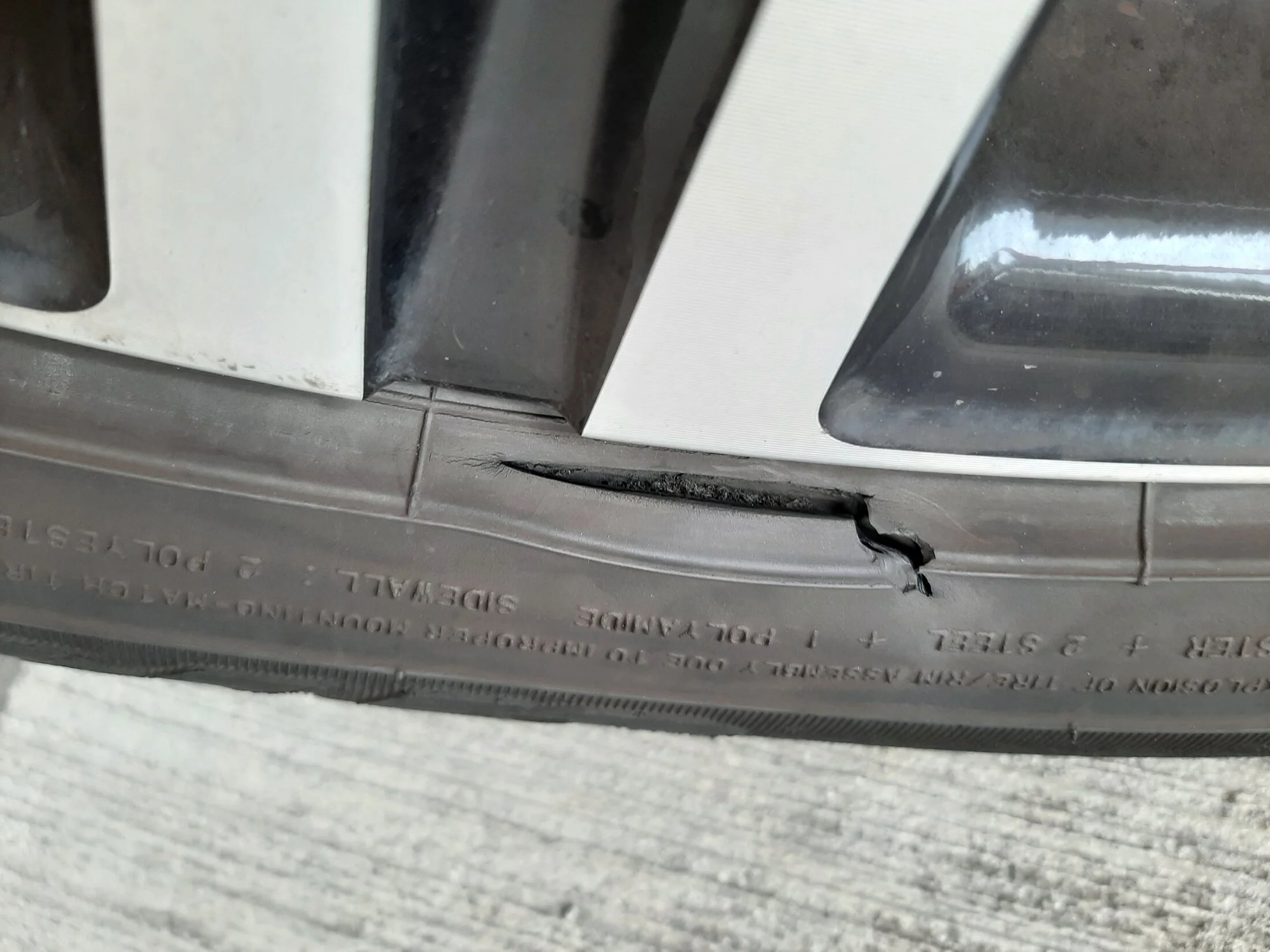

So I noticed this small crack on the pax front, seperating the sidewall from the tire. Don't know what the previous owner did to cause this, or maybe even the tire shop that pulled the winters off to put this all-season set on.

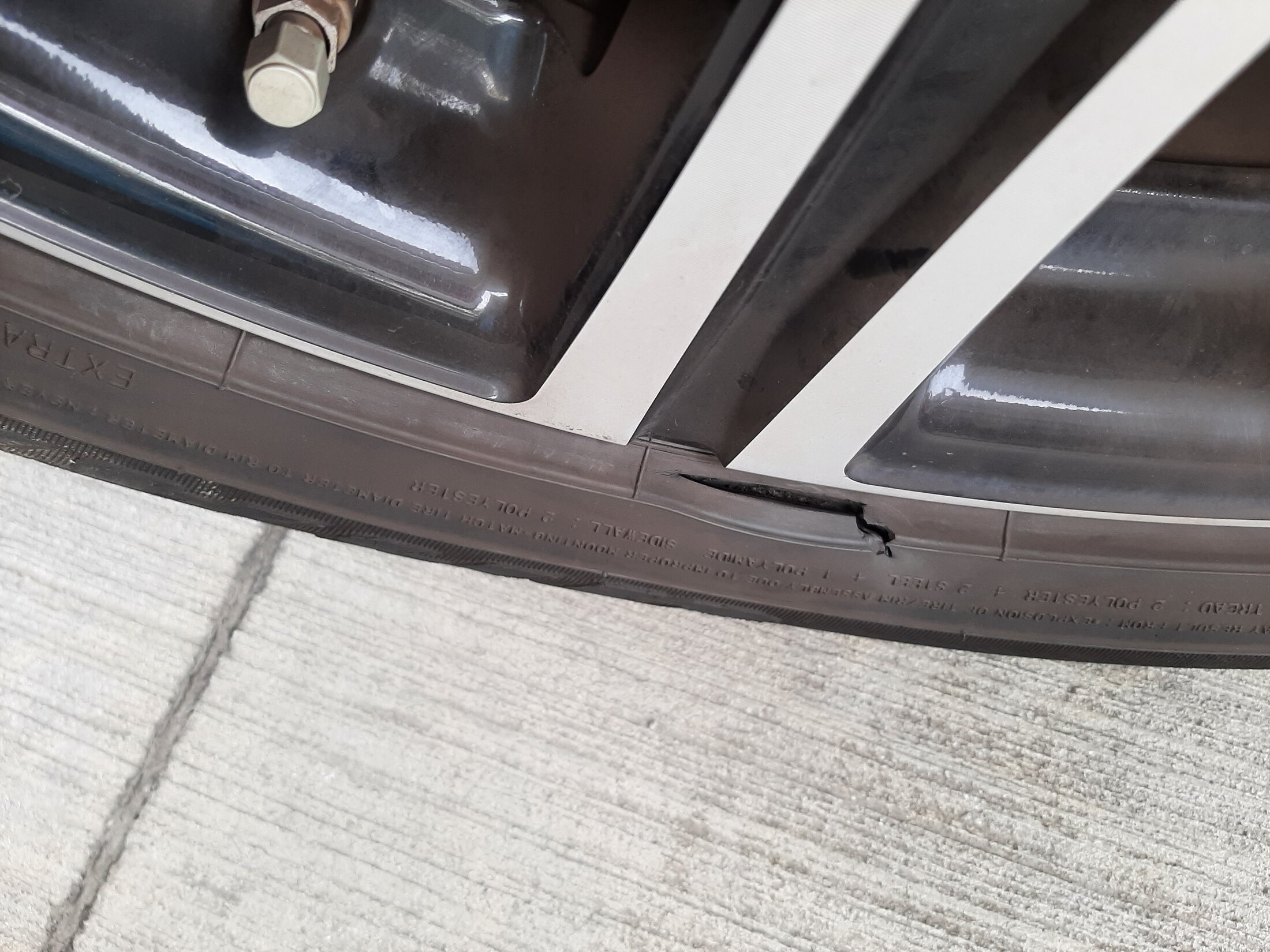

This better image shows the scale of the crack relative to the valve stem:

I'll just use the spare. Although sidewall separation is not so unheard of, and some people drive like that for years, I would not play roulette with such a heavy vehicle and so little sidewall with 21", especially with an owner that drives hard.
Are you going to use the damaged one as the spare? I would rather buy a new tire instead.
Please don’t ever use that tire again, for your sake as well as others.

So I noticed this small crack on the pax front, seperating the sidewall from the tire. Don't know what the previous owner did to cause this, or maybe even the tire shop that pulled the winters off to put this all-season set on.View attachment 3923407
This better image shows the scale of the crack relative to the valve stem: View attachment 3923408 I know I am asking on Ih8mud, but other than "throwing these stoopid 21' set away and putting on some proper 35 in. M/Ts with a 10 foot lift", can I throw in the spare tire which looks to be brand new and never rotated before by the previous owner 😤, or will this destroy the full-time 4WD system? Or, should I put this defective tire on the rear axle, where a blow-out would be presumably less catastrophic (btw, I have driven on these tires HARD for about 3k kilometres before noticing this today). I would say the other tires have about 70% of tread life remaining.

I would not use that damaged tire for anything, not even a spare. It is a dangerously damaged sidewall and is not repairable.
