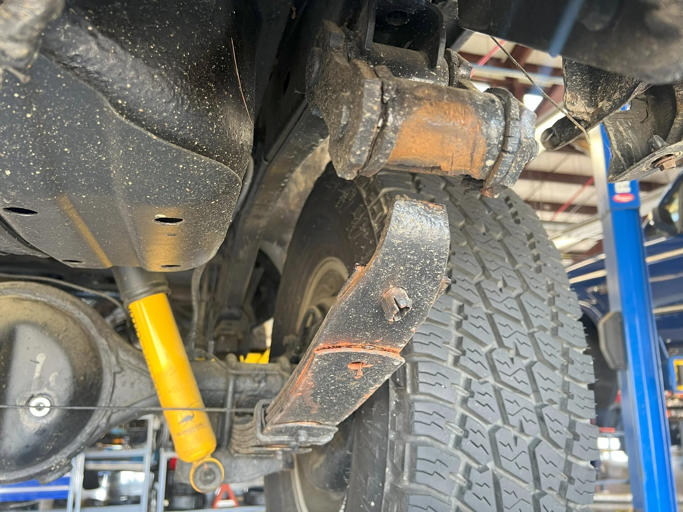

Good morning all,
I have a '91 HZJ73 and recently one of the rear (original?) leaf springs broke. Regardless of how or why, I'm not exploring my options and am looking for some guidance/opinions for replacing some/all of the suspension.
Being a 73, it has leaf springs all around. Please let me know if these full replacement options seem correct or totally out to lunch. I plan to do the work myself to get it all installed as I have access to a shop (VA/USA). I'm also considering just redoing components on the rear but again, I assume if you want it done "right," do the entire thing.
