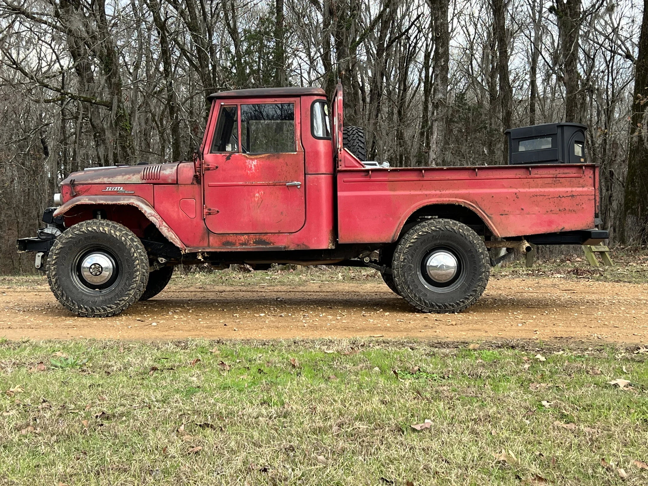

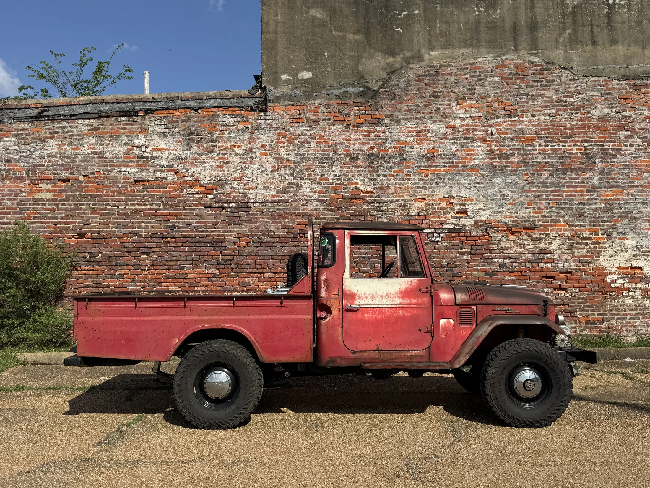

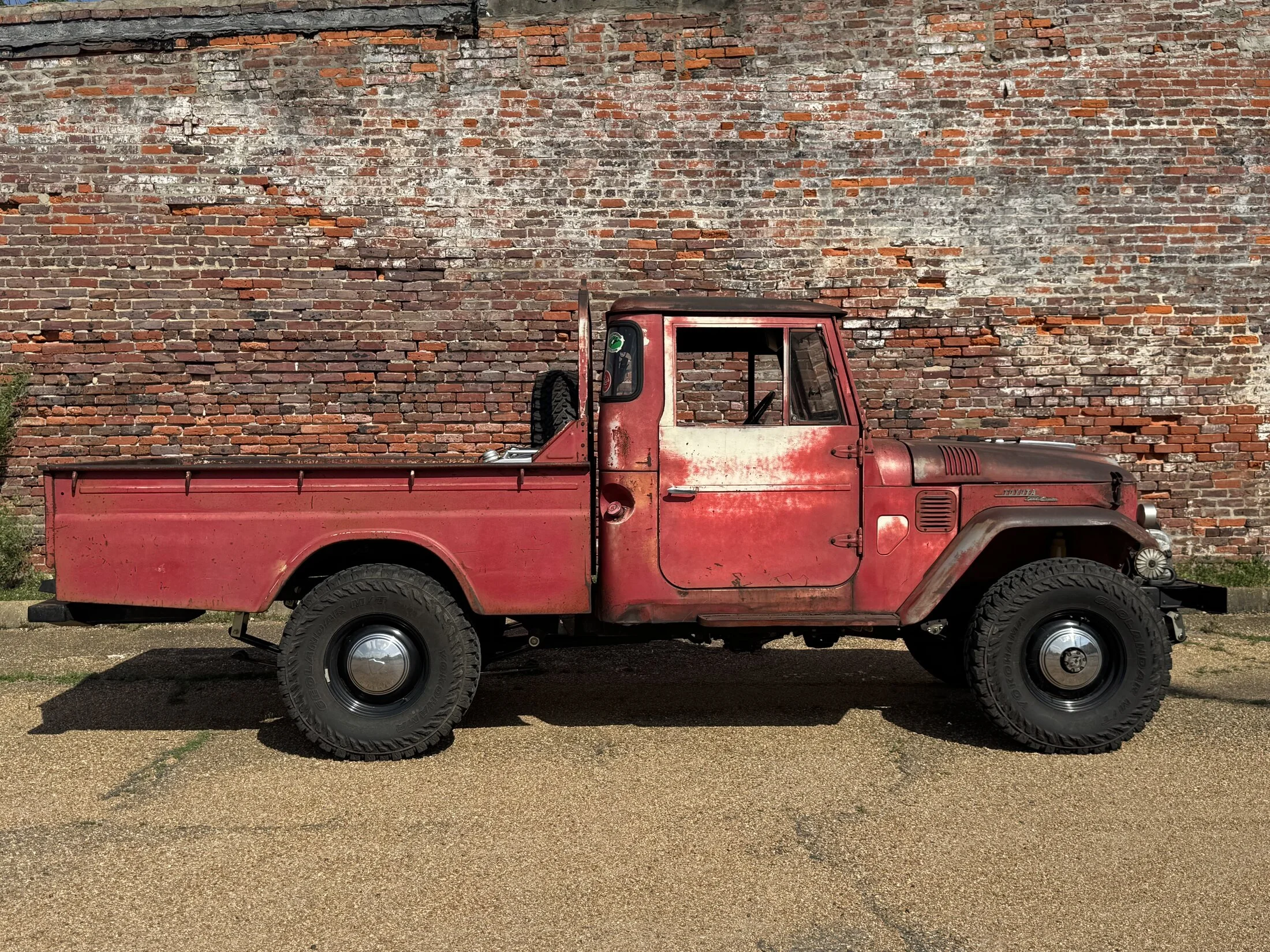

Test Bed - The Goat 45 .... my 1967 FJ45 pickup. Arguably the worst riding Land Cruisers on the planet. These trucks are too light in the rear and, unless loaded, generally buck and kick around like any worthy one ton truck should.

I have been happy with the stance on this truck but have always been dissatisfied with the ride. Amazingly, I have been able to build quite a few FJ45s over the years using the Dobinsons IMS so I knew there was an upside to my setup.

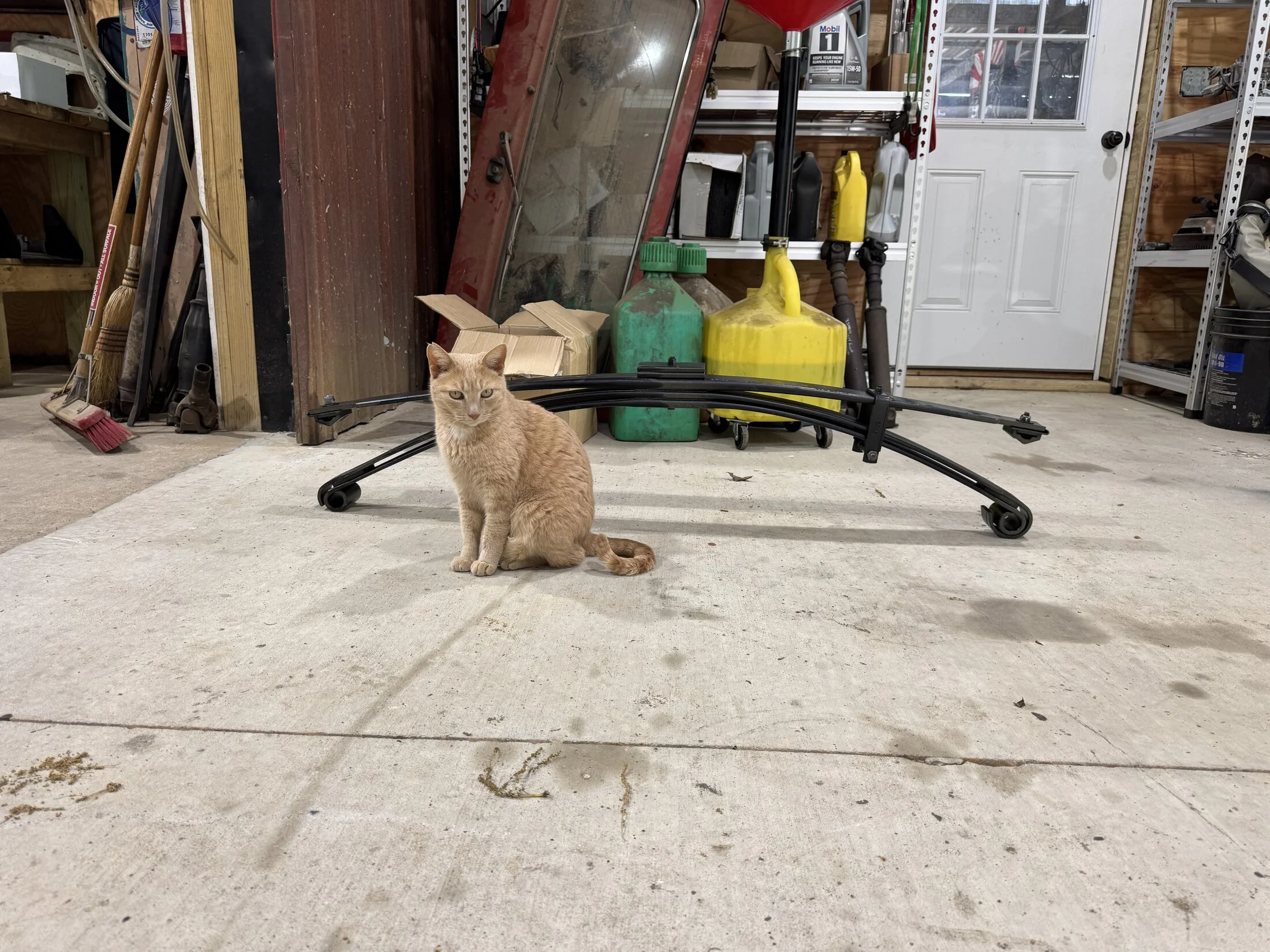

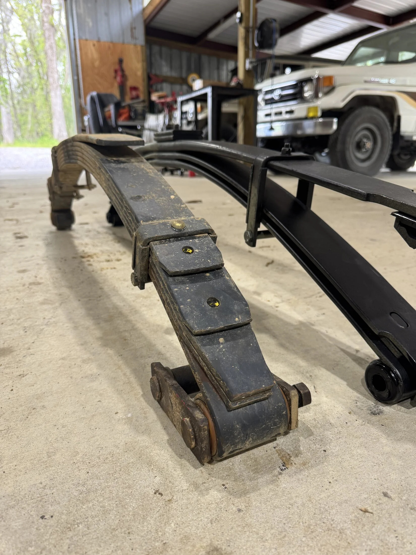

These things look so incredibly strange. That's the first thought that came out of my mind. Cowboy was not impressed.

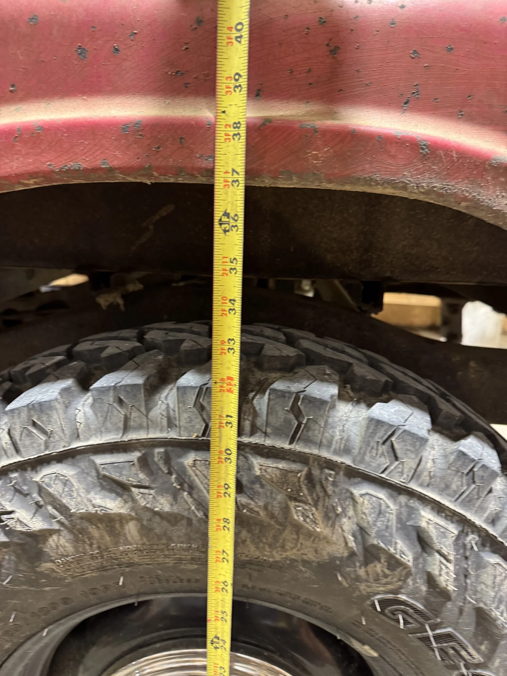

I caught a break between customer trucks and decided to make this swap happen. First, get the measurements on my current setup.
Pretty much dead level which is great for ride and looks but I can say, I really took away the load capacity when I removed the rear leafs. Of course with those in it would have been completely unbearable to drive

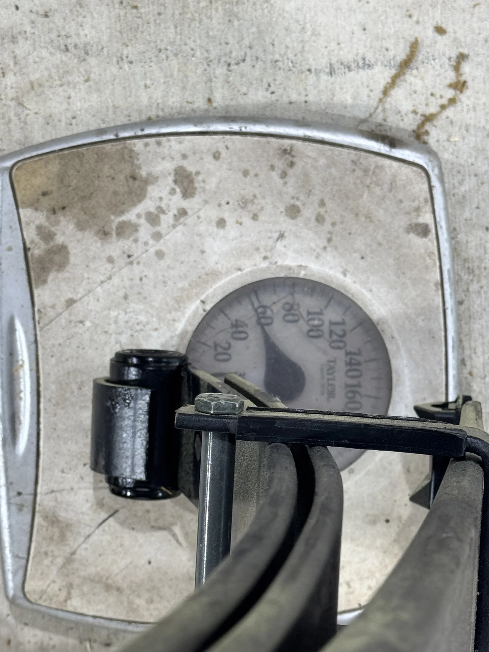

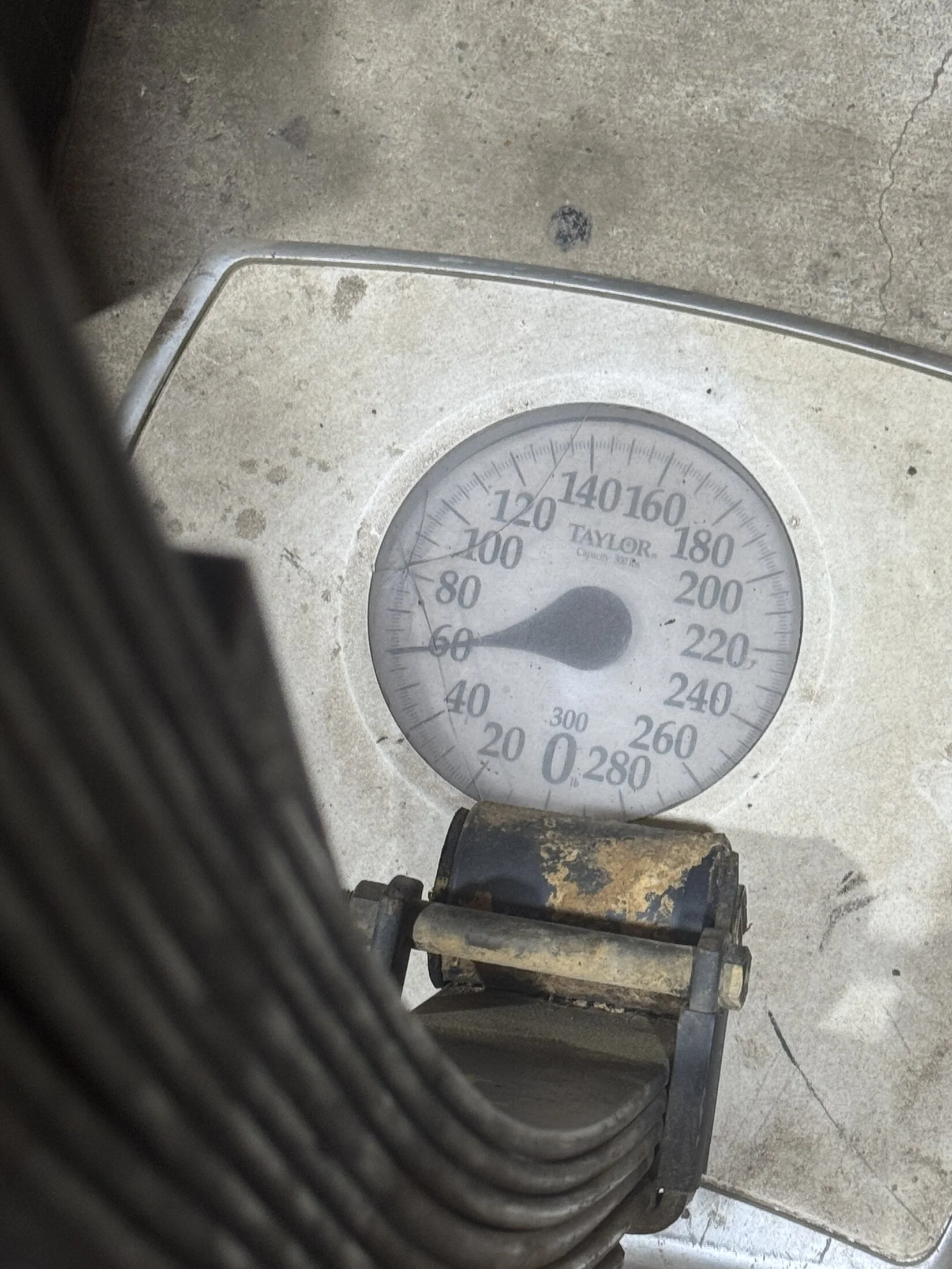

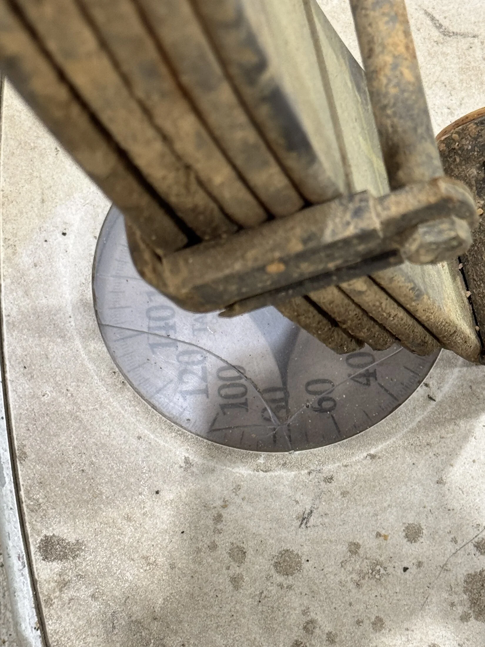

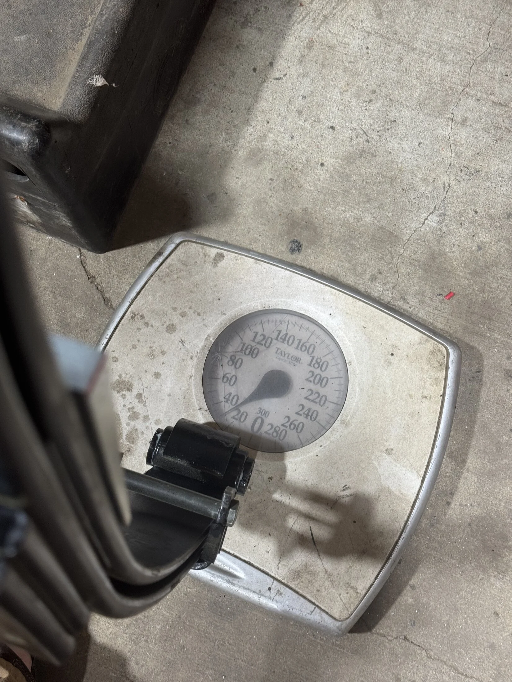

I think I remember before I stripped the rear ARB springs each pack was about 95#. These with 3 leafs out weighed in at 75# each
The goofy Parabolics onmy weigh 56# each. Not light but way less than the OME

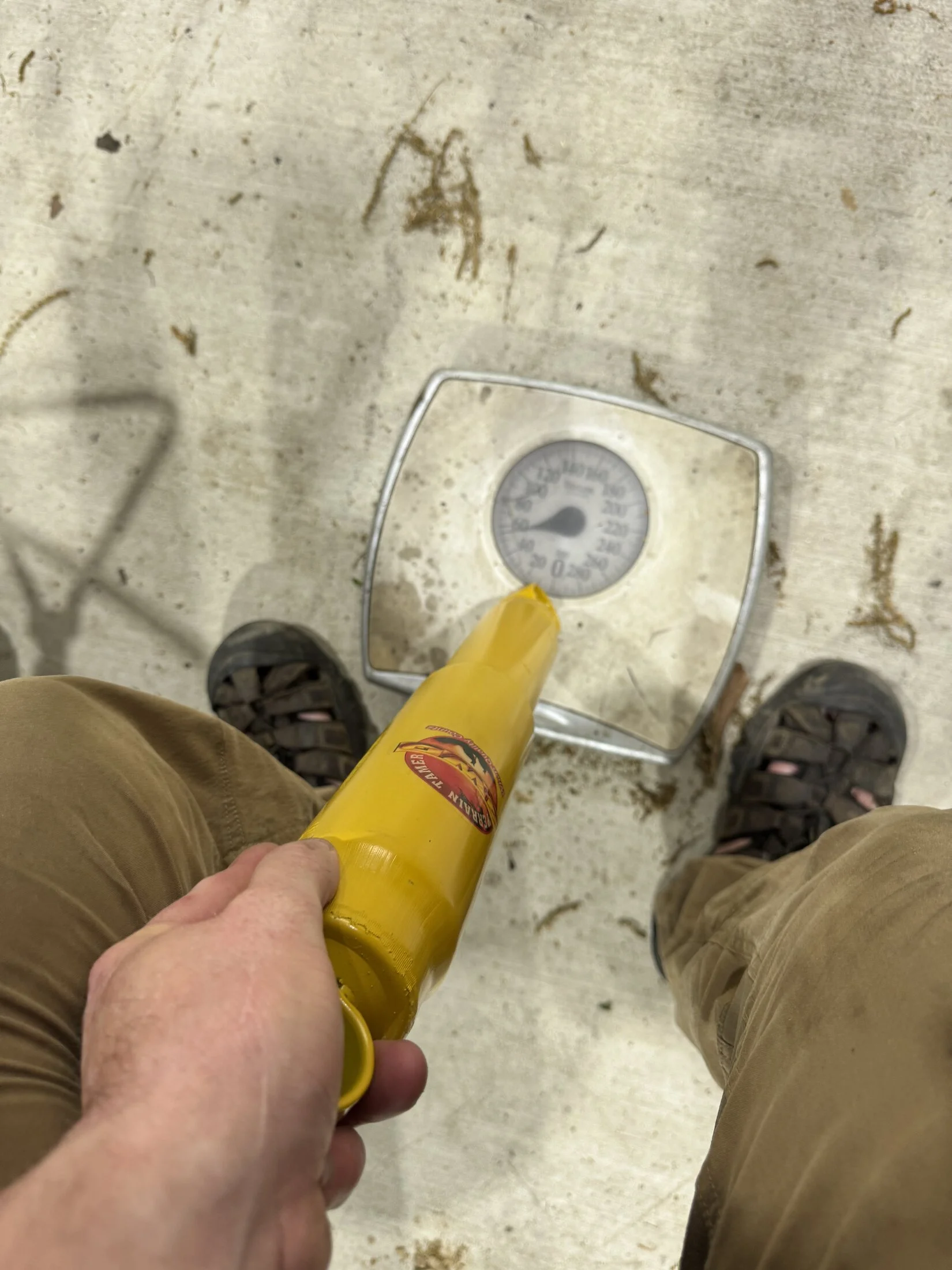

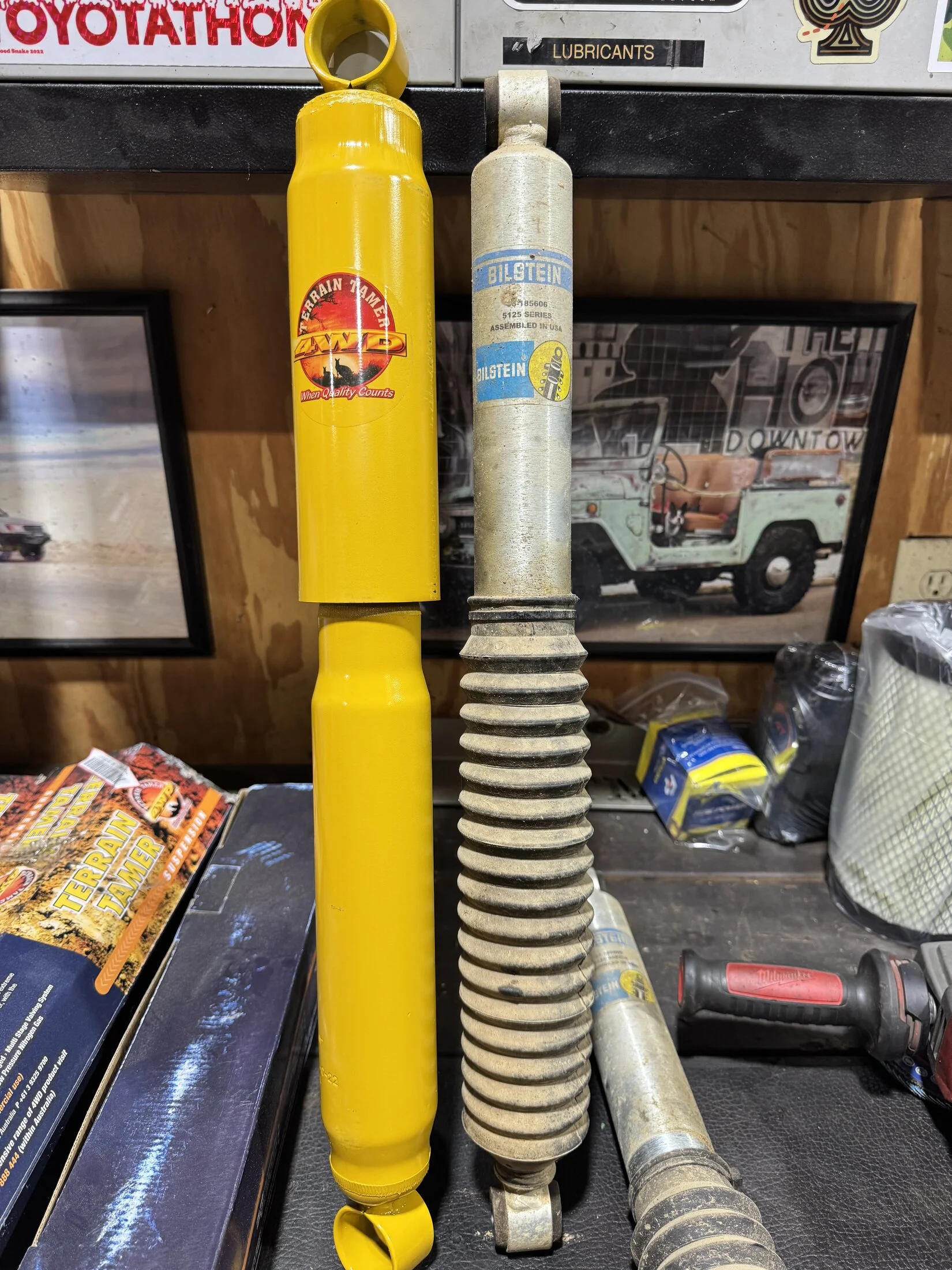

Next suprise to me was the standard grade "yellow" Terrain Tamer shocks. I was fully expecting them to be lame like the standard OME and Dobinsons "yellow" shocks.
I was therefore pleasantly surprised when I pulled the bands off them and they actually self expanded.
Also, these things are massive. Not quite Dobinsons IMS massive but almost.

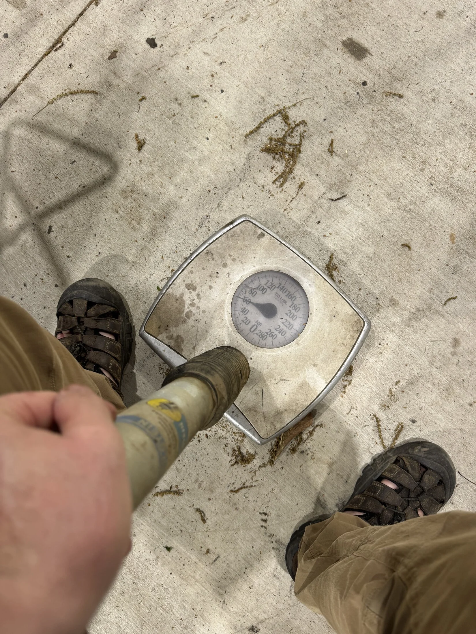

Testing them against the much loved Bilstein most people "upgrade" to over OME yellows, they are very comparable on the compression as my high tech bathroom scale goes.
That said, with shocks, there is no replacement for displacement. I would expect the larger terrain tamers to stay cooler longer. My biggest complaint using Bilstein over the years has been how fast they fade out off road.

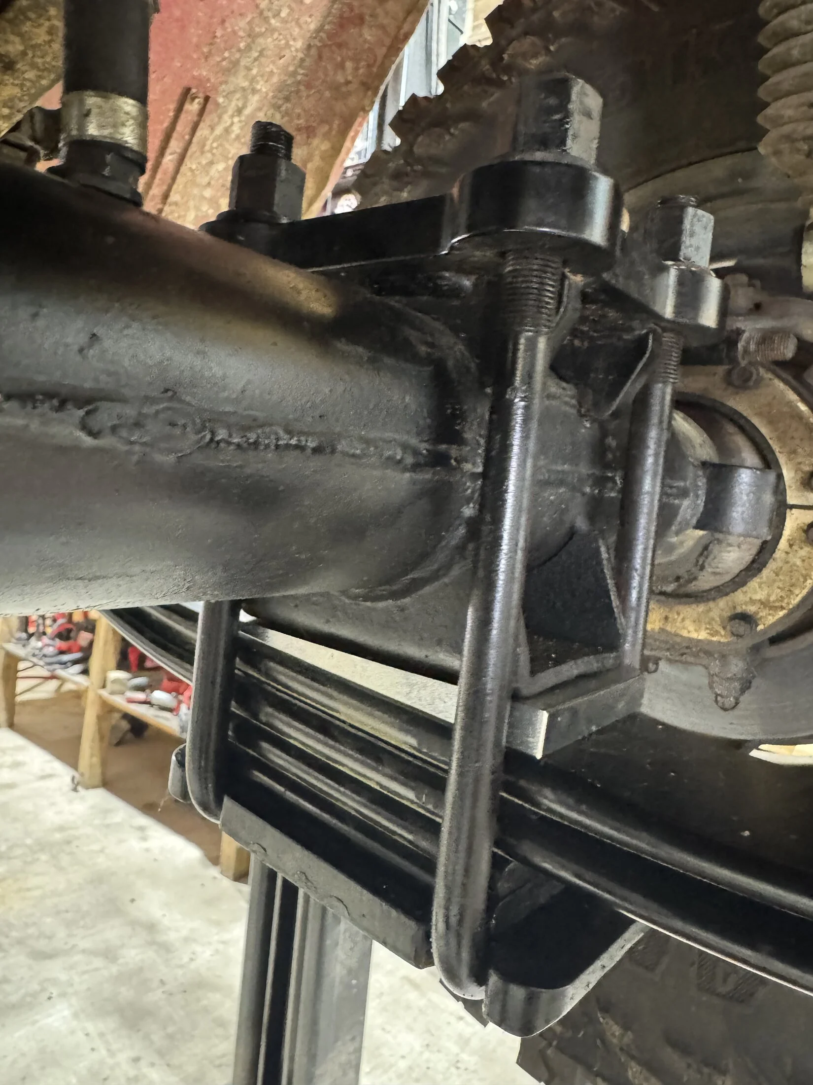

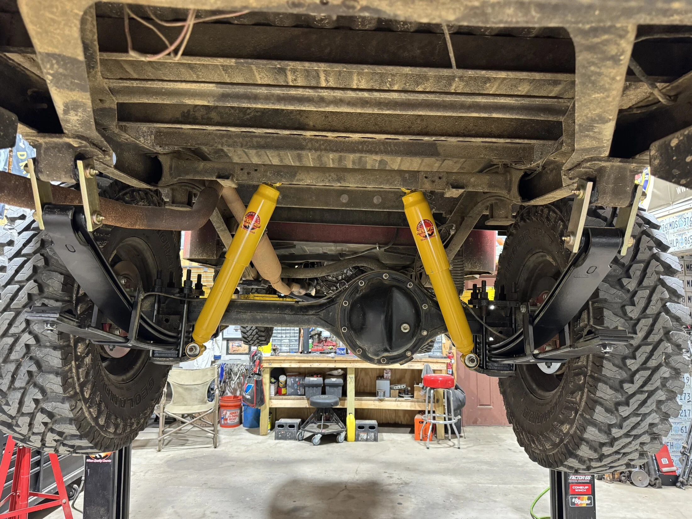

One thing I found hard in the rear install. I have a method where I use my rolling cart to jack the heavy ass spring up to the fixed hanger.
The huge overlaid spring was hitting the arm on my lift so I had to install on the shackle end and swing them forward.
When you work solo you come up with these things. Just an observation.

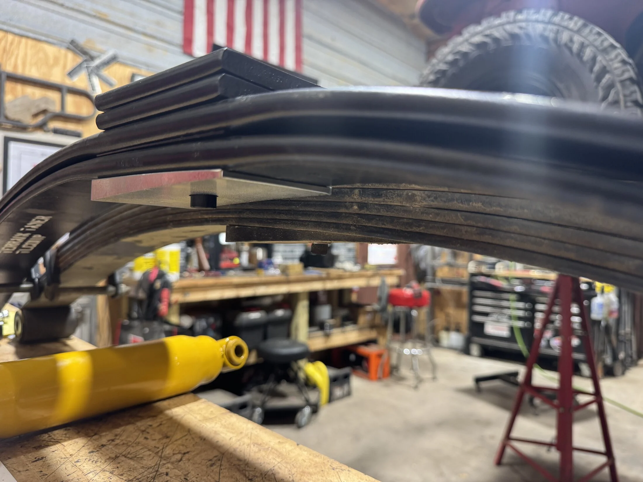

First things first, add some 4* shims via Valley Hybrids to the front pack.

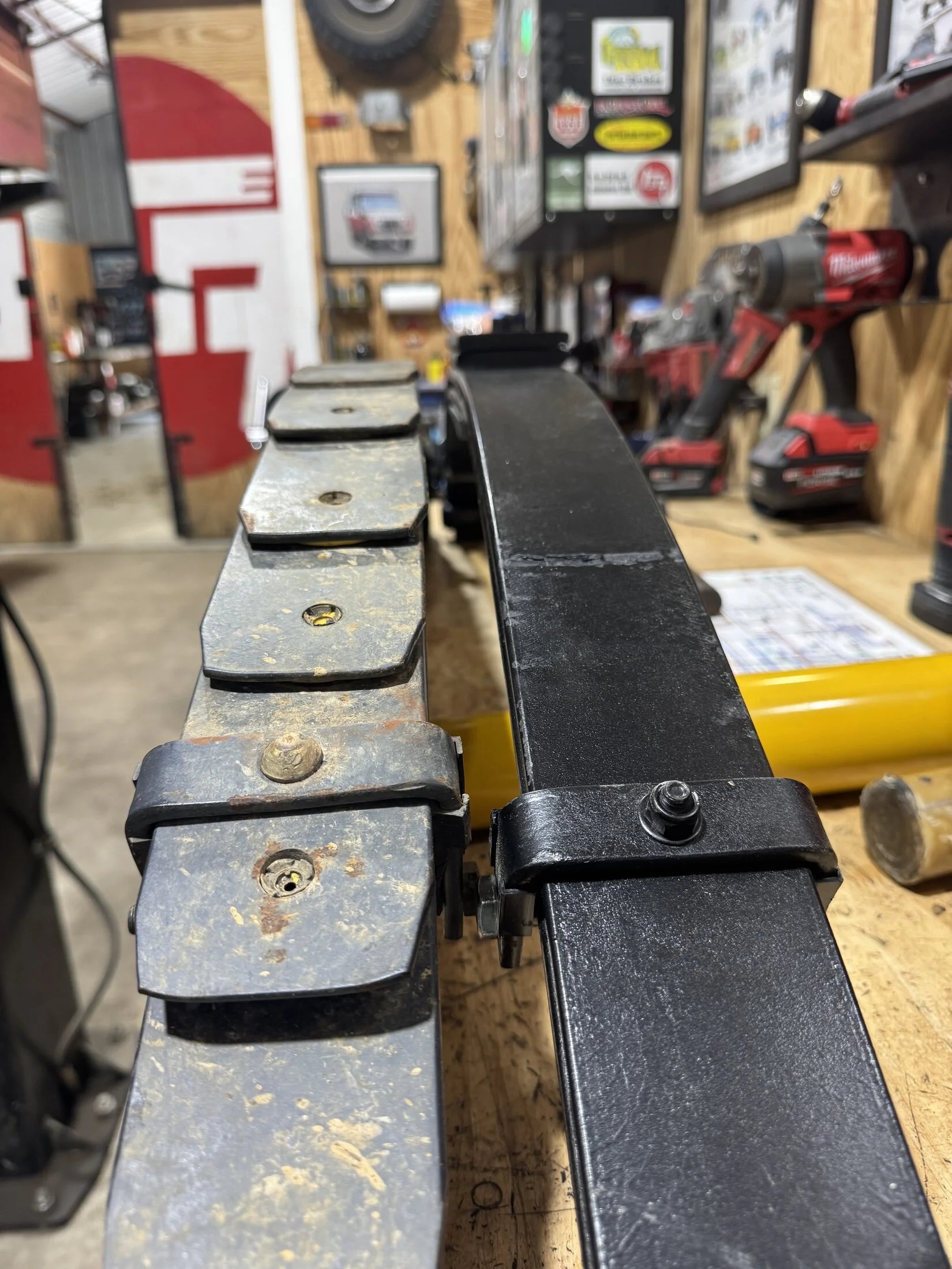

The extra small leaves on these packs are used to take up the same physical space in the Ubolt as a standard multi leaf pack. I doubt they play any part in the action of the spring at all.
One other feature. The other two leafs don't touch. They have isolators between them to reduce friction.
The front springs are really crazy light compared to OME - 60#
Versus only 30#
I'm running a @lcwizard flip kit but looking at the ubolts provided they are just standard stuff. Same as the others.

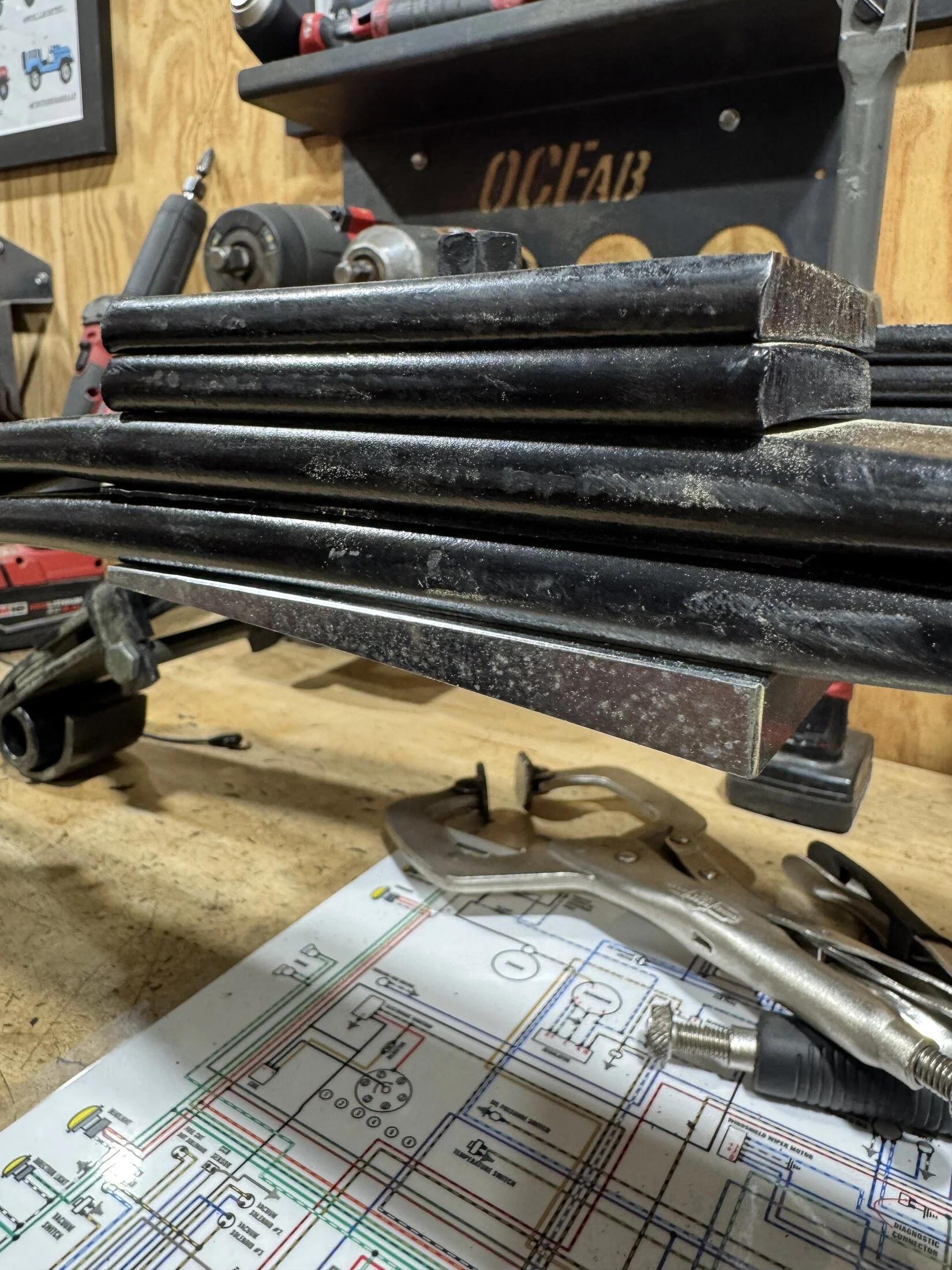

Side by Side the difference in design is stark
I like how the parabolics are nice and flat where the caster shim goes. All other brands they are curved there and you have to really tighten the crap out of the center bolts.
Bonus, the Terrain Tamer center bolts were long enough to be reused with the 4* shims
Took me about 3 hours to button up the front and take it for a spin.
As you can see the truck sits pretty level. It's about the same as my pre lift numbers.
Impressions.
This setup is noticeably better than the OME setup. I honestly did not really expect that much difference seeing these light rear 45s all pretty much ride harsh.
I was hoping to get it to the Dobinsons IMS level of comfort at least so I'm happy to say these springs actually feel a good bit smoother than even those.
Potholes are not jarring. Seams in the road are not felt in your spine at all. Corners are great.
Overall I'll say I'm 100% happy I upgraded.
I don't think I would change out a Dobinsons IMS setup for this setup but I would advise new buyers to strongly consider the Parabolics over traditional leafs for an FJ45.
