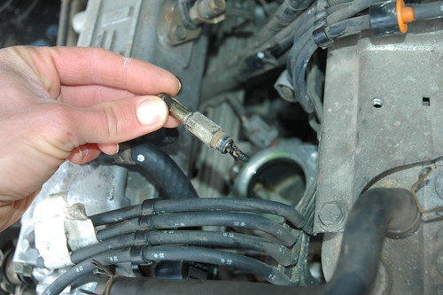

    figured out the fix for my truck
    Not that anyone has read this post since my last reply, but it could help a frustrated 22re owner trying to find an answer.
    My idle was loping as described by many on different sites. The tape over the hole in the throttle body worked, but is not a permanent solution.
    I removed the AAV, soaked it in cleaner, blew out the passages with compressed air put the AAV back on. No luck.
    I thought the AAV was bad, so I bought a new one. I got a decent deal on one via Amazon.com. It was about 50% less expensive than from the dealer.
    However, the new AAV didn't solve the problem. That made me think the problem has to be somewhere else in the AAV system. Early on I remember thinking the upper hose that comes from near the thermostat was awfully cold when it should be warm. After the new AAV didn't solve the problem, I started investigating there.
    I took off the hose and poked a small spray straw (like the one you get with WD-40 or throttle body cleaner). The straw didn't go in very far and I thought it was odd.
    I didn't get around to doing anything until today, when I replaced the thermostat, thinking it was bad and possibly affecting the situation. It would also get me another look at that port that leads to the AAV.
    Sure enough - I had a major blockage.
    [​IMG]
    (more pictures and sizes)
    Stuck in the port, or whatever you want to call it, is some sort of soft rubber gasket-like material. And I have no idea what it's doing there or how it got there! I can only imagine it has been there for some time.
    I removed the offending material, cleaned everything up, reassembled and everything runs perfectly now.
    I'm curious if BeaterToyota had a similar blockage:
    If it is anything like what I found, it would have been nice if they'd given more information!!! Hopefully this will help someone possibly in the future if they have the loping idle problem and has already ruled other things out.
    If so, or even regardless, it is always nice when people share more specific information. If BeaterToyota ever reads this, I am curious if their blockage was the same place and similar material.
    For those with this problem: Your first step is to cover that hole in the throttle body. If that "fixes" the problem - the solution is not any TPS issues, or vacuum leaks, or snipping wires as a bunch of wingnuts on other forums have suggested. If covering the hole changes things, it should be obvious that either the AAV is bad, or something in the AAV system is not functioning properly.
    Steve

    Many thanks Sogwo - I had the exact same symptoms (idle surging once the engine was warm) and just as you found, the fitting on the thermostat housing that goes to the throttle body was clogged. Cleaning it out with a metal rod fixed the idle problem. You saved me a lot of work and I appreciate your description and photos! -K
