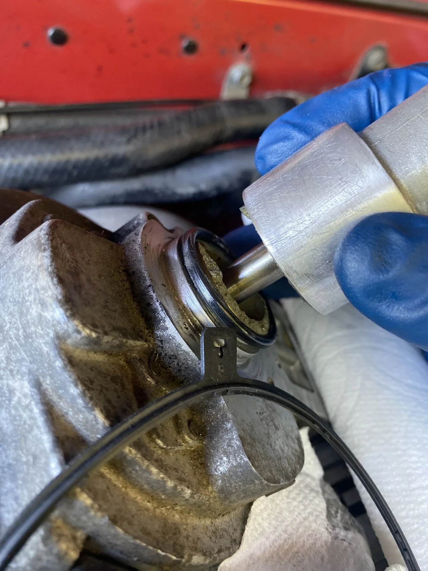

I am due for a replacement distributor due to the pic I will share here but could replacing this be the answer to my problems I'm describing? I know for a fact it is either way past its replacement date or entirely aftermarket meaning I have no reason to think it works well other than the fact that it totally worked before and after the rebuild in its current state.
