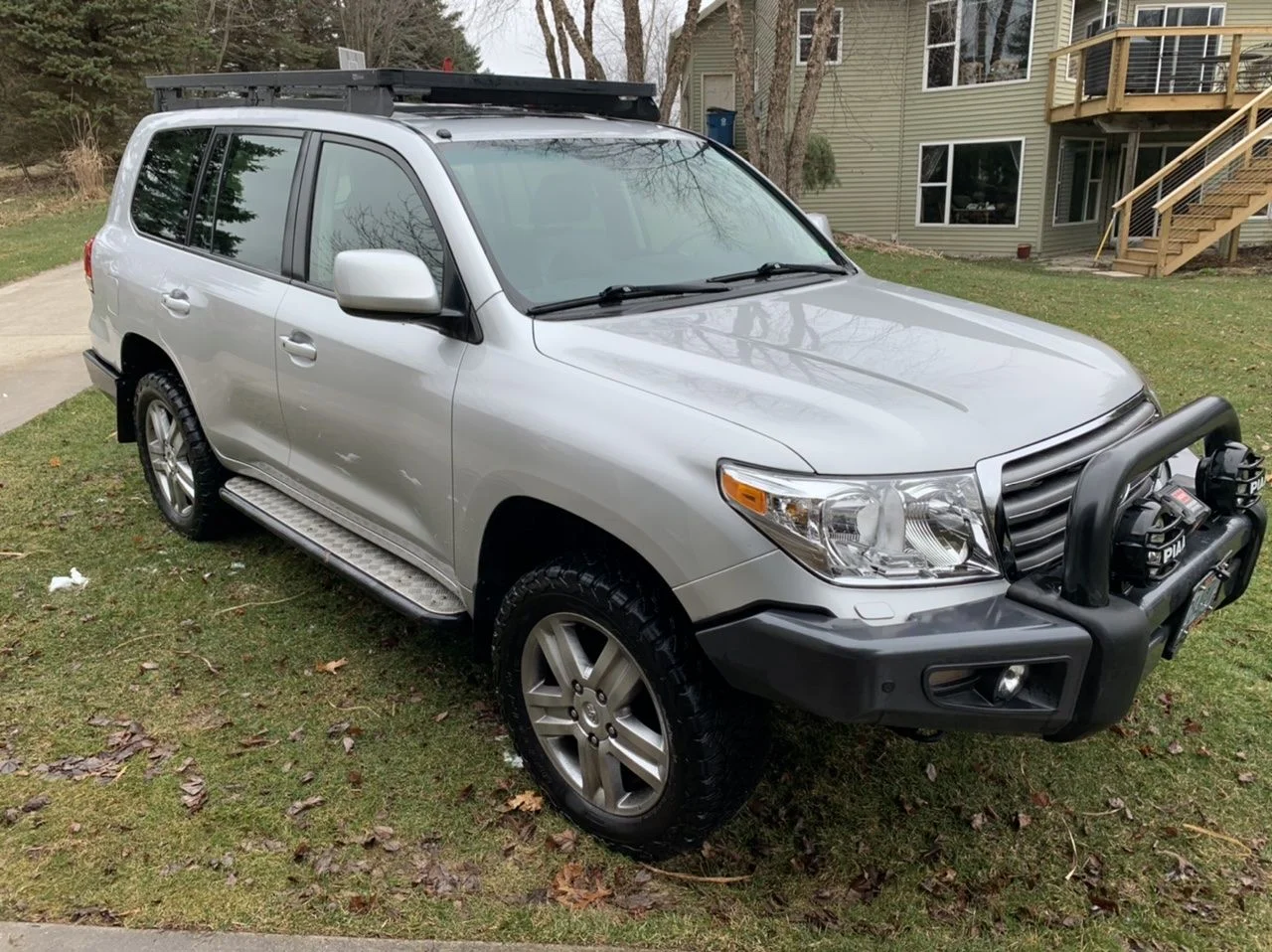

Most recently I picked up a clean 2008 Land Cruiser from the PNW. I originally intended on picking up a low mileage 200, but ended up with one that has 228,000 miles on it! It's a one owner well taken care of vehicle. 100% dealer serviced and it came with a lot of extra goodies:
ARB front and rear bumpers
ARB steps
Warn 9500 winch
Front Runner Rack
ARB underbelly armor
GROM/Vline
Hi Lift (Yes he threw in a brand new hi lift!)
PIAA Led bulbs
OME lift
A second OME lift that he replaced because it was 1" too high (so I have a full spare lift!)
I also have both ARB rear swing outs
The original owner was meticulous. He replaced steering wheel because of the wear on the wood grain. So it has a brand new steering wheel (I have the old one too). He replaced the head lights and front valence because of normal wear too.

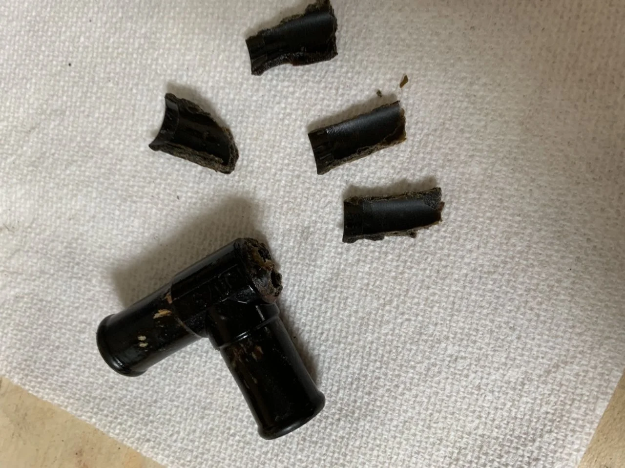

PCV valve - This was also original. Shocking that the dealer didn't service this. Purchased from Toyota.

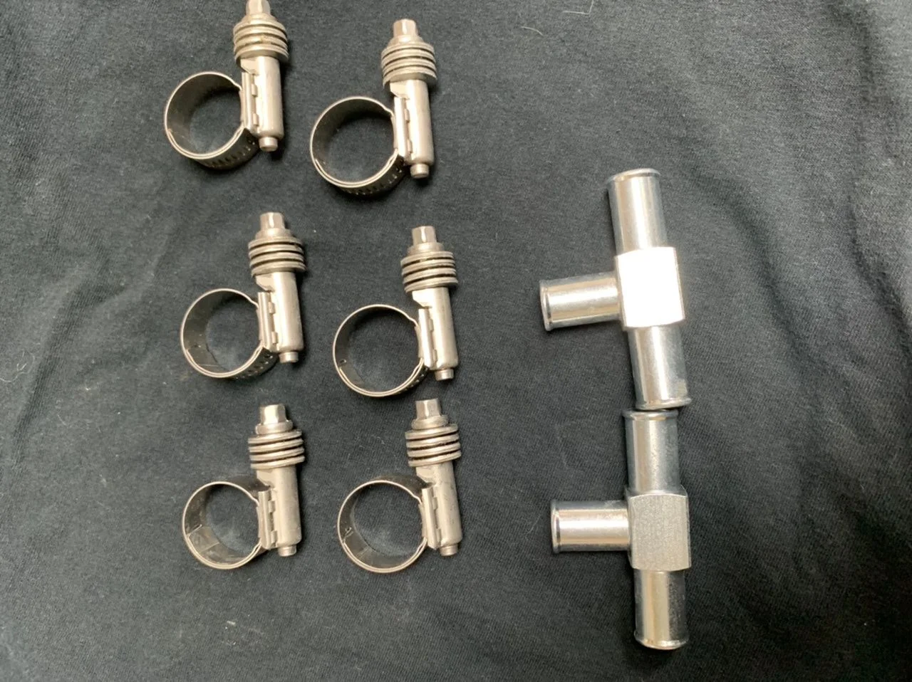

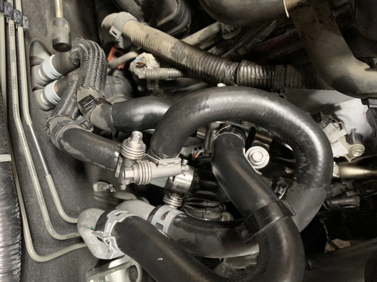

Forgot to mention that I replaced the heater tees with metal units and constant tension clamps. Glad I did, the original tees disintegrated just like my 100 series tees did. Actually they were worse. Not sure why Toyota puts glass filled nylon tees in a vehicle like this.

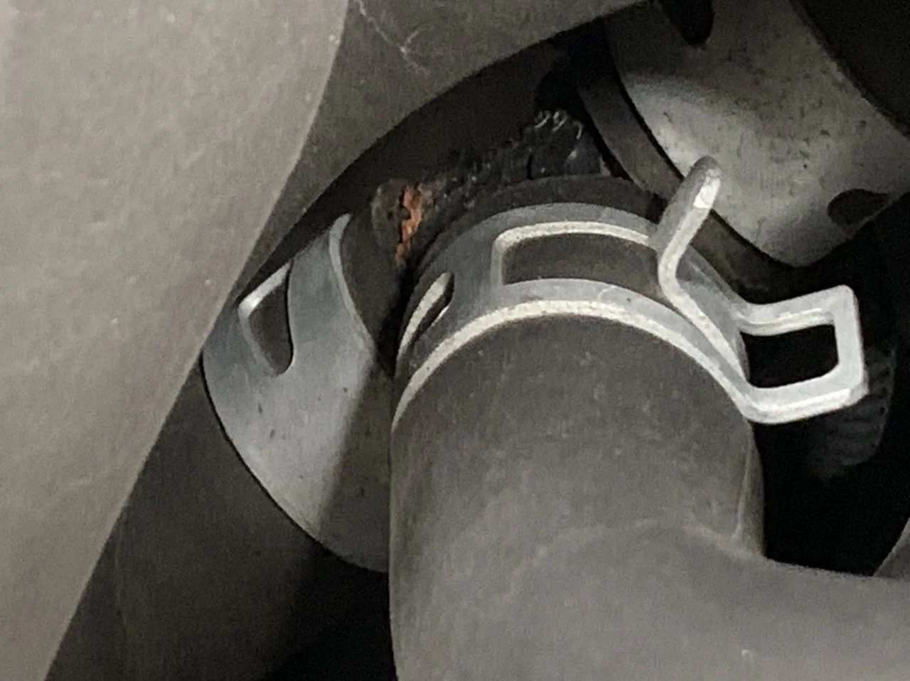

I noticed there was damage on the #1 coolant hose. I'm assuming it happened when the serpentine belt exploded. I went ahead and ordered most of the coolant hoses in the front of the engine.

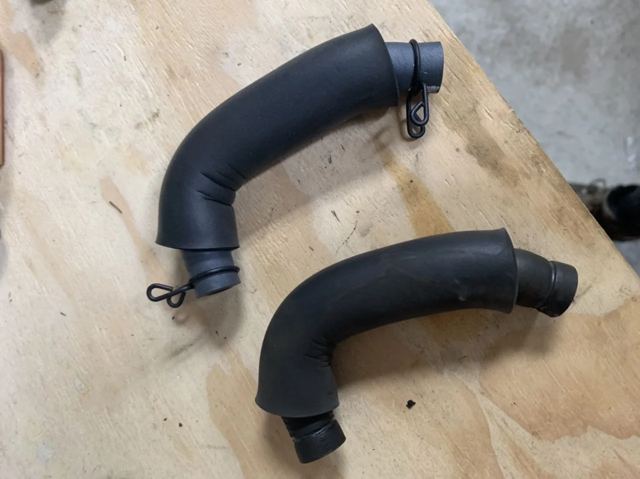

Might be my compulsiveness, but I decided after changing my PCV and seeing how brittle the PCV hose I went ahead and ordered all new ventilation hoses and fuel vapor hoses with new clamps. They were all rock hard.

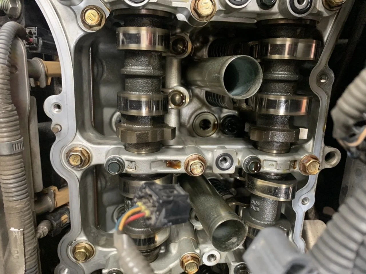

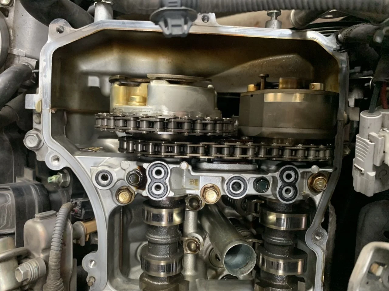

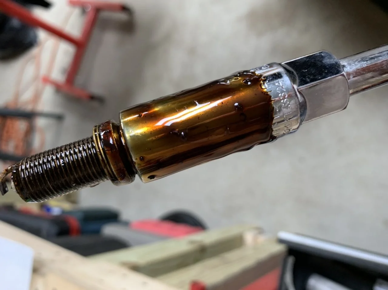

After some research I realized that this is a common problem with the 5.7. Time for new valve cover gaskets, spark plug seals, and later realized all new cam seals that are inside the valve covers. This is not an easy job! If you look at the pictures you can see the 5 seals needed on each cover. 3 different part numbers.
90430-A0001
11159-38010
11159-0P010
valve cover gasket are:
11214-0S010
11213-0S010
Spark plug tube seals:
11193-70010

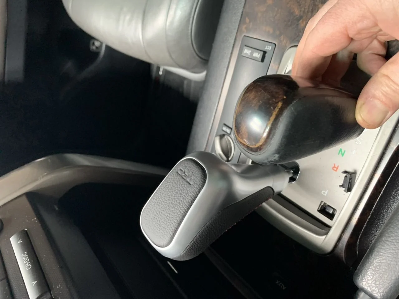

The interior is in amazing condition. I was pleasantly surprised. The previous owner put in a brand new steering wheel/switches because of the wear on the original. The door panel grip handle had the usual paint wear and the shift handle did too. So time to replace those.
Grip handle: 74611-60030
Shift knob: TRD PTR57-34141

Verified that there isn't a front timing cover leak or cam tower leak. I don't see anything. I'm relieved because I just pulled the valve covers off which is more than half way in the process to resealing the cam towers!

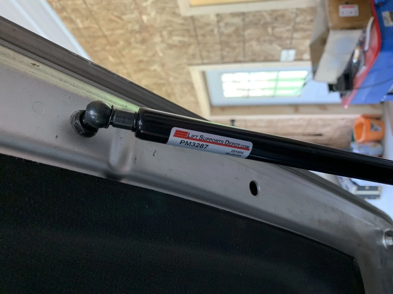

Replaced the original hood and hatch struts before the hood came crashing down on my head! I couldn't justify OEM struts, but they lasted over 200,000 miles. Impressive.

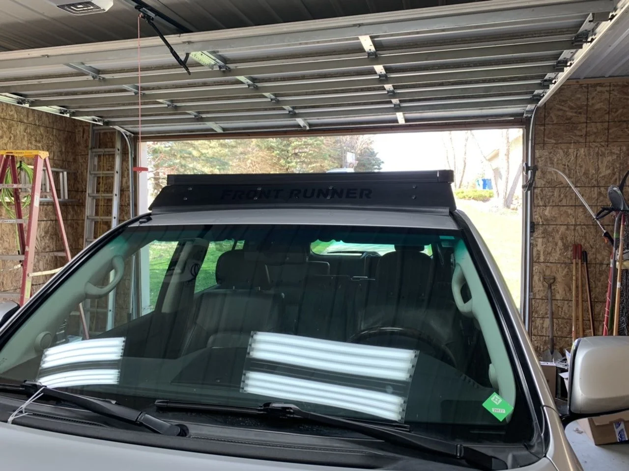

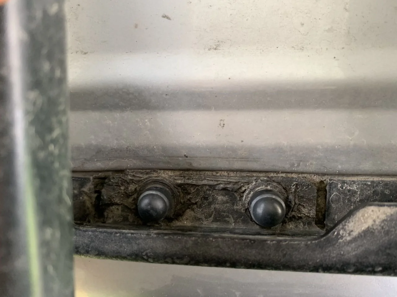

The 200 came with a front runner rack. I was getting wind noise in the cabin with the sun roof shade opened. Not terrible but I decided to install the FR fairing that the seller included brand new with the 200. Still have wind noise! Oh well not too worried about it. Anything I should check to make sure I don't have leak problems where it's bolted on? It looks a little messy.
