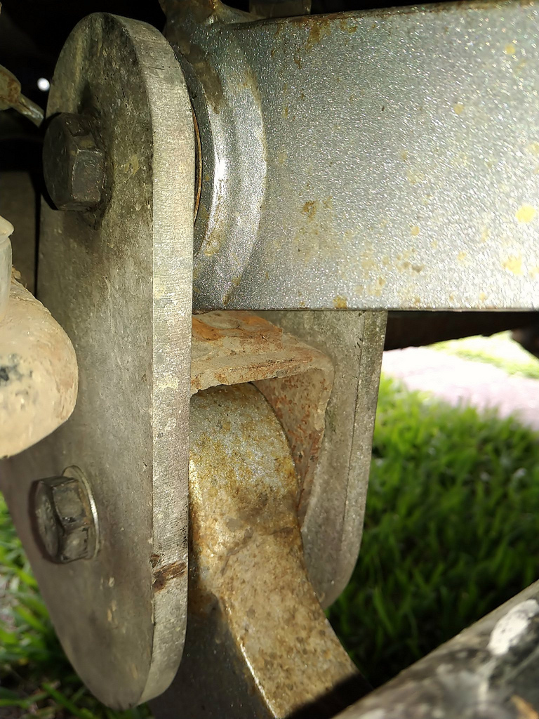

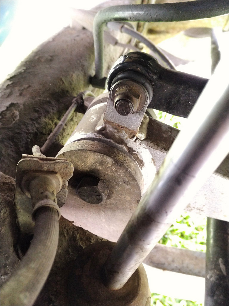

Maybe the LHD axle housings are different, but to fit the 'superflex' arm (with the plates) that changes the articulation line from 'under' the LHS of the axle housing to 'behind and vertically' behind the axle housing requires the factory swaybar mount to be removed on a RHD 80 series. It cannot be left in place.
These pics show a close-up of where the factory swaybar mount was, and what the superflex arm has to replace it (the RHS requires a spacer block to 'lift' the front swaybar mount up to match ).

The key change with the original 'superflex' kit is that the articulation line stays underneath the axle for the RHS but is changed to 'behind and vertical' for the LHS. That's how the extra flex is achieved.
Note also that the odd-one-out top bush for the 'superflex' arm is *not* a Toyota bush - the only one that fits is a Nissan bush and it's design is important to achieve the claimed level of flex.
The mis-matched flex angles are I think what makes the on-road behaviour so markedly un-nice.
