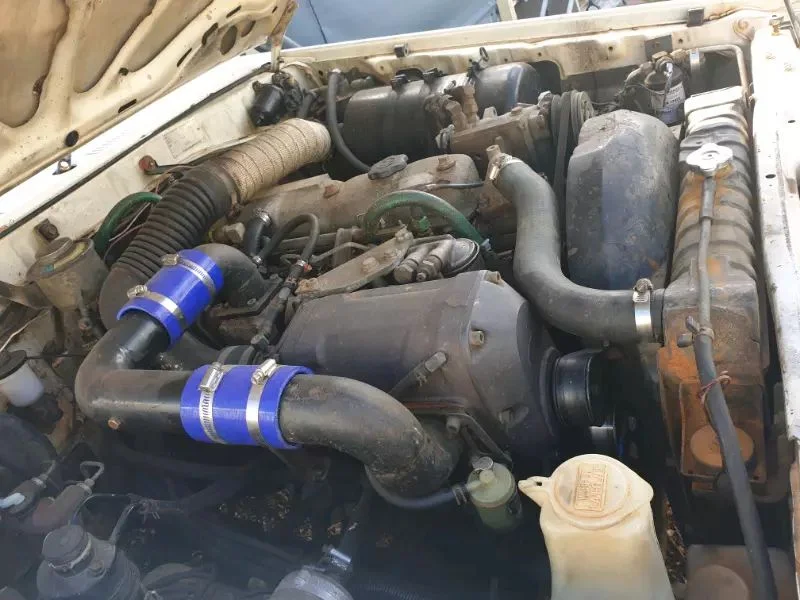

Some time ago I dropped into a wrecker and was quite surprised when I opened the bonnet of an unassuming beige HJ60 and found a freaking supercharger strapped to the side of the 2H.
I asked the wrecker what the story was and he said an old bloke had it, he had the motor rebuilt and supercharged to tow his caravan. It blew a headgasket so he moved on and parked the 60 up. He didn't know who supercharged it or what supercharger it was.
Interestingly, it runs the throttle body on the inlet side of the supercharger. I wonder if operating the supercharger in vacuum would lessen the drive power needed at part throttle? Like when you block the end of a vacuum cleaner and it speeds up because there is no air to pump/less load.

(before the argument starts) Personally, I'm not that interested in supercharging a diesel due to obvious power losses and less efficient compressors. I just think people might find this interesting and worth documenting.
Does anyone know anything about Sprintex superchargers on the 2H? Did they ever offer a kit? They had a kit for 1HZs but I can't find anything on a 2H setup.

That is an advantage to the sprintex, it's tremendously compact.

I had a tour of the Sprintex factory a few years back, its only a few klms from where I live. The unique thing about their rotors was that they had no seals and instead relied upon very high tolerances between the rotors , this meant they had much longer lives than the old The rotors were also teflon coated. Roots type blowers that needed to be stripped down to replace seals. They modified a lot of landcruisers used as drilling rigs.

You can adjust them by changing the drive gears. You dont realy need to give an old leaf sprung 4wd more top end speed. They were considered good into mid range rpm Great for towing. Sprintex told me they have low EGTs because the exhaust doesnt have a turbine restricting it.

The displacement is geared to the crank. So you determine how much boost you want based off the ratio of air to be forced in vs your displacement.
But off idle they have some internal leakage so won't be that inspiring.

It’s an interesting theory but the biggest disadvantage would be the fuel economy. I have a Eaton roots based supercharger on a V8 and at “normal” driving conditions it in bypass mode and apparently only adds .3hp of drag. When you put your foot down and create boost it takes a lot more power/fuel to drive but is actually remarkably good.
The issue with a diesel is it’s always sucking maximum air so not sure how you could plumb it to not be creating boost at all times. The power/resonpse down low would be insane (better than any turbo) but I could imagine fuel usage being significantly impacted.
