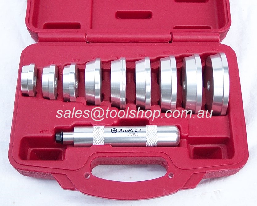

Also get a set of cheap bearing race tools. Like this. Usually under 20 dollars.
