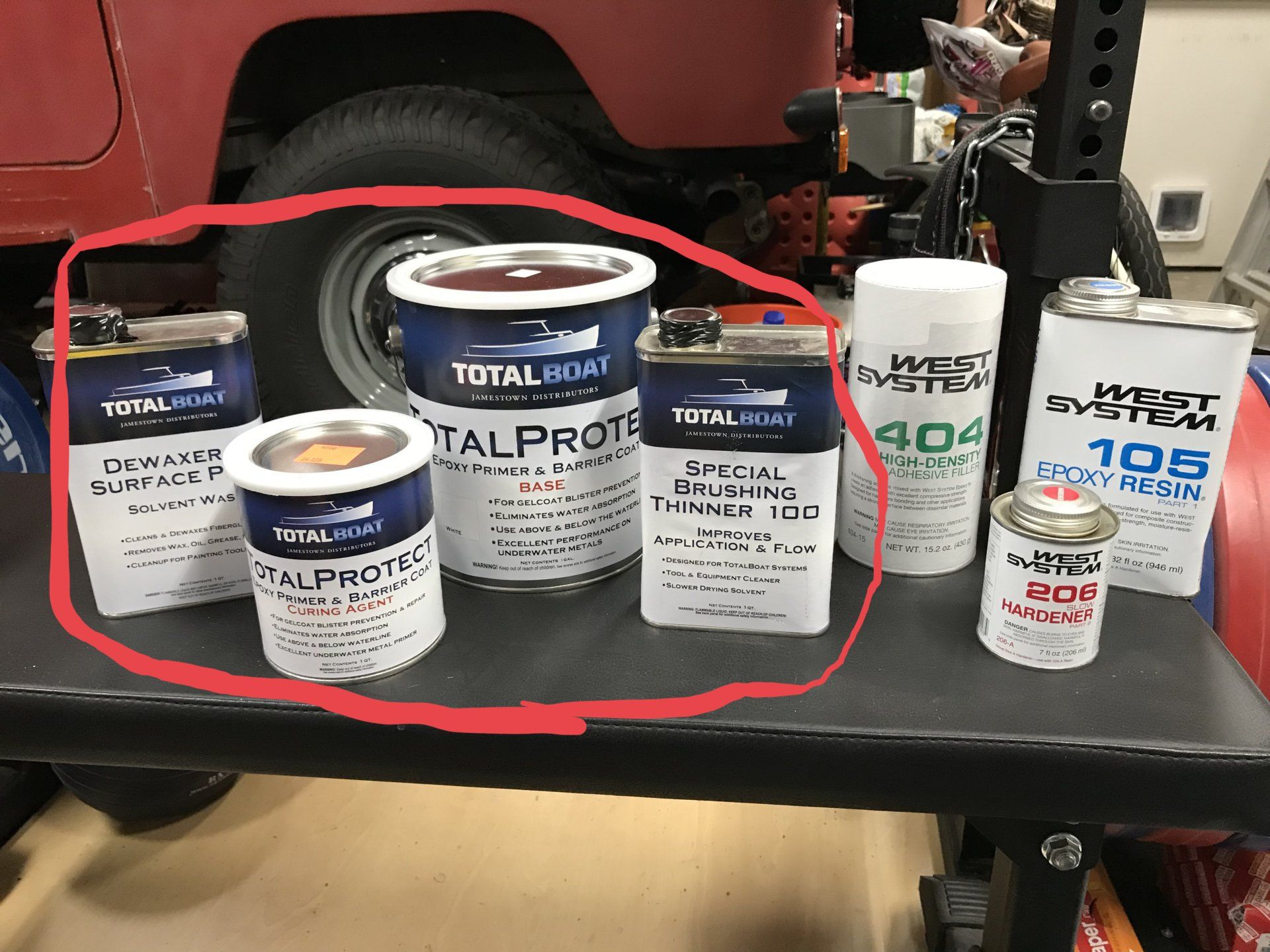

Check out my thread for the products I used to coat my top and then I painted it with a cheap appliance epoxy paint.
I spoke with the Total Boat guys and explained the setup and this is what they recommended.

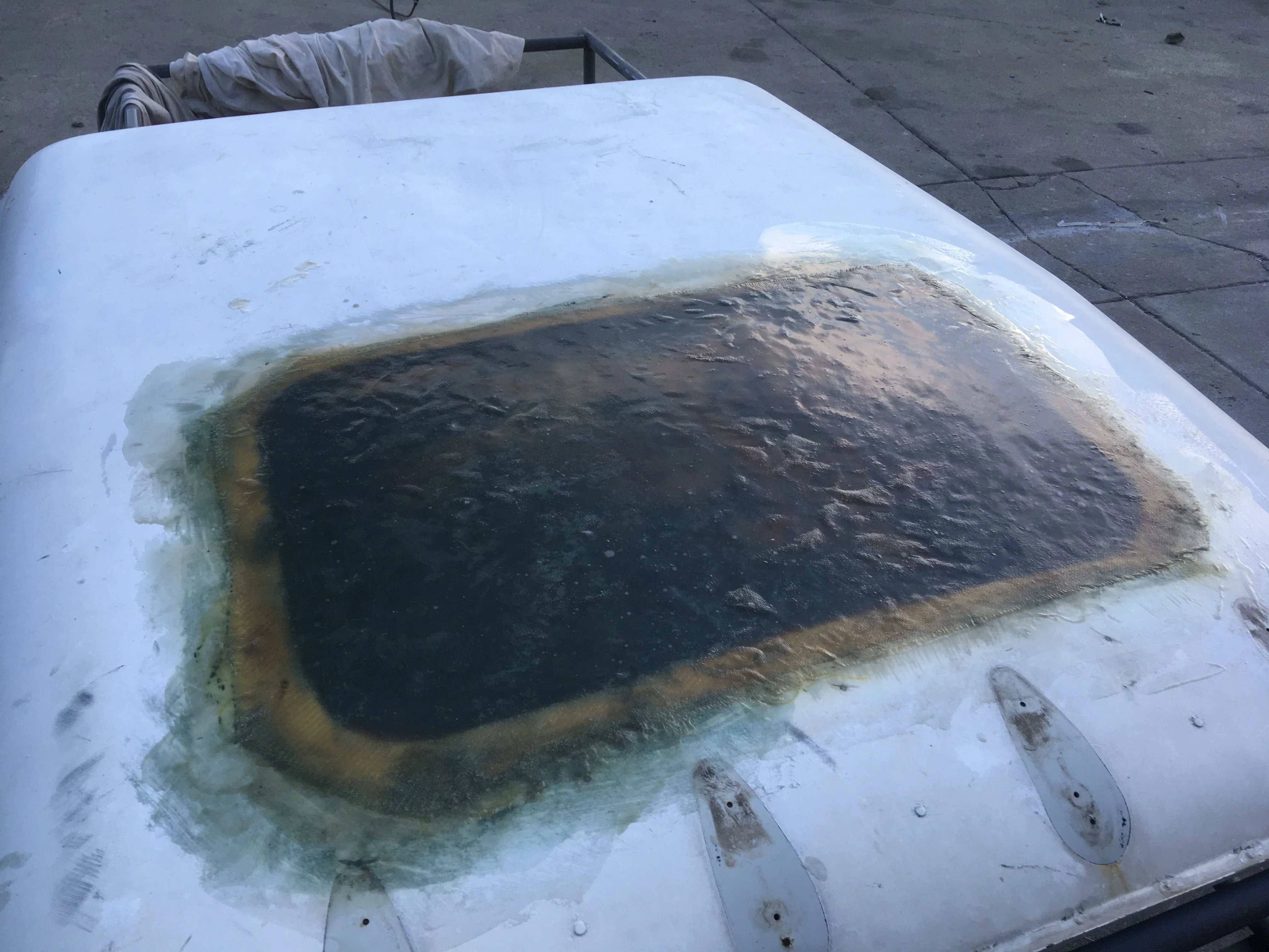

I used a curved piece of steel cut from the roof of another old car to support the underside of the glass patch.
Glassed in the hole. Removed the support. More glass is then added on the inside.
Sanded to smooth it and match roofline curve.
Painted it in Shell Ivory. (No gelcoat. Maybe gelcoat is more OEM correct? After reading up on a bunch of boat forums, I'm no expert but I don't feel it necessary.)
It is a little heavier than from the factory. Where there was a thin layer of foam sandwiched in the middle before, there is now just fiberglass. One more plus, it is stronger. One more minus, it is a little thicker on the inside. The non-OEM headliner with extra thick foam backing does a good job of hiding the imperfections on the inside.
