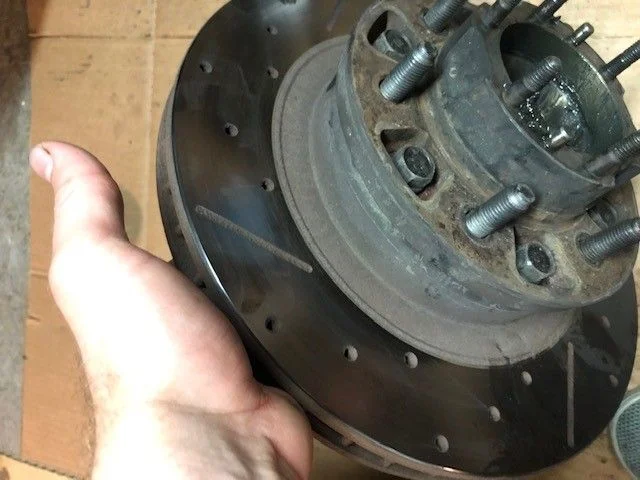

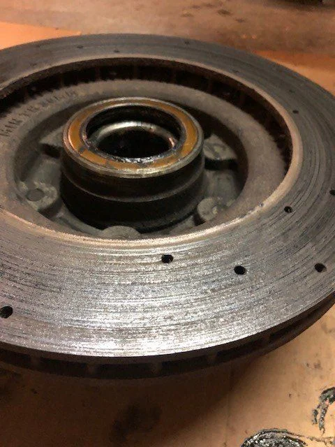

Thanks for the information guys. I really need rotors/pads that are going to hold up on the trails. I have seen many different opinions on drilled and slotted rotors. So far I don't think they are a good option for the trails. My current rotors are drilled and slotted. I did make the mistake of replacing pads with Auto Zone pads and I have uneven wear on them.
I have much more wear on the back than the front and it also shows on my pads. My breaks are squishy and if I slam on my breaks at higher speeds it takes about 2 seconds to come to a complete stop (not safe). I bled my breaks and wasted $115 to have the ABS bled. Shop said they think its my wheel bearings. I don't think that's correct. I've seen post on people not being able to get air out of the ABS. I've been needing to rebuild my knuckles and wheel bearings so I'm in the process of doing that now. I am leaning towards taking the ABS out but I want to give replacing the wheel bearings a shot before I go down that road.

As for that fubar rotor, looks like you need to replace your caliper to me. I can't think of any other reason you'd have exessive wear only on one side of the rotor.
Powerstops for about 20k miles. That's about 2 sets of pads as I pull a camper sometimes and use pads that wear quick (axxis ultimate, cheap and stop amazing, but dust and wear out quick). So far so good. Next time around I think I will not get cross-drilled rotors though, as I've collected some mud and gravel in the holes and had to clean them out once or twice.
I was worried it might be the caliper. This job just got a lot more expensive.
What's worse, you'll want to do the pair, not just the one caliper. Tried to cheap out a couple times before learning that lesson.
Meh, napa calipers generally carry a no-questions-asked warranty. Advance auto are cheap. They all seem to do about the same IME. Or if you have more time than money, you can get an OEM caliper rebuild kit and rebuild yours rather than buying new ones.
