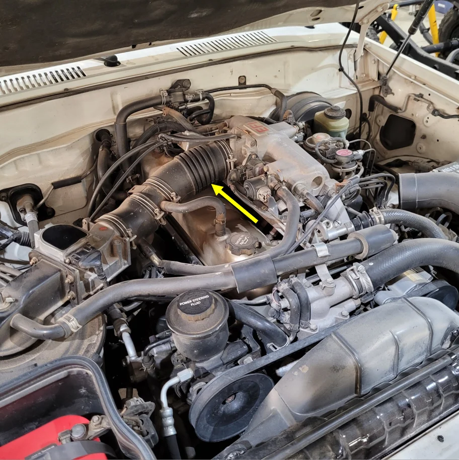

Some have reported cracked intake hoses that flex on acceleration. Arrow in this picture. I didn't see where you mentioned this. This is after the airflow meter so it can be a large vacuum leak.
Thanks so much for this feedback.
I live in Portland Oregon, so hills are a thing for me daily.
Fuel economy is right around 10-11 mpg.
I actually do not know anyone in the LC/4x4 world so getting behind the wheel of a known healthy rig would be hard for me.
I haven't replaced that hose specifically. I did wrap the whole thing in electrical tape when I was chasing idling issues (see attached video's). It _does_ sound like a diesel a bit because the exhaust is pretty rotten, please ignore that part at least:
