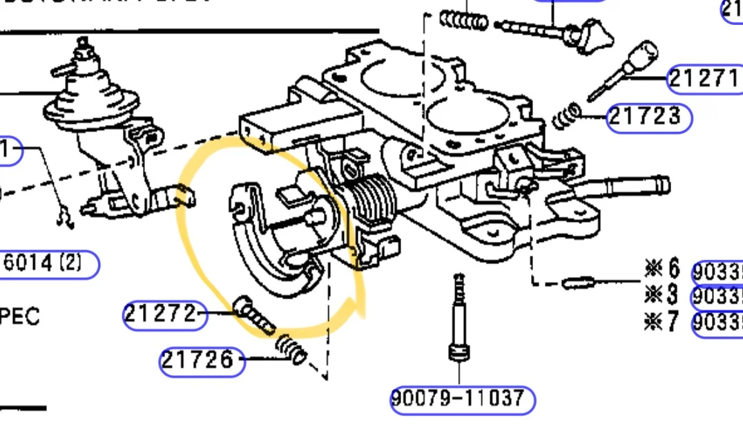

I have been having some trouble on my 1994 1FZ-F 80 series. at first i thought the accelerator cable was getting stuck, as the RPM could get stuck up at 2000, and when i pull the throttle pedal back a bit it would fall back down, sometimes i would press the clutch and the RPM would climb instantly. Now that i have checked the cable seems fine and i adjusted the tightness and all, however i believe that the lever, where the cable is sitting on the carbi s the one that gets stuck, as now when i pull back the pedal nothing changes. Now i need to push it back manually and the RPM drops instantly. I have attached below the lever where the accelerator cable is sitting, thats the one i push back down to let it release.
has anyone experienced anything like this? what would be the solution for this?

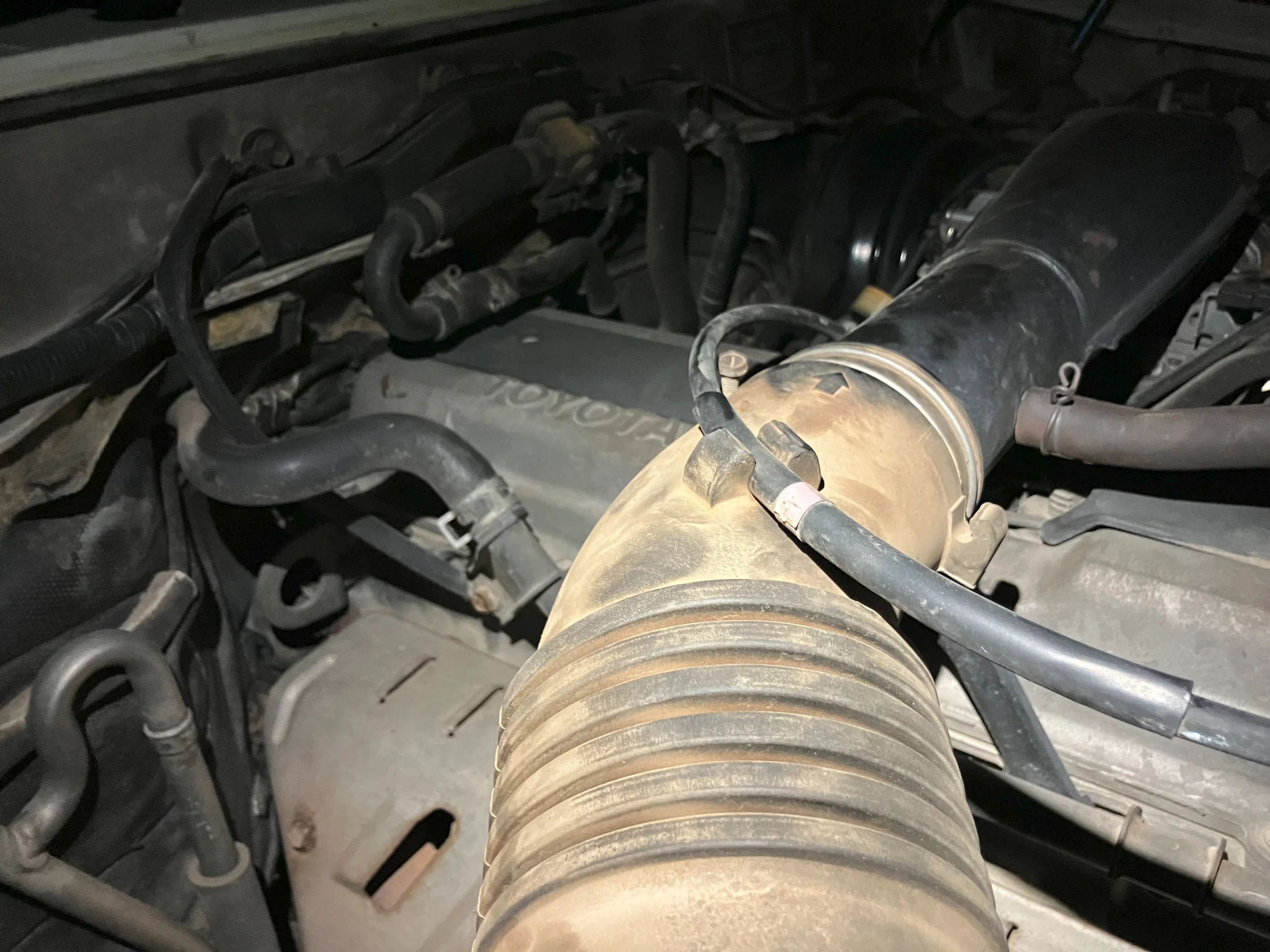

First one is a notch on rubber flexible hose attached to the air filter housing on one end and the intake air connector to the carb on the other end (not sure if the troppy has the same setup as the 80 series).

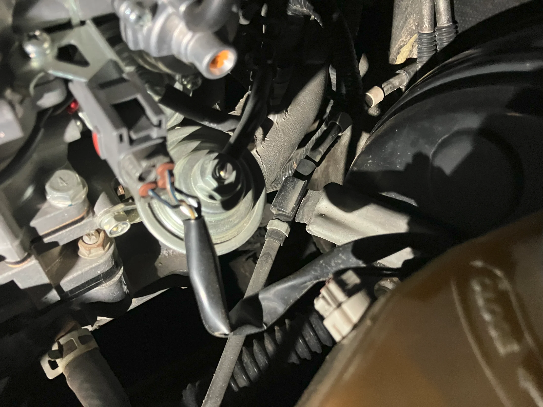

Then there are 3 clamps for the cable after, one on the No.1 Engine hanger

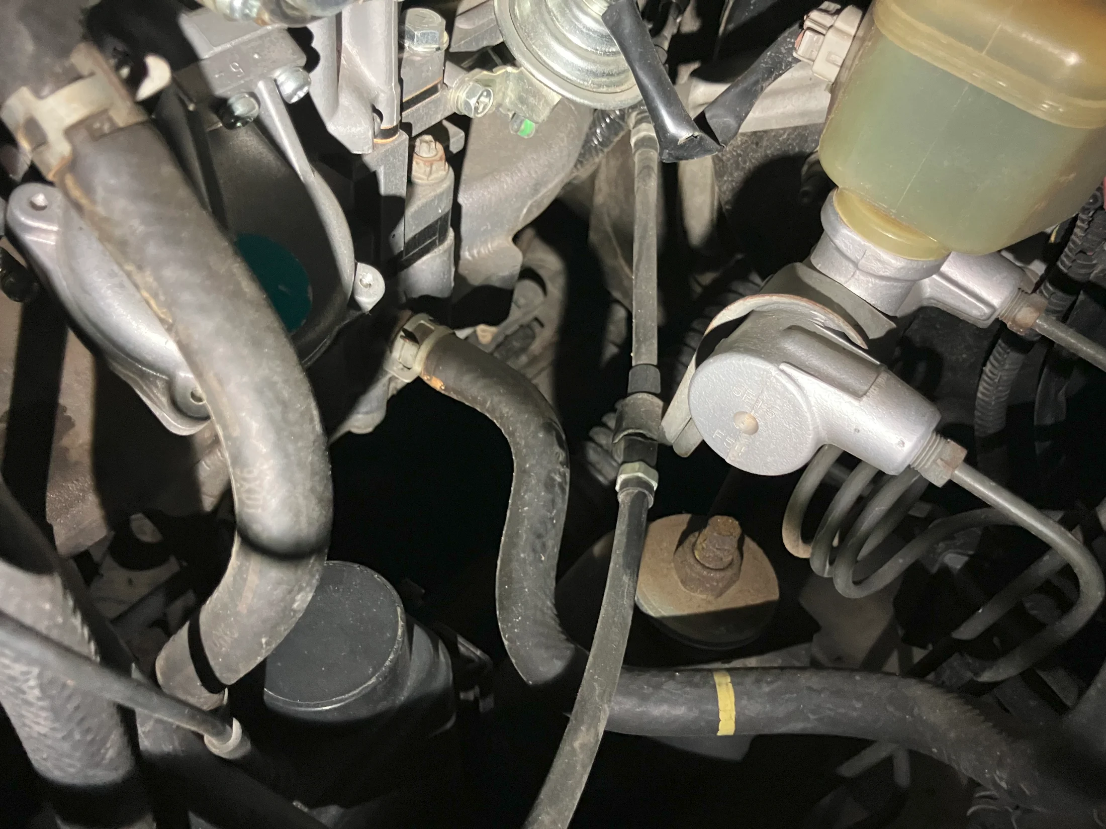

One before the master brake cylinder

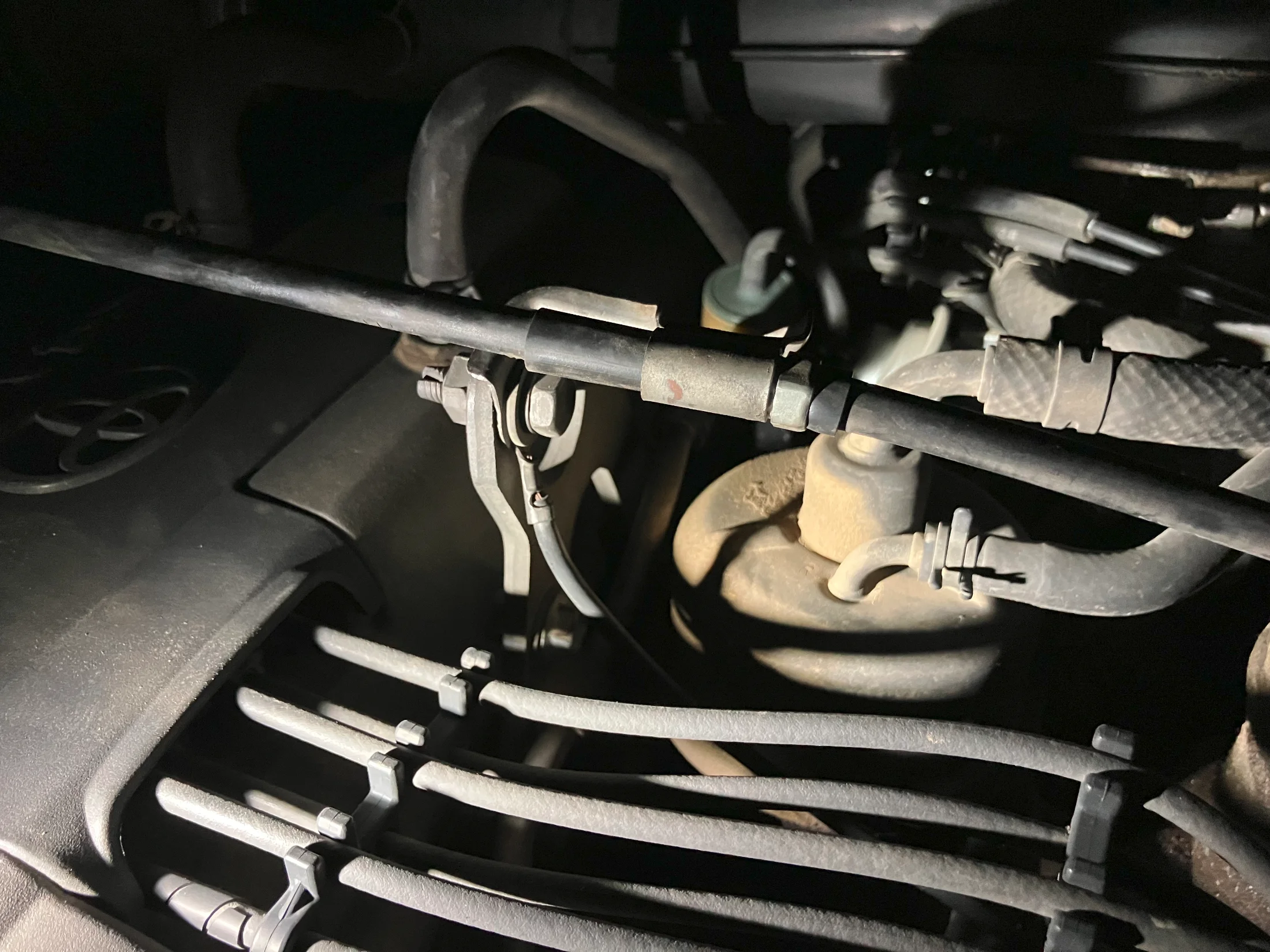

and one infront of the brake booster
Make sure the cable fits snug on them and not too lose that it moves back & forth.
