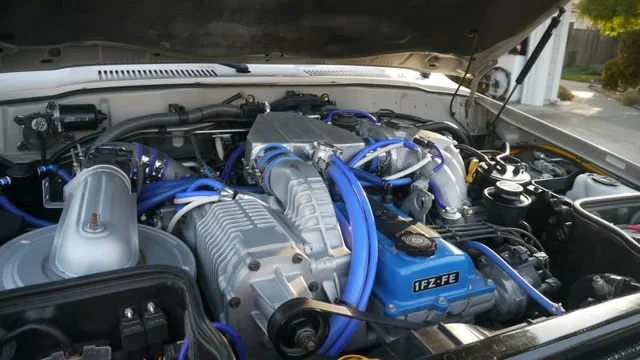

Another vote for going the 4.6 plus TRD supercharger route. Also another vote for Robbie - incredible knowledge and experience with these engines and you won't find a nicer guy. Here's mine :beer:

DAAAAAAAAAAAAAAAAMMMMN! More engine porn!
That would be exactly what I would want mine to be with the only exception being a pewter valve cover.
Very nice. What type of power are you getting now and what type of experience did you have with the builder?

With a 2.8" pulley on the SC, we estimated maybe 320 hp/400 ft-lbs, but that's just a guess. Nothing but good things to say about Robbie, l would recommend him without question. You can PM me if you want more info, don't want to clutter up this thread.
