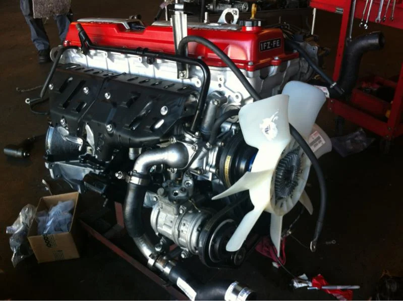

What setup do you have in your truck nlxtacy?
4.6 S/C'd. Here is the build out: https://forum.ih8mud.com/80-series-tech/553208-engine-rebuilding-options-s-c.html
Engine porn...
attachment.php
