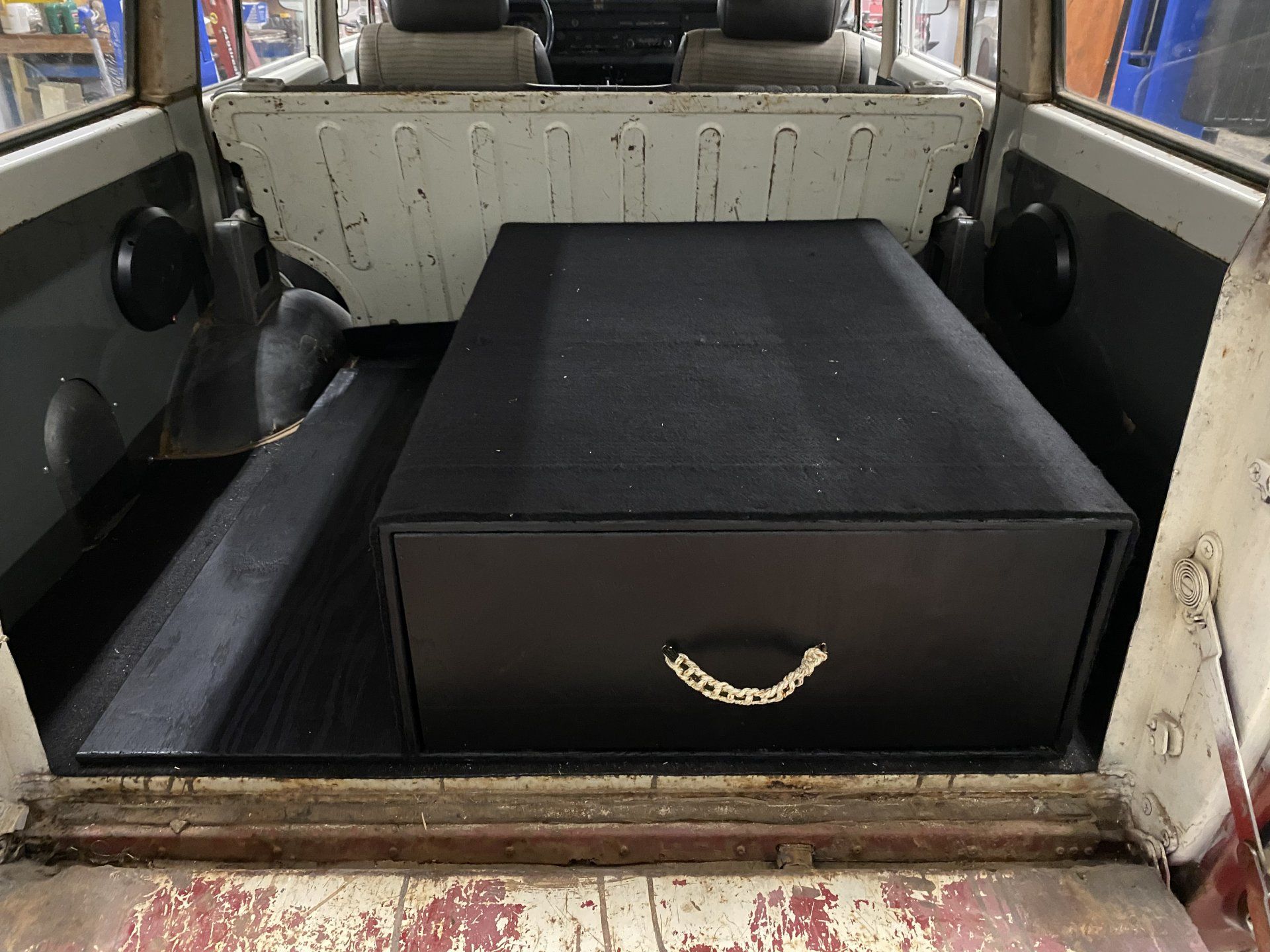

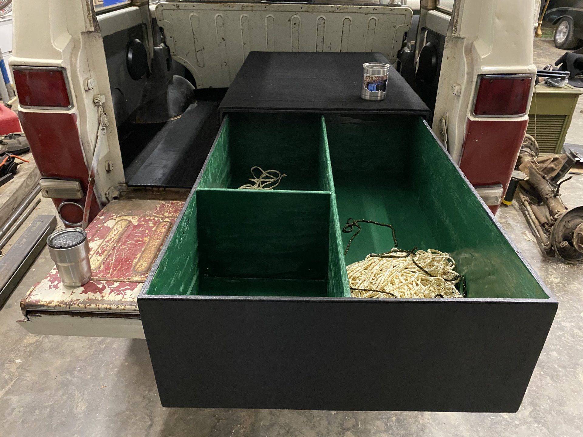

Here’s my contribution to this thread. Simple drawer, no slides. I hit all the edges with a router to round them out then painted or wrapped carpet over it. Still working on my slide for the fridge at the moment.

How does the drawer pull out with it fully loaded?
Having built and used this type of drawer system many many times with decades of use for heavy construction tools it was never a issue to pull them open.
I prefer the non slider drawer as it well stay put in any spot that you open it. with the fancy sliders if you not on flat ground the drawer wants to come sliding out on you and only stops when it's in the fully open position. JMHO ;)
I‘ve had the same experiences as Broski. The one time I did do a fancy drawer system using small rubber casters, on any slope it would come crawling out unnecessarily(sometimes like a devil).
Camping gear does not weight that much. There is no need to have 100lb drawer glides (Waste of valuable inches). Even 3/4 ply might be over kill for drawer boxes. Build the main case out of 3/4 ACX or cabinet grade ply wood. Find a local cabinet maker to fabricate 2 drawer boxes, instead of one wide one, to the sizes you need with dove tailed corners using quality drawer stock (use Brie wax as a finish) and you’ll have drawers that operate smoothly and last indefinitely. They’ll stay in place how every far you pull them out (unless your on some crazy slope).
