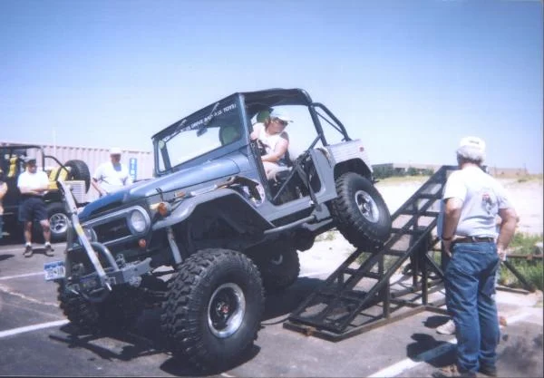

I think I remember seeing (a few years ago) a picture here on Mud with one of Waggoner5's with some chevy rally wheels. It was a white 60...

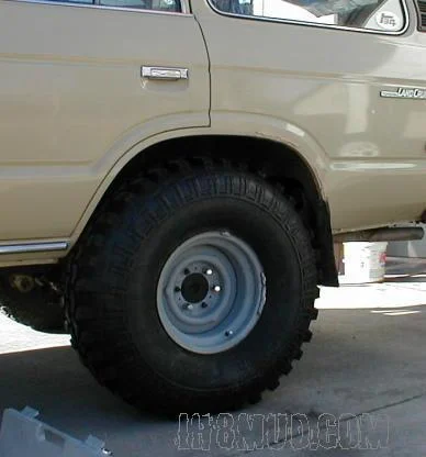

not the best pics, but here are a couple of my 40s with rally rims. when i get home, i'll have to see if i can find pics of my old 60with rallys on

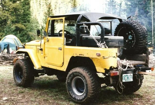

quiet at work tonight, so i found a couple pics of the brick with chevy rims
