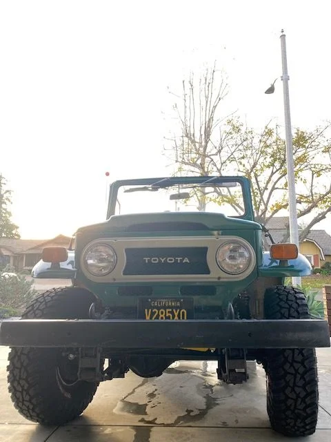

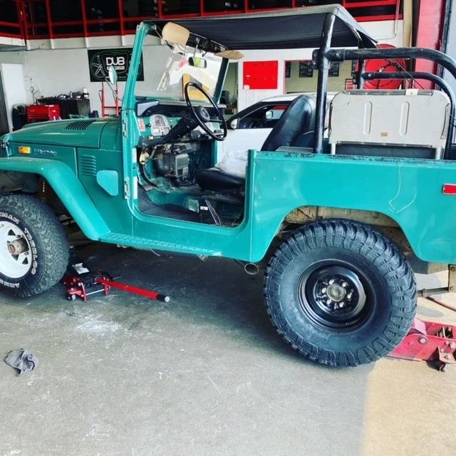

My 1974 FJ40 has quite a bit of sway during driving. The steering wheel feels solid, but the rig sways a bit. Any suggestions?

Tell us your set up and preferably post some pictures. Do you have a lift? Lift Shackles? Tire size? New to you truck or something that has just started on a truck you have driven?

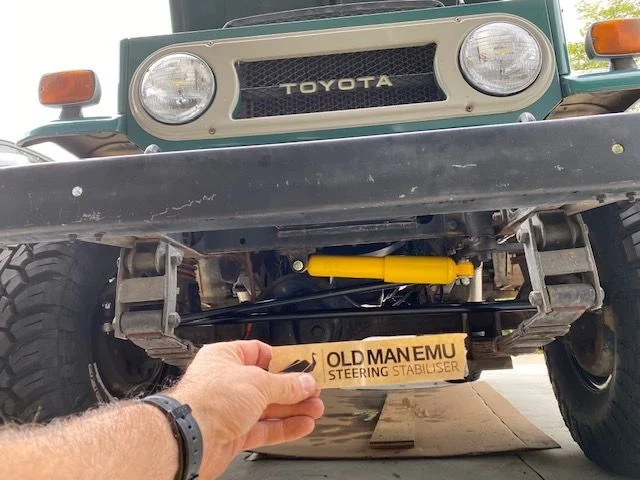

I'm running on new Grabbers, 33's. New front stabilizer, and came with Man a fre shocks.
