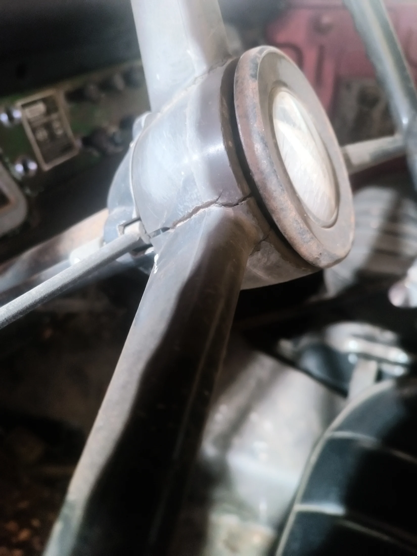

Mine is in pretty bad shape. Big cracks where the spokes meet the hub on all 3. The grip/ring is better, one small crack. This is a 9/69 build.
I'd like a slightly smaller wheel if possible as I'm refrigerator sized. Plan on putting extenders on the driver's seat as is. Not doing a pure restoration.
Not sure what other year wheels would fit or if they are even any smaller but I'll likely need another regardless. I've searched around on MUD but didn't find anything definitive, prefer some sort of OEM wheel.

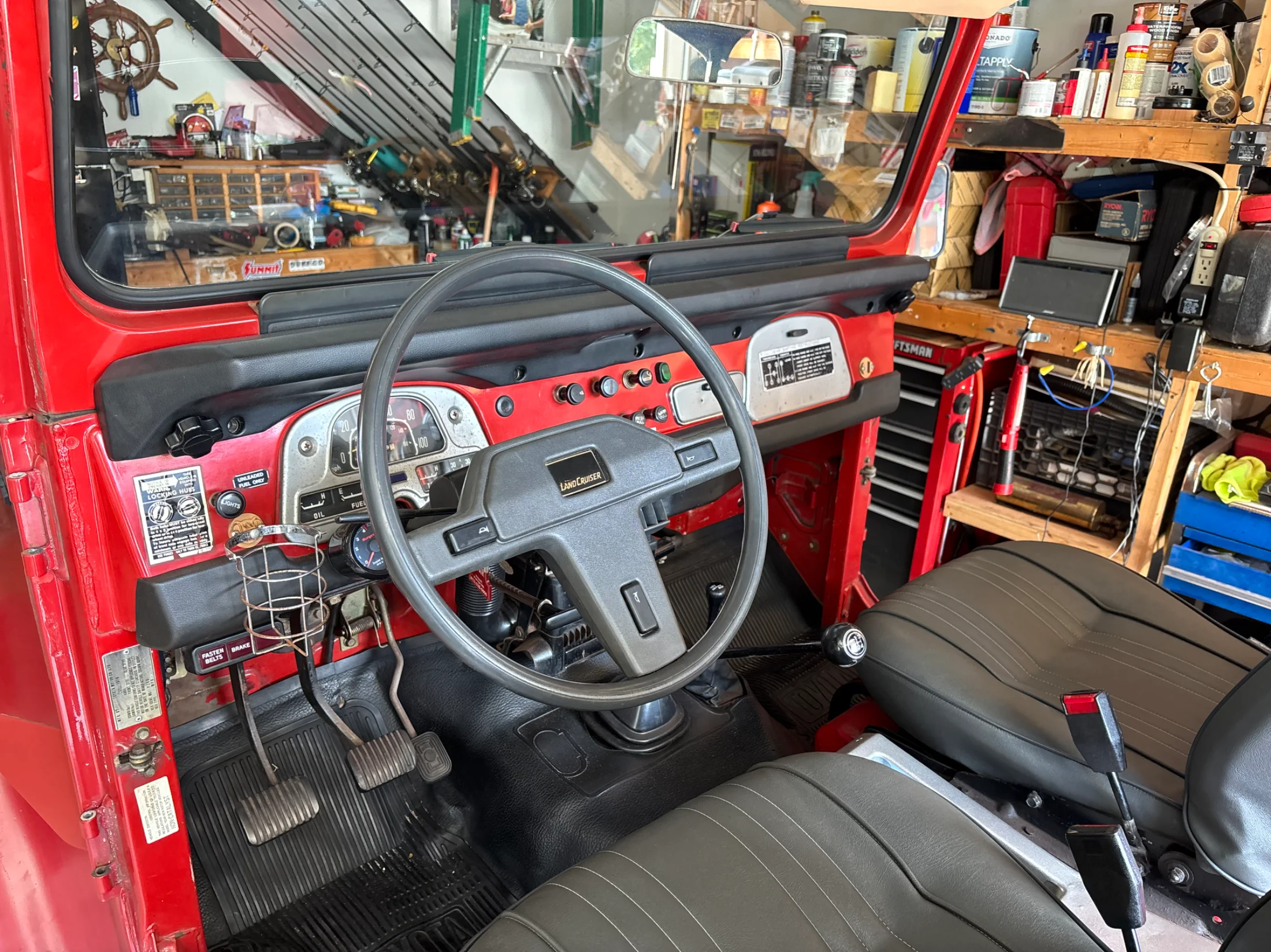

I recently installed an FJ60 wheel on Lilred (1977 FJ40).It’s about an inch smaller in diameter but still easy to turn and steer with manual steering. Only modification was drilling and installing the two turn signal cancelling pins. Not sure if that type of wheel would work with your year but there are options - and reasonably inexpensive.
