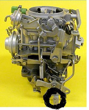

what exactly does this spring do attached to this part circled in the pic? i think it attaches to the linkage on the other side and sits horizontal. what would be the effect on the carb if this spring were missing on the carb?

The part circled in the above pic is where the throttle return spring goes. Yes, you need it. Easy to get if you don't have one. Effect of not having one is probably hi idle.
But if you're still having the idle issue, and your carb has lots of miles on it, you need to remove it or pay someone to remove it and send it to Jim C. (fj40jim on this board) or Mark Algazy ( http://www.marksoffroad.net ) and have the carb rebuilt.
But if you're still having the idle issue, and your carb has lots of miles on it, you need to remove it or pay someone to remove it and send it to Jim C. (fj40jim on this board) or Mark Algazy ( Marks Off Road Home Page ) and have the carb rebuilt.
