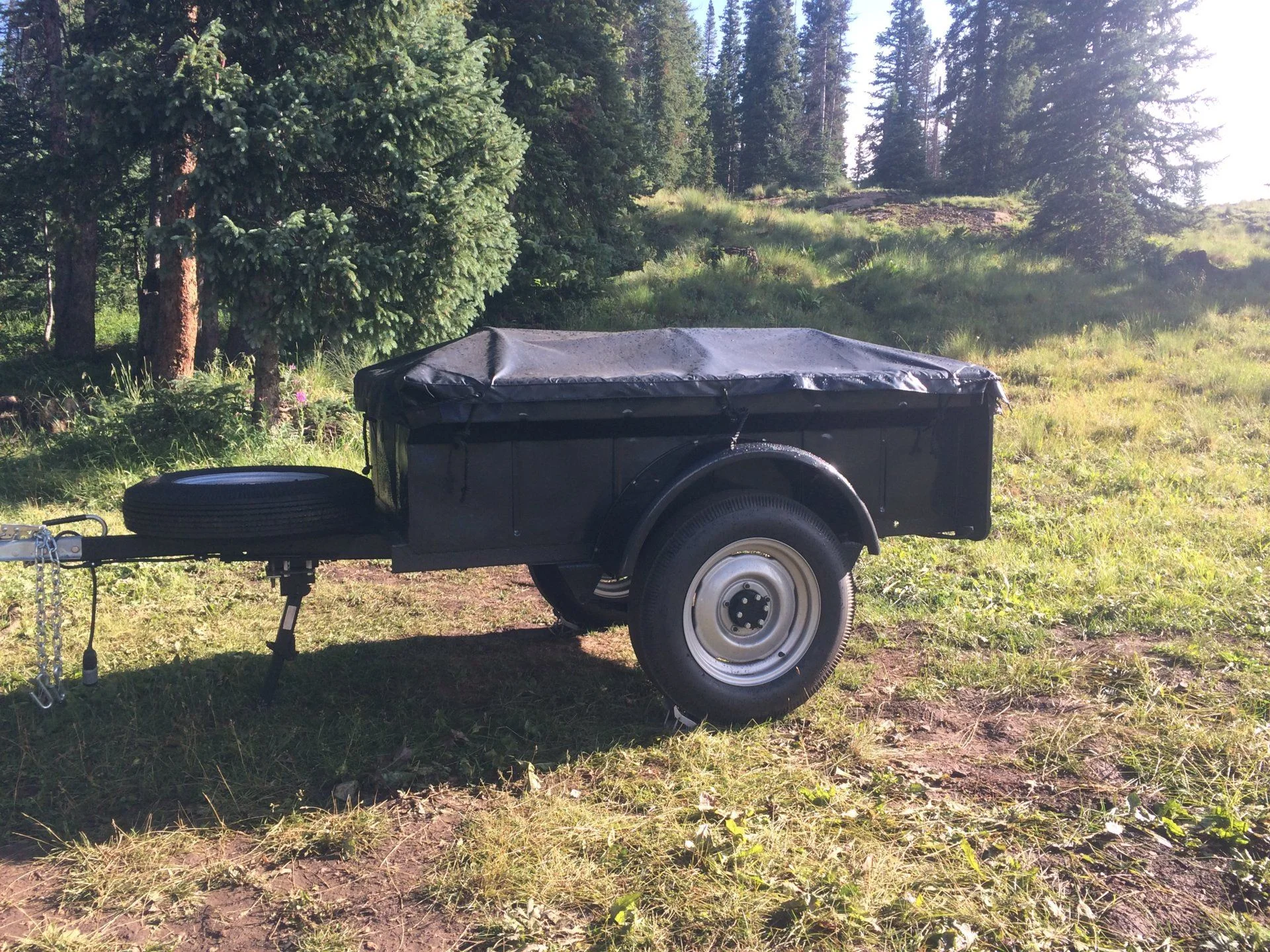

I went the surplus/refurb route and while I love the trailer, if I had to do things again, I would most likely try and build something custom that looked similar. I spent a ton of money on just getting the trailer itself and when all said and done with the tires and paint and whatnot, I could have probably done it cheaper building one myself. Some of these M100/M416 type trailer are just getting so out of sight on cost these days. I remember when they could be had for like $500. I had to give $1200 for my Bantam T3-C (civvy M100) which came with dry rotted tires and rusted wheels. I am prolly into it now for like $2500 after tires, paint, wheels, etc.

Just seems to me to no longer be cost effective to get a vintage trailer. Deals can be had I guess, but I couldn't find them. Anything you do find most likely won't be ready to roll and you will have to do a bunch of work on it anyway, so might as well just build it the way you want from the ground up. Allows you to build in water tanks and power inverters and what not if that's your thing. I don't think some of the M100 type trailers are all that sturdy to begin with and you could easily build something a lot stronger but with a similar look. I wouldn't feel comfortable putting an RTT on mine at this point for example. Does not seem strong enough to me. You could even weld up a frame and drawbar setup and get M100 parts from here to finish it off:

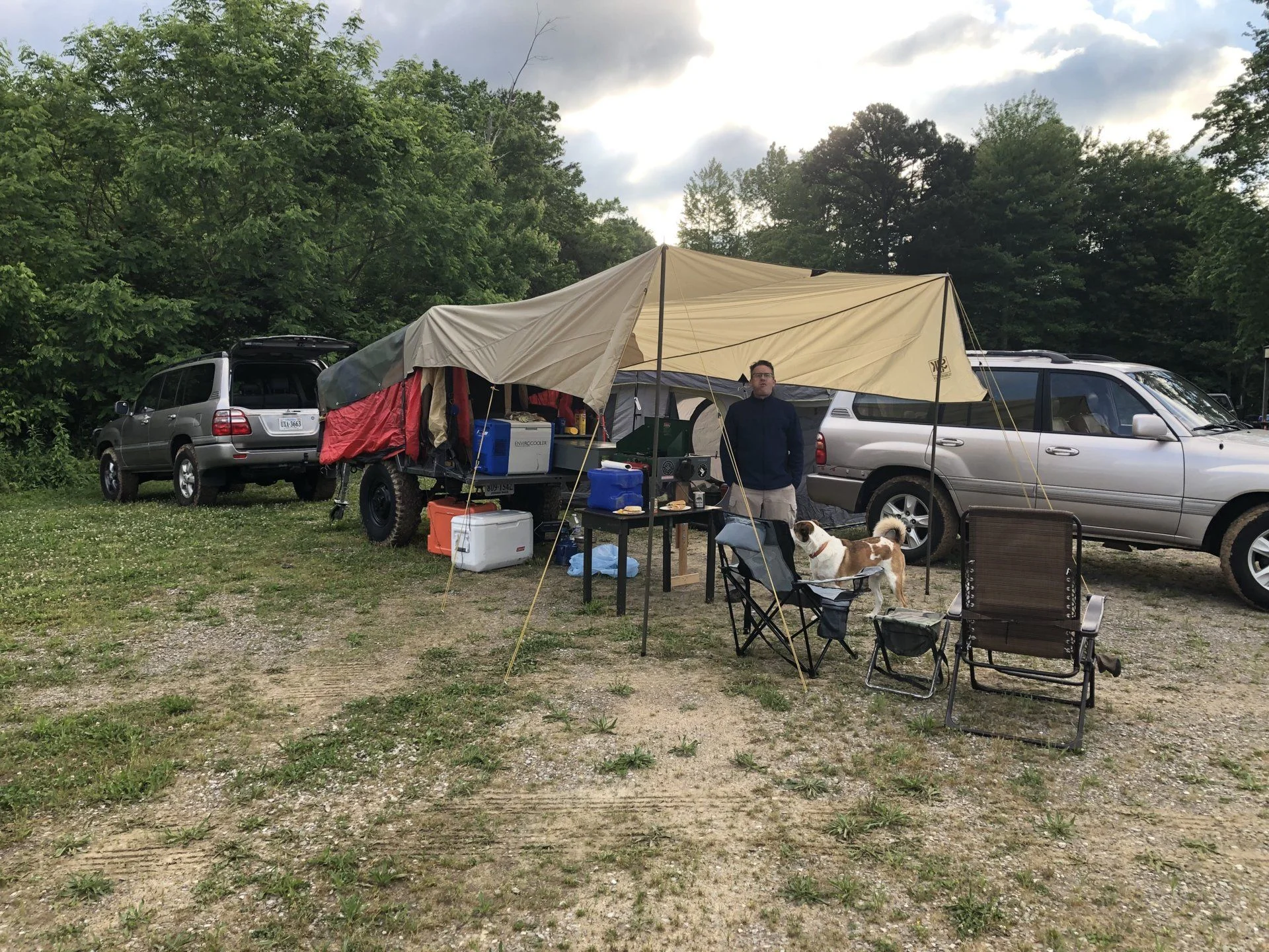

So here is my 1968 M101A1 trailer overlanding trailer. Took about 3 months, still not done, I would like to swap the axle and tires but not a high priority at the moment. Would like to get an 80 series LC and match the tire wheel set up.

Pics cover most aspects of the build, clean up, getting a handle on the rust, paint, all new wiring, pull out kitchen, sleeping platform, hi-lift jack mounted, front storage and other features. The tongue was extended, harbour freight tongue box and jerry can holders now have plenty of room. The set up allows for a standard ball or switch to an off road set up. 100 watt solar set up with a 12v deep cycle battery as well, runs the fridge and lights. Set up now has an old tent for sidewalls and a slumberjack awning.
Still lots of bugs to work out and need to take it on the first trip with my sons but for the most part done.
