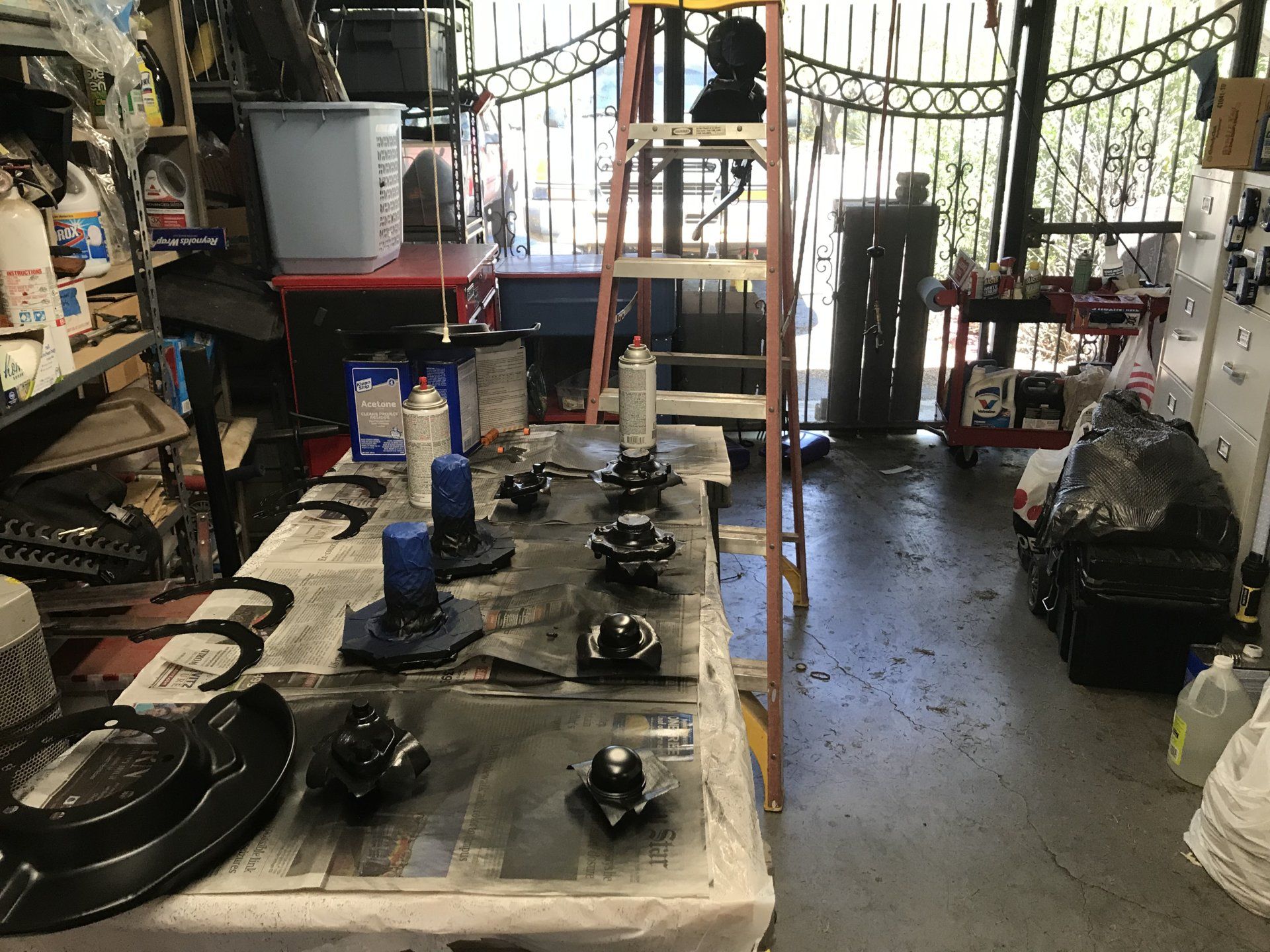

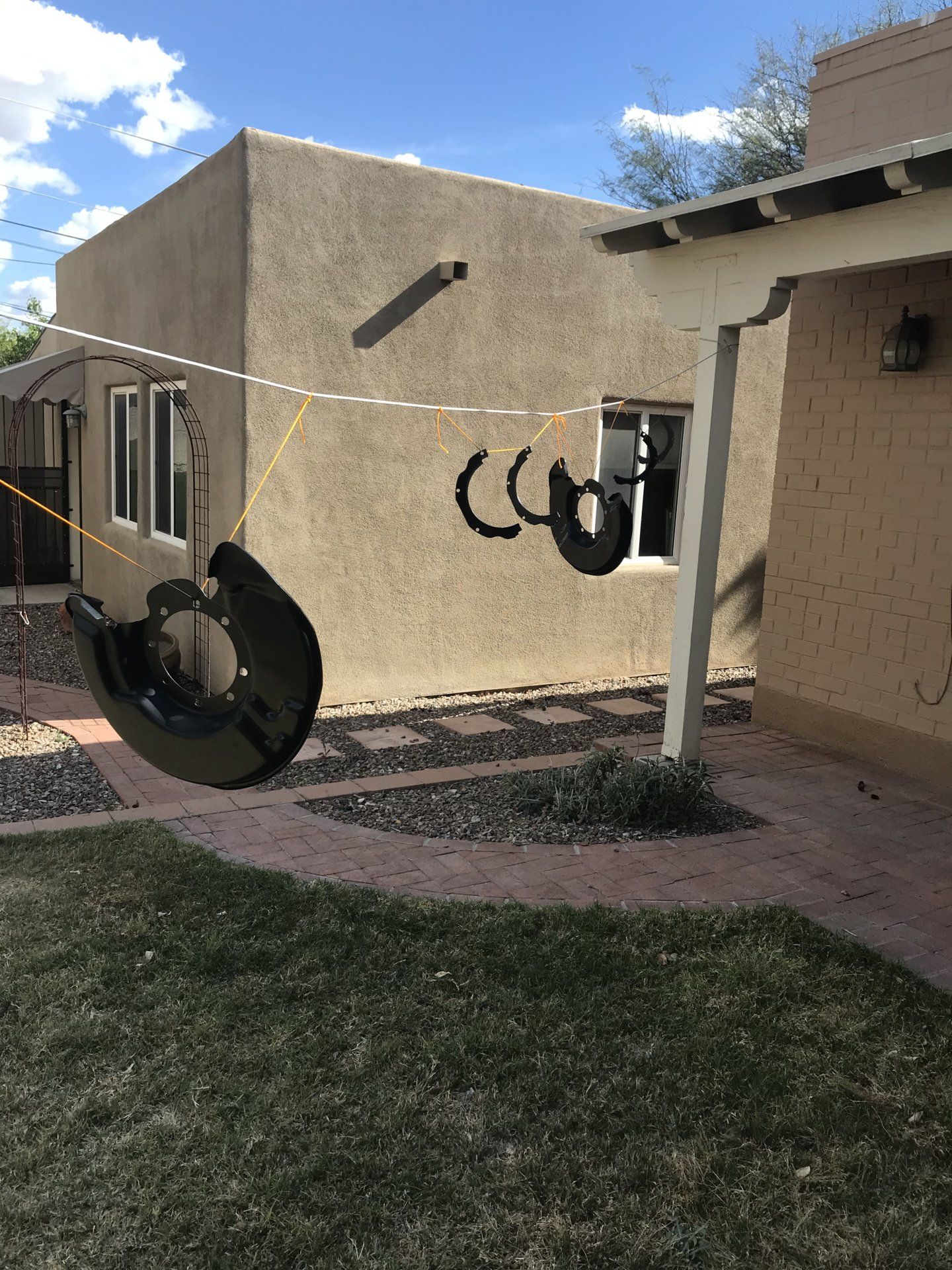

Everything is ready to paint . I just. Need to put up some scaffolding to hang the heavy stuff. Sadly I’m out of time today. I’ll try to sneak away from work early tomorrow and paint tomorrow afternoon.
I started at 8am and finished at 3pm. No way I can make a living doing restorations.
The disc backing plate and felt retainers turned out alright. A couple of drips in places nobody will see until they take it apart. :lol:
All painted and masking remover. I’ll do a few bolts tomorrow and see if I can get this Land Cruiser on the road on Saturday.
