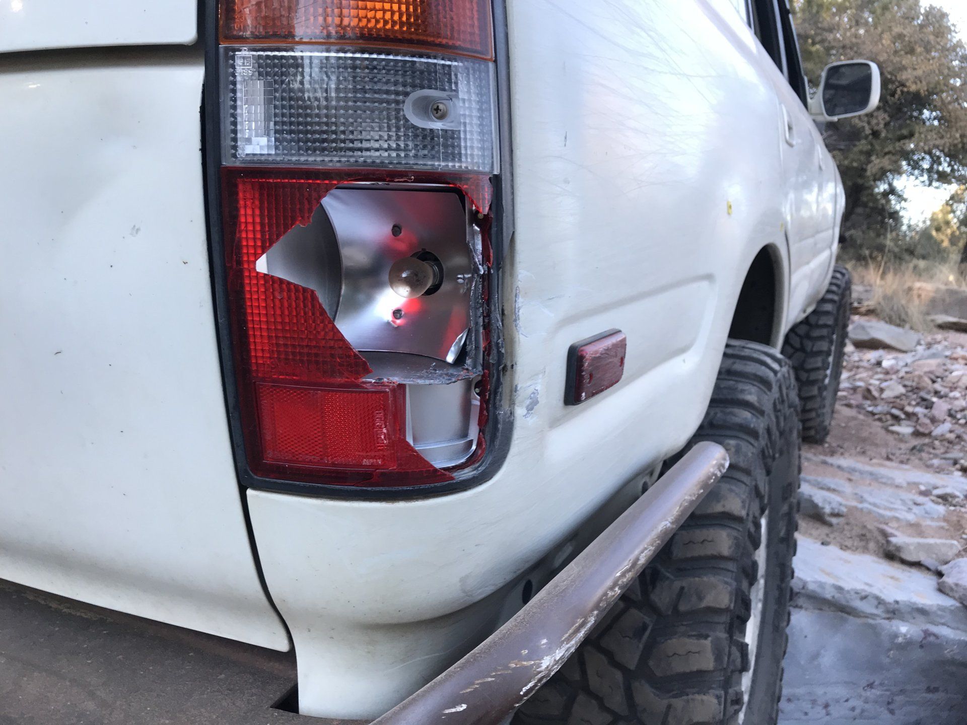

Seriously, this keeps happening and I refuse to hire a driver.
I wish it was just the tail-lite like last time, I had just fixed this side and replaced the lite from the last trail run

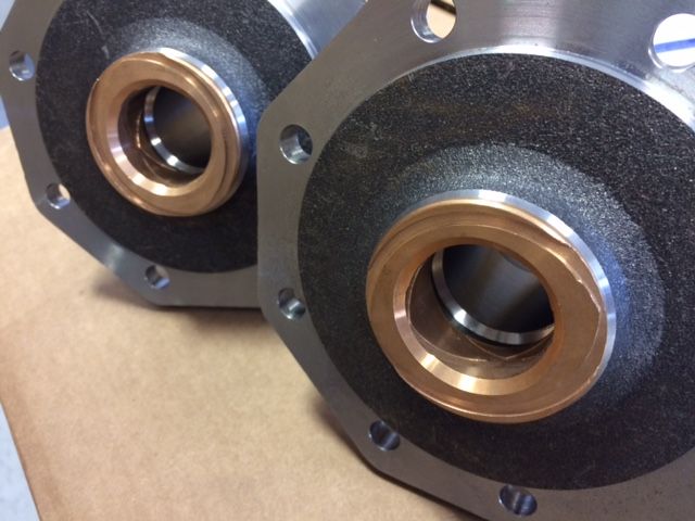

We (Cruiser Outfitters) stock Japanese spindles with the bearing/bushing combo (FA60080 or FA60081OEM if you prefer OE Toyota) and we can assemble with the full length bushing too. Gaskets, shims, seals, etc... we stock it all. Give us a ring if we can help!
Ring done and spindles and brass bushings ordered. I'm starting to be able to tell the difference between Brice and Chris from when I ordered my seals earlier.
Any special tips on pressing out the needle bearings and pressing in the brass bushings?
Here is the special tip for pressing in the brass bushing. CruiserOutfitters called and said they would do it for me. Awesome Kurt!
@cruiseroutfit
...Any special tips on pressing out the needle bearings and pressing in the brass bushings?
Yes, let us do it :D
Eric pressed them out on the press (it does wipe the bearing) and pressed in the full length bushing for you!
@cruiseroutfit
Ha, I just posted the same. We are happy to do it. We've got a puller we modified to tug out that inner bearing.

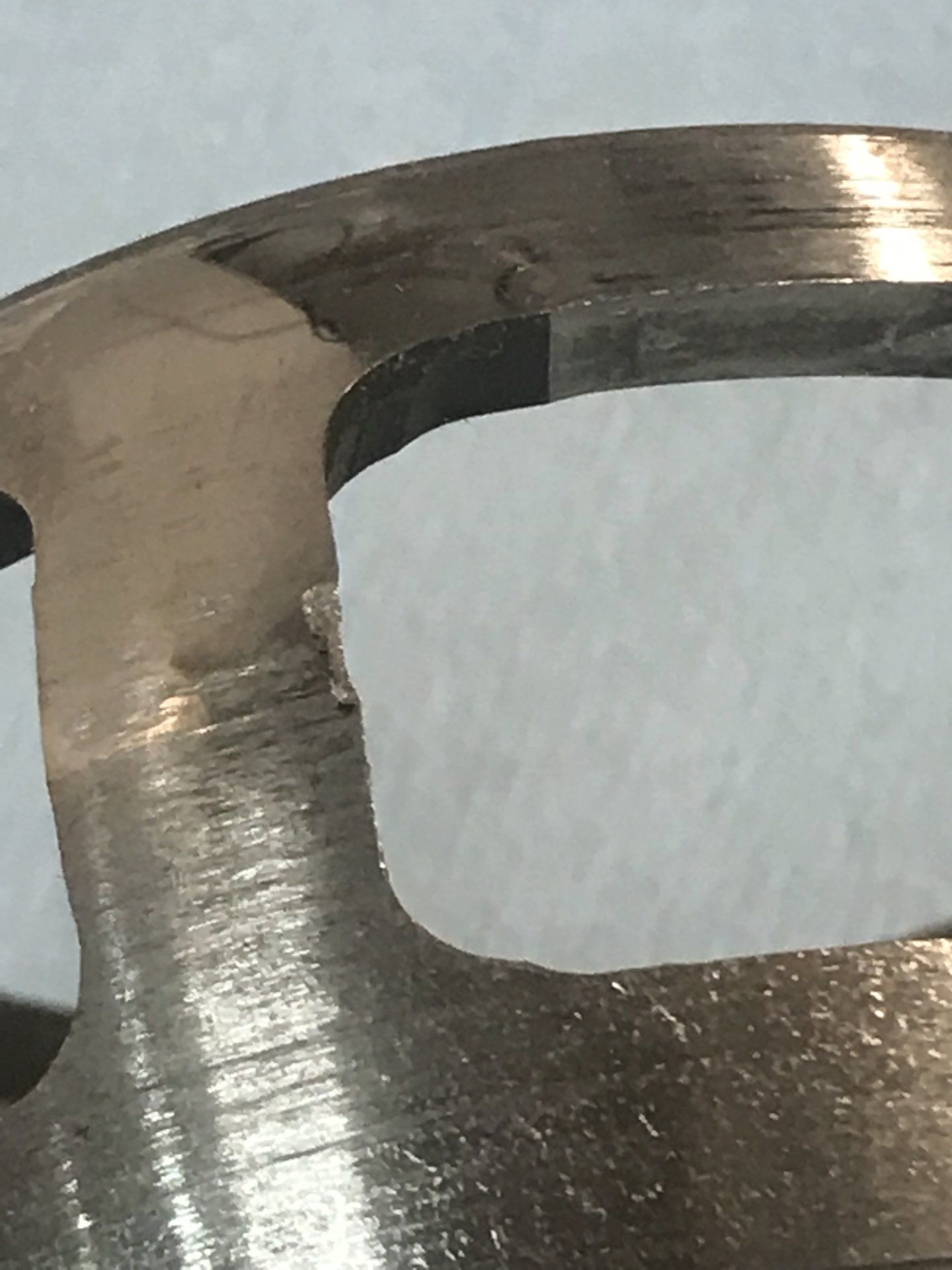

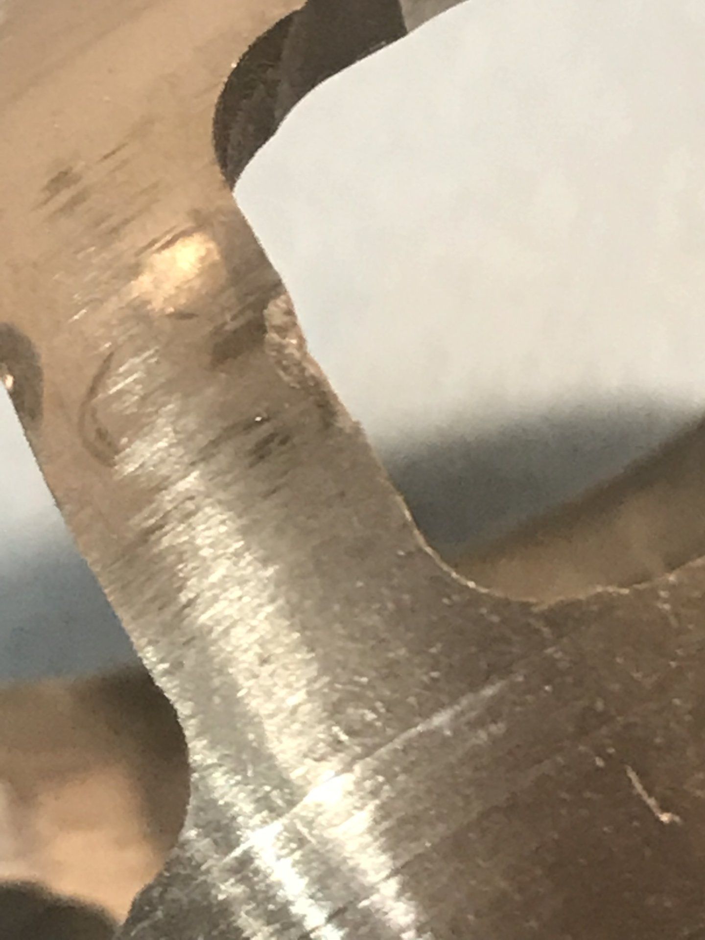

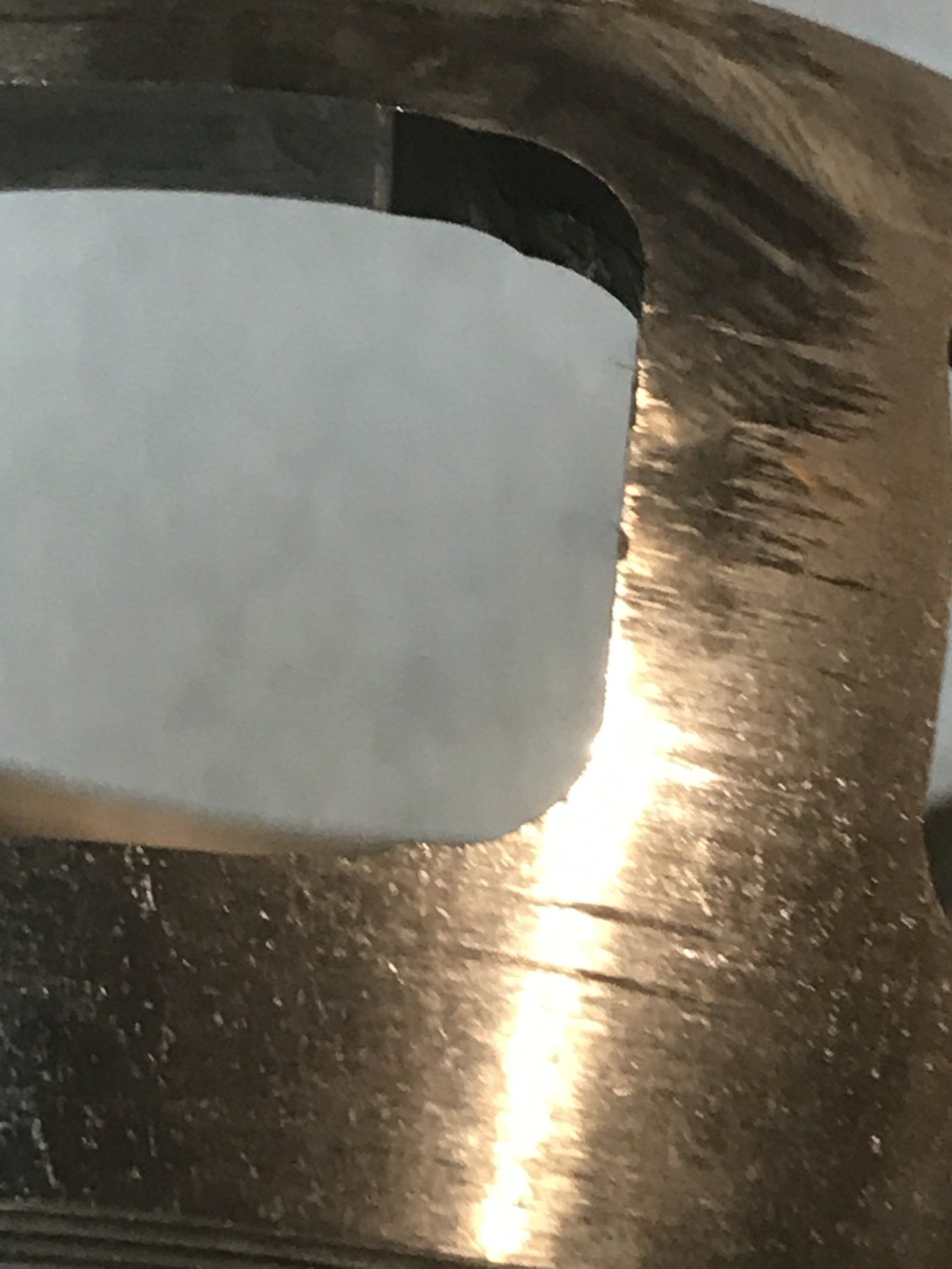

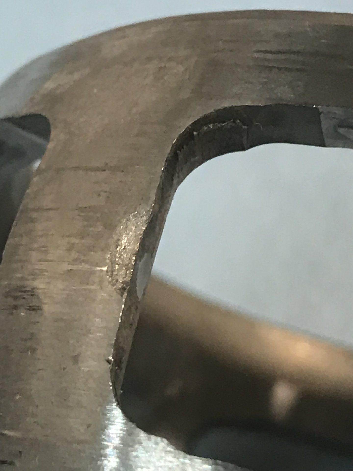

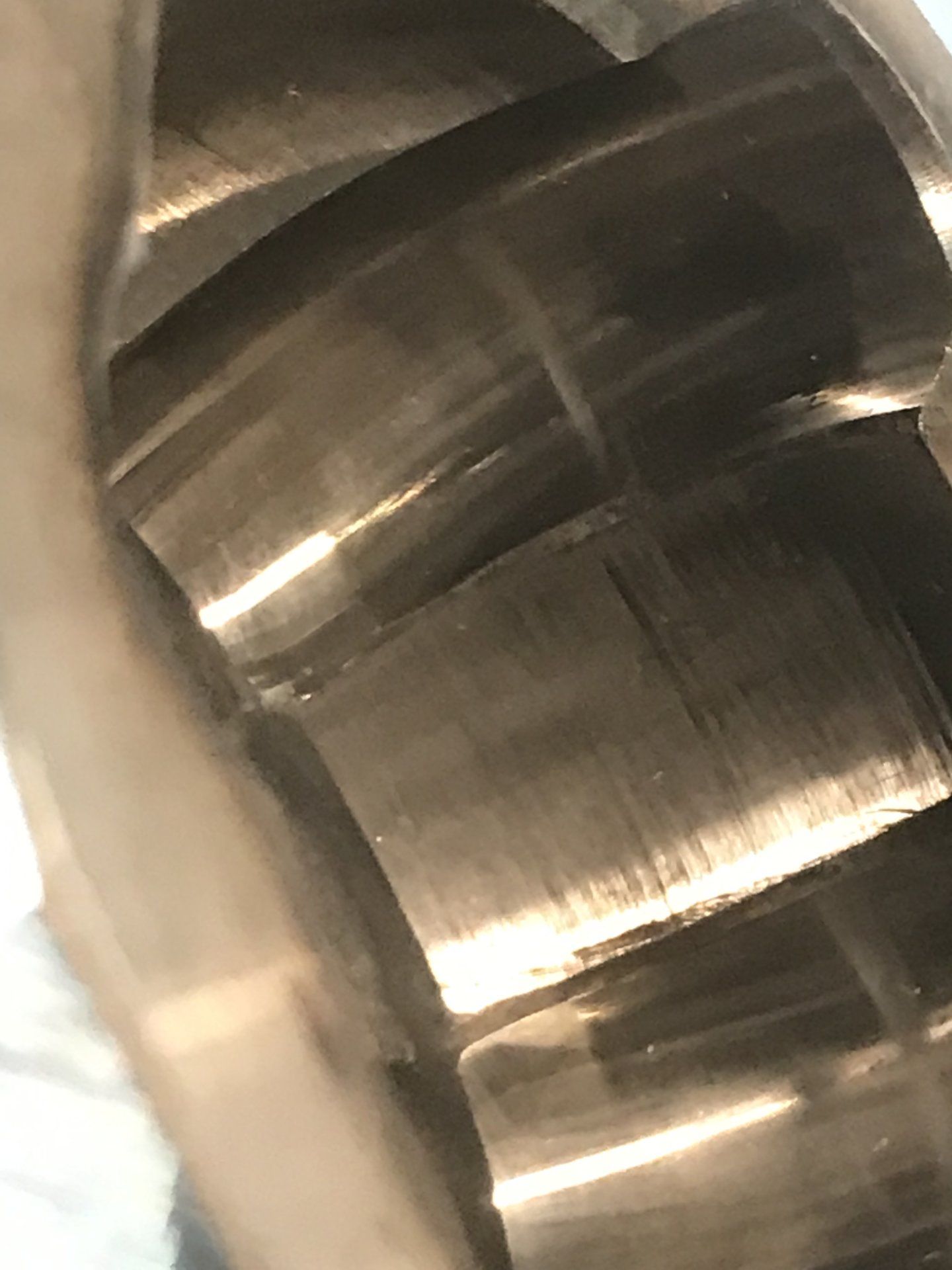

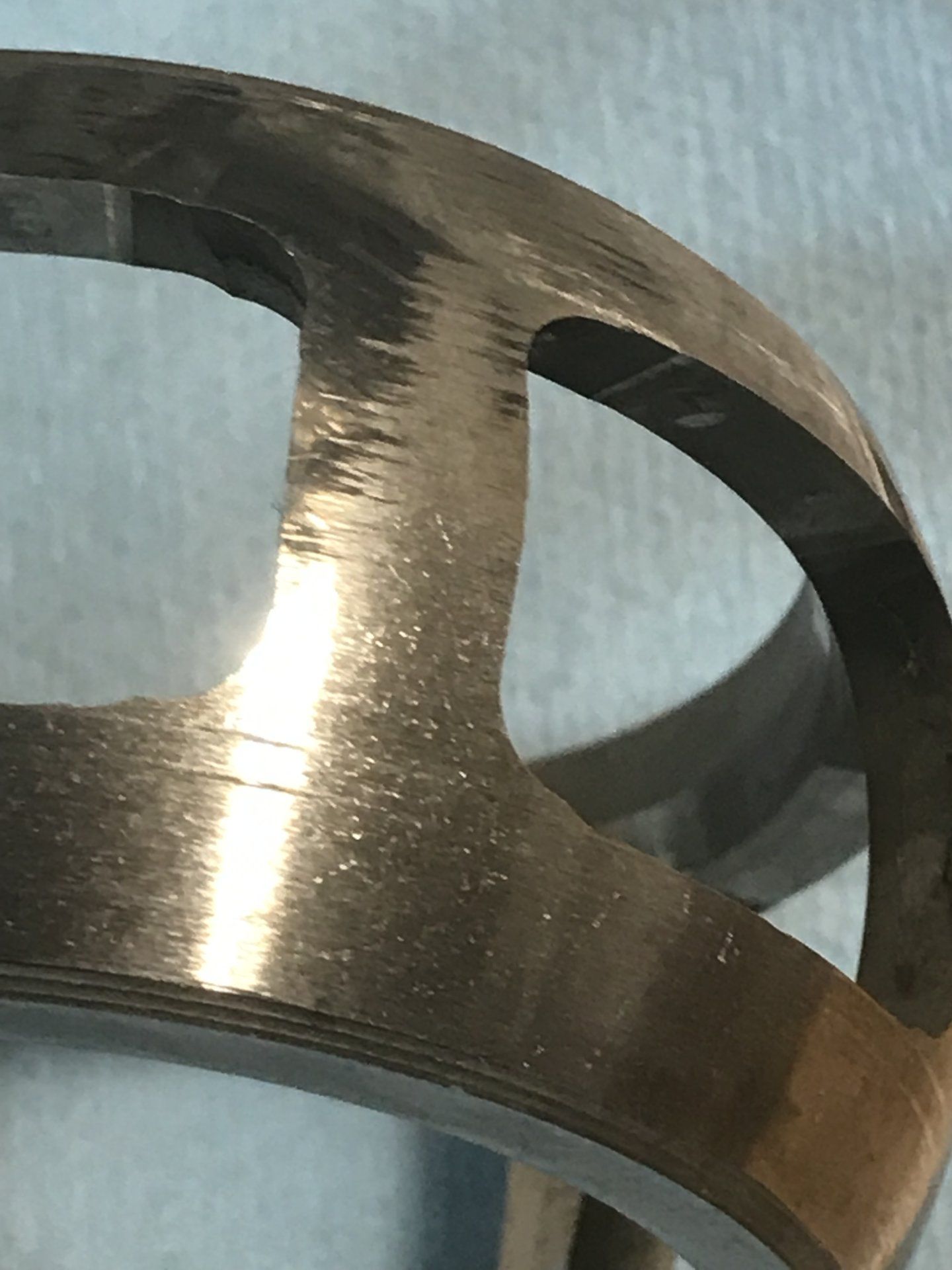

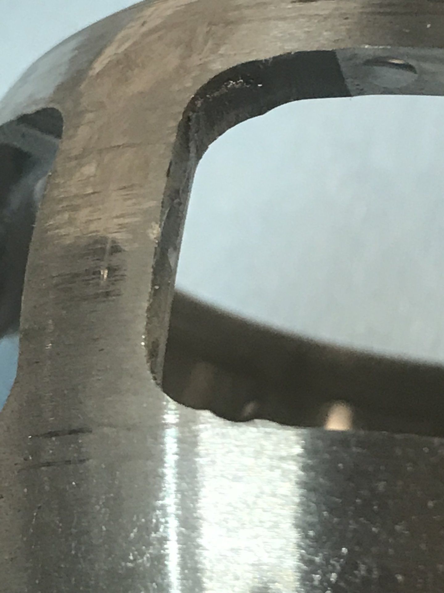

Well poop, my evening is ending on a sour note. My inexperienced eye tells me I need two new birfs. Both have scoring on the cage, the insert and the inside of the tulip. I can feel the ones in the tulip. Can’t feel anything with my fingernail anywhere else. Worse there are chips missing on some of the short sides of the windows in the cages. :sad:
Passenger side
Drivers side
I was hoping to wrap this up this weekend. I guess I’ll have more time for purty-fying.
:hillbilly:
I priced OEM and I nearly shat myself. I’ll see what the reputation is of aftermarket offerings.
I had plenty of grease in there and actually no soup. I had no clicking or other noises either.
