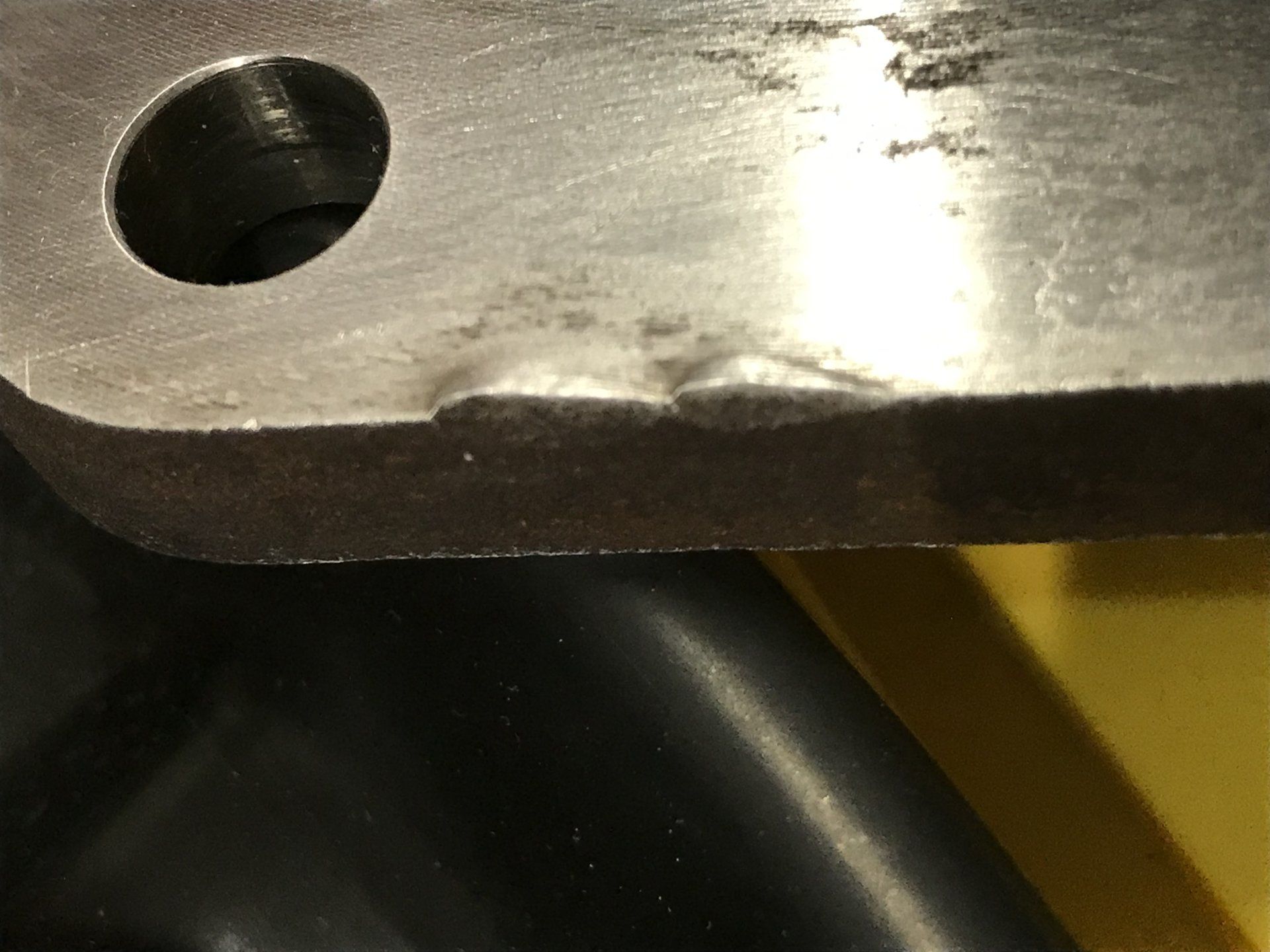

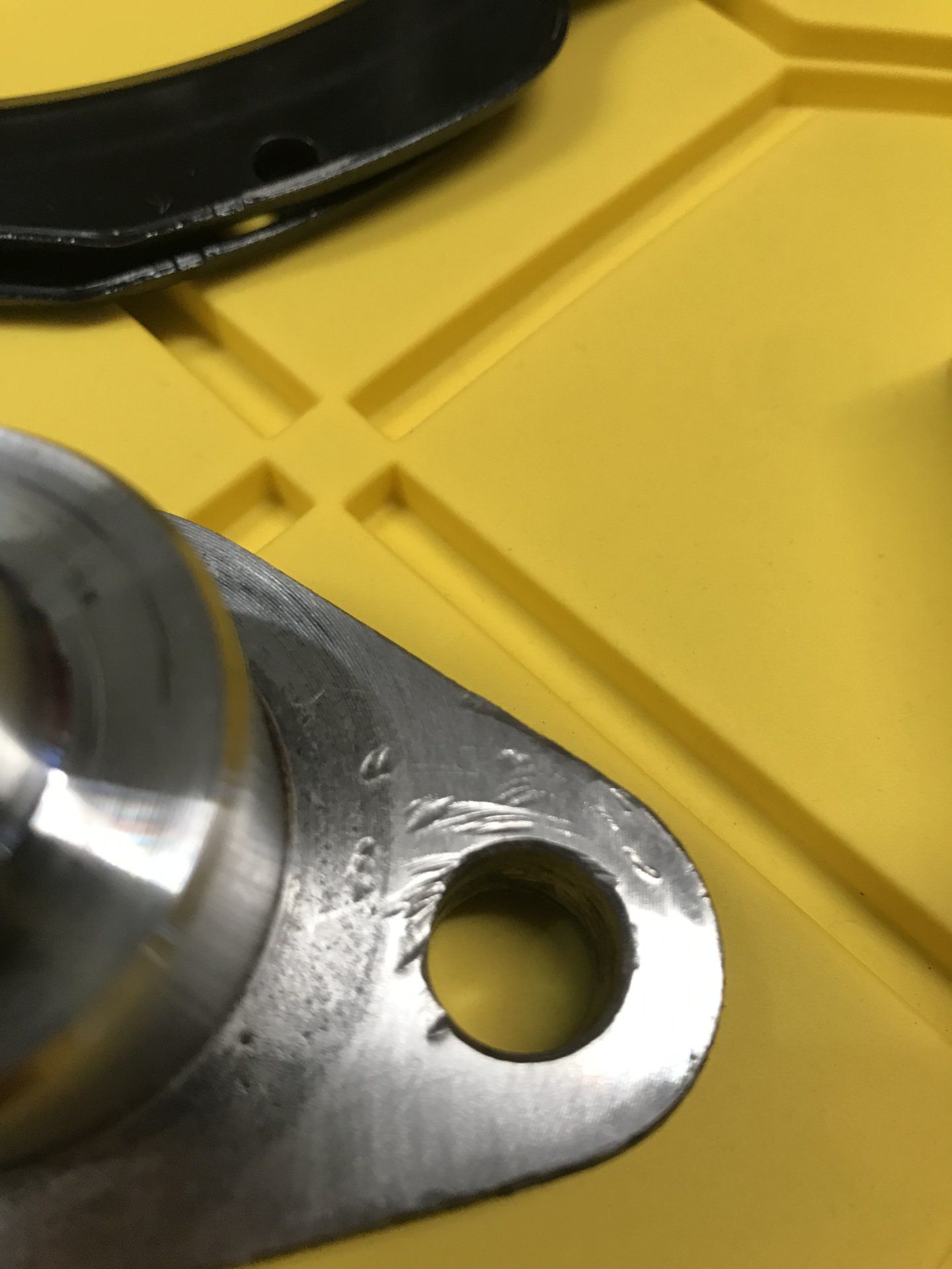

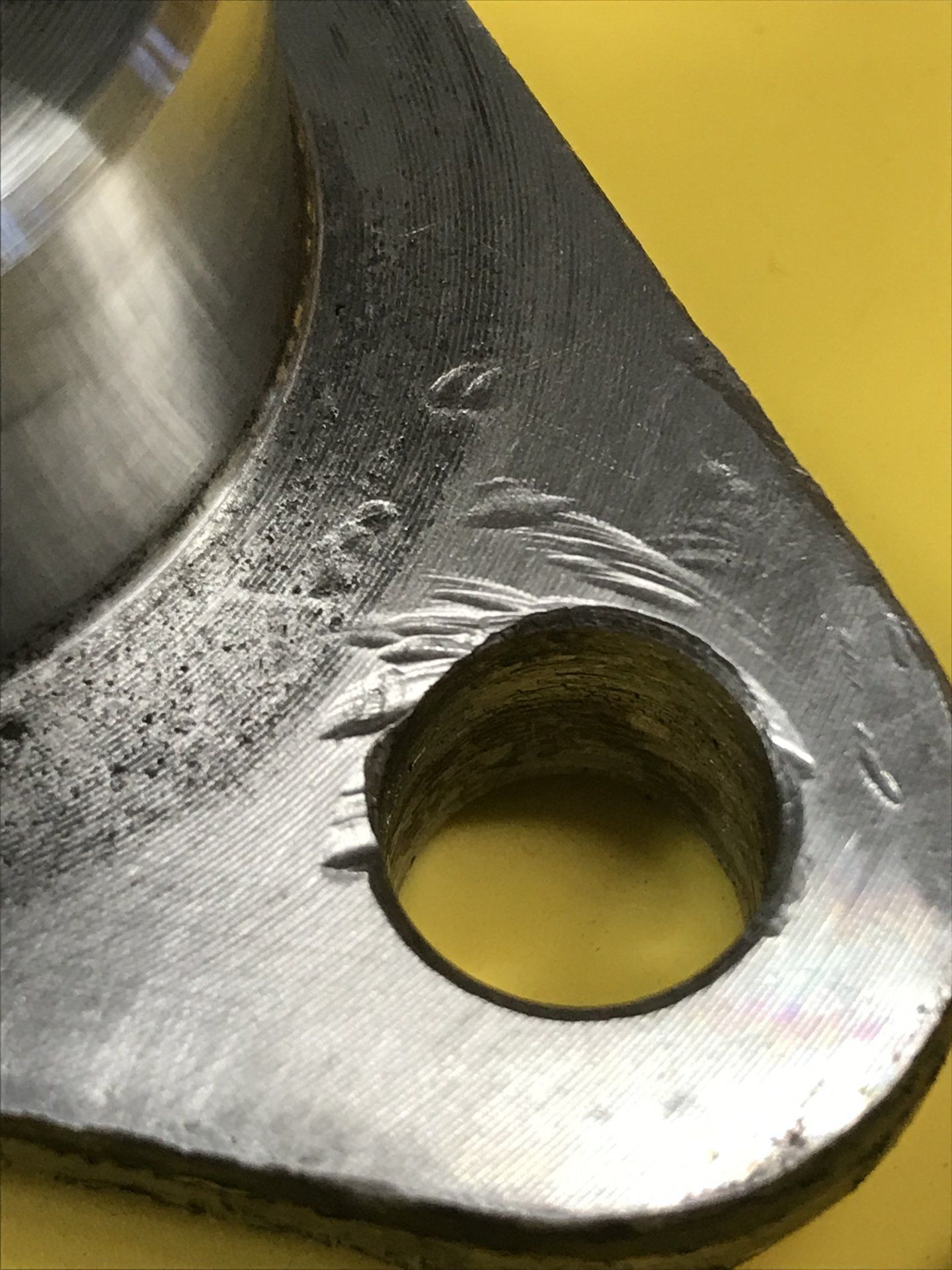

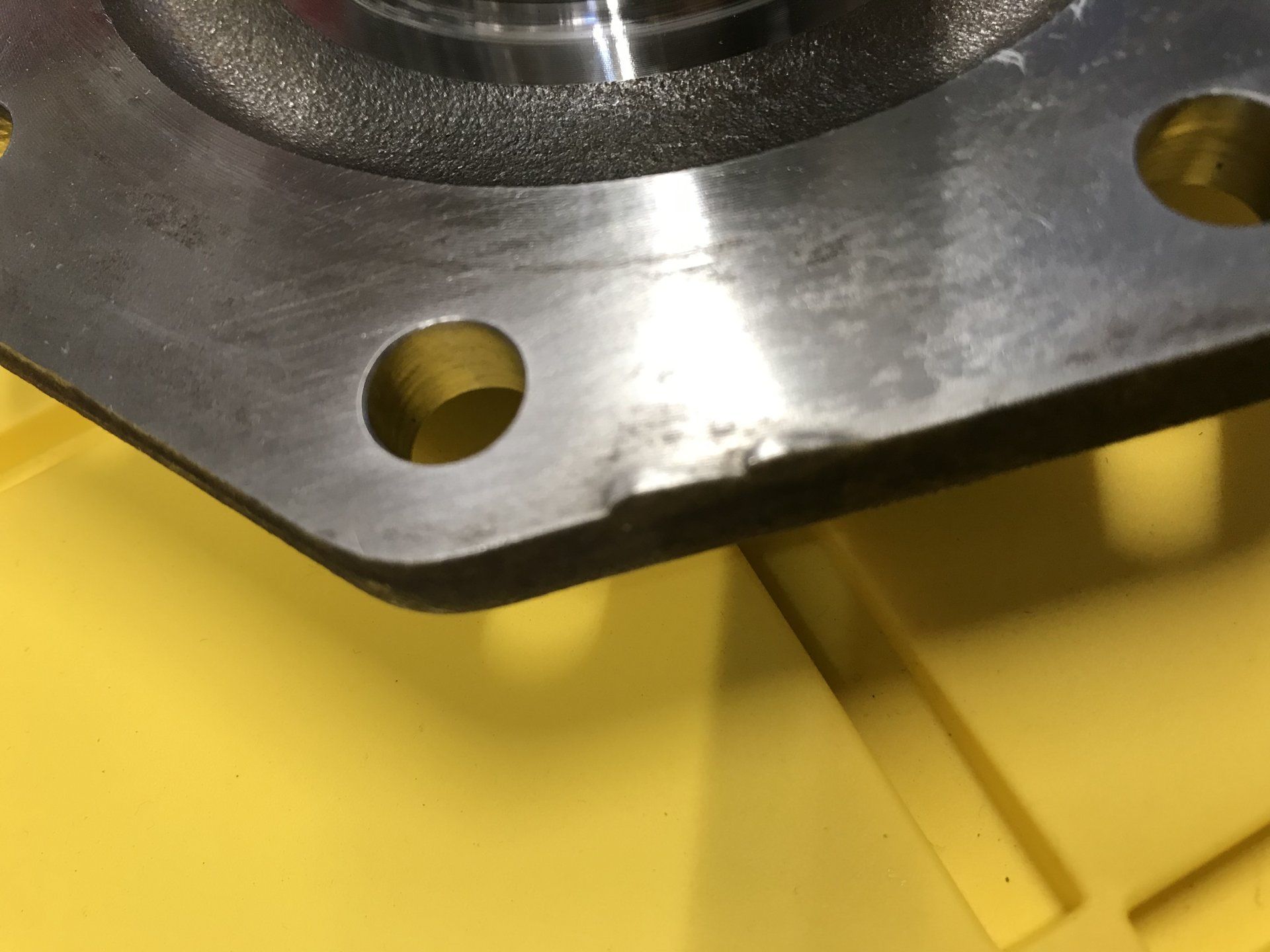

I’m doing front axle seals and while cleaning the passenger side it looks like whoever was in there last was a little rough on things. The damage is on the machined surfaces.
I’m trying to decide if it is not an issue and run them as-is. Should I just debur with a file an run it? Last option i guess is to replace. I’d be nervous about replacing the trunion bearing carrier as I wouldn’t know about preload anymore.

It needs to be flat, the goal is to take off anything that is high, the divots don't matter. Stone or file until it starts touching the surrounding metal and stop. This is more important on the trunnion than the spindle.
What Tools R Us said.
Use a file or a bench stone, either one or both, doesn't matter, just knock the burrs off.
Thanks for all the suggestions. I’m not to worried about fubaring the spindle. I can easily buy a new one. I am worried about the upper trunion carrier. I’ll just be careful.

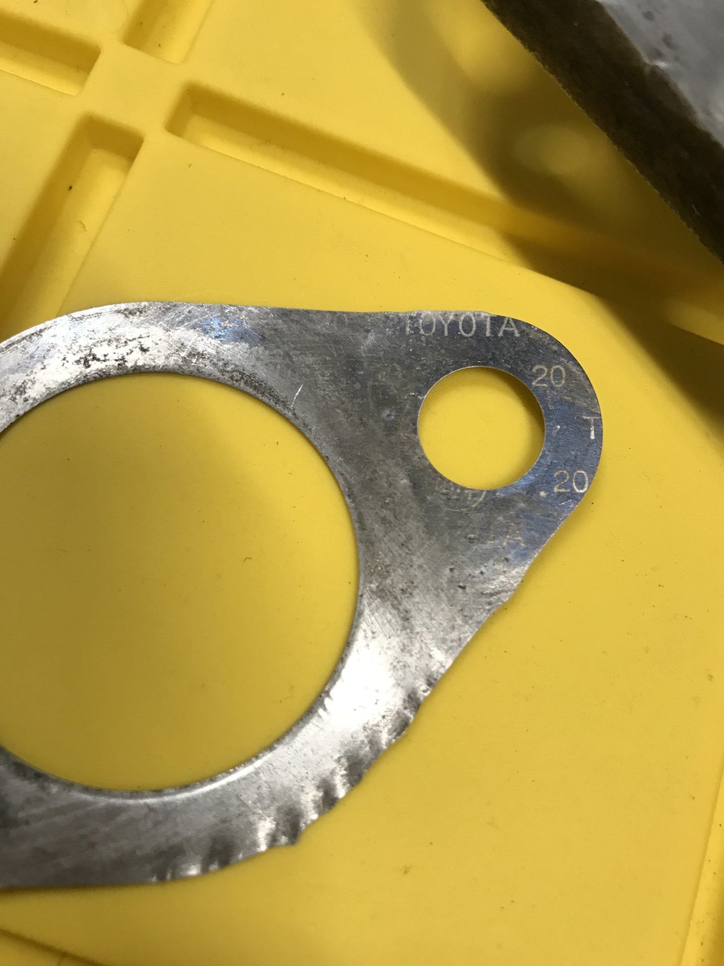

The plot thickens, cleaning the knuckle this evenening I cleaned the trunion shim. It has been rode hard and put away wet. I’m hoping that 20 on it is the thickness and I can buy a new one. Oh well, all these delays will just give me more “excuses” to work in the garage.

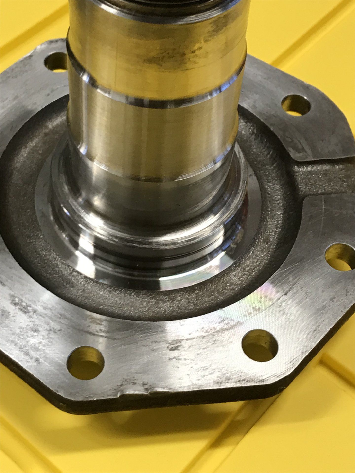

2nd pick looks like were the outer bearing rides is worn to the point I can see a ridge, i would take a close look at that. I replaced both of mine when they look like that and I could feel a ridge in them.

Good eye. I went back and found there are ridges that hang up my fingernail on this spindle and the other side too. Are spindles still available with the brass bushing or they all needle bearings now?

Kurt stocks both.
Kurt stocks both.
Yup!
We (Cruiser Outfitters) stock Japanese spindles with the bearing/bushing combo (FA60080 or FA60081OEM if you prefer OE Toyota) and we can assemble with the full length bushing too. Gaskets, shims, seals, etc... we stock it all. Give us a ring if we can help!
