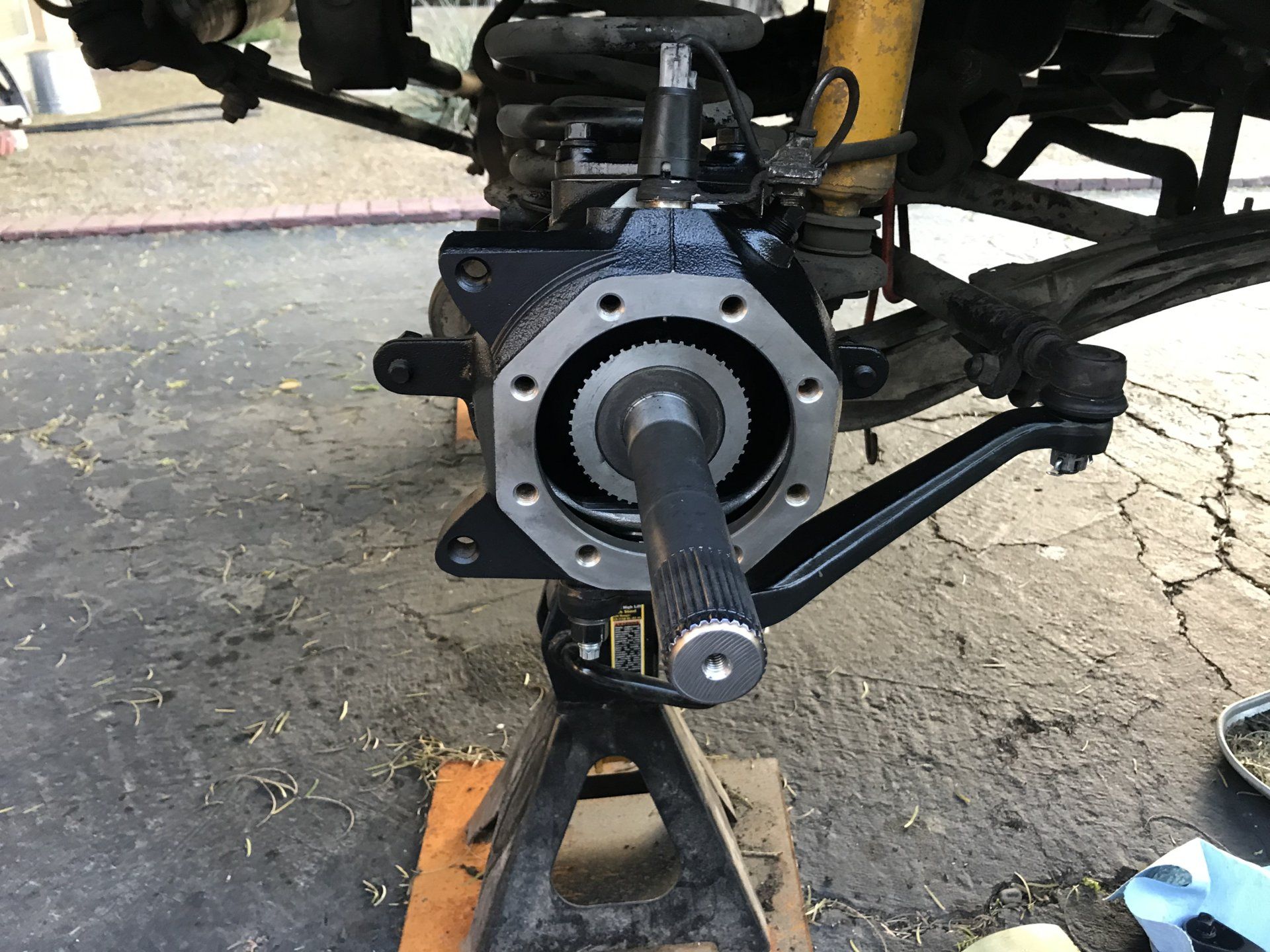

Spindle and upper trunion damage
Don't feel bad, I've done things like that too, although those knuckle housings do have large cast letters on them denoting which side they go on. If you hadn't gotten so crazy with the painting maybe you could still see them. At least they are not packed with grease yet.

You may be on to something on the posting of pictures. I did a search for what happens if you make this mistake. I didn't find anything so either I'm the biggest moron on mud or nobody has ever admitted to doing this and fixed it without consequences. Even though the steering arm is torqued on I'm thinking I don't need to worry about matching races and trunion bearings. I can leave the top on installed on the knuckle for when I put it on the correct side as soon as I can get a replacement axle seal. Both sides used the same thickness shim so no worries there.

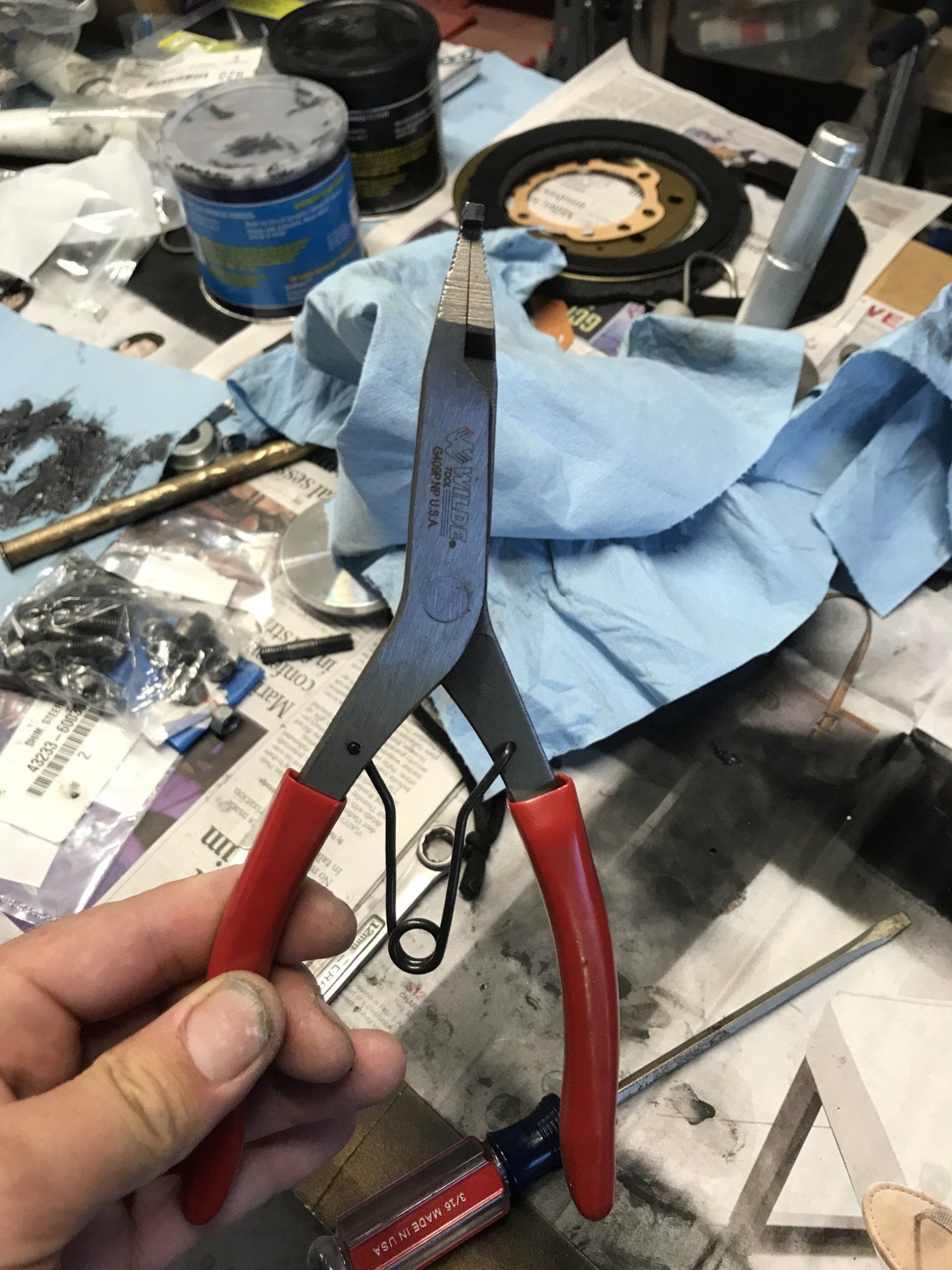

On a side note I did get the c-clip in with a screw driver pretty easily. It only took a couple of minutes.

I’ll leave a picture of my shenanigans and you’ll see why I needed to step back.

Your steering is going to be funny.

Did you pack the trunnion bearings with grease? If not, you need to when you swap sides!

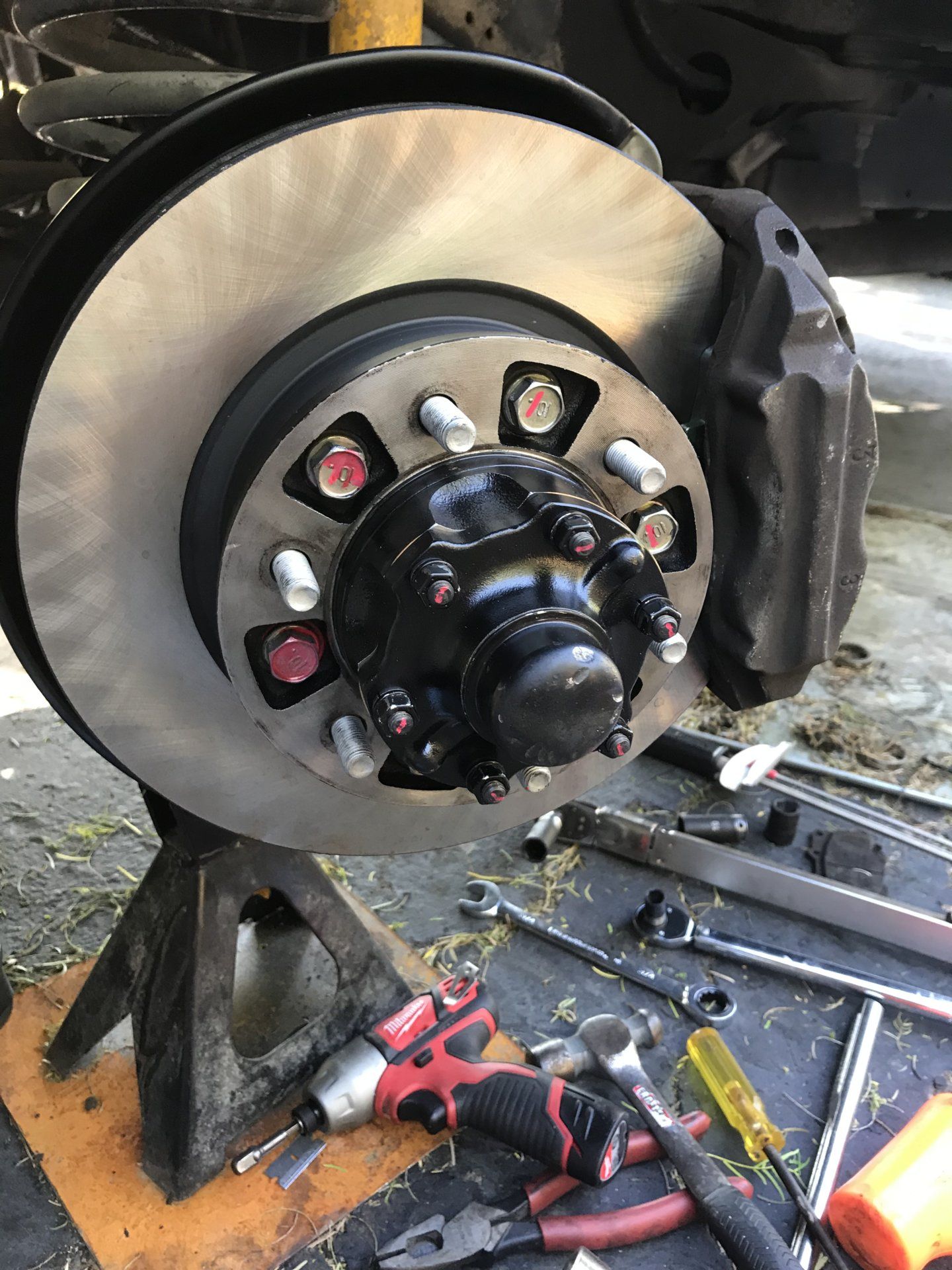

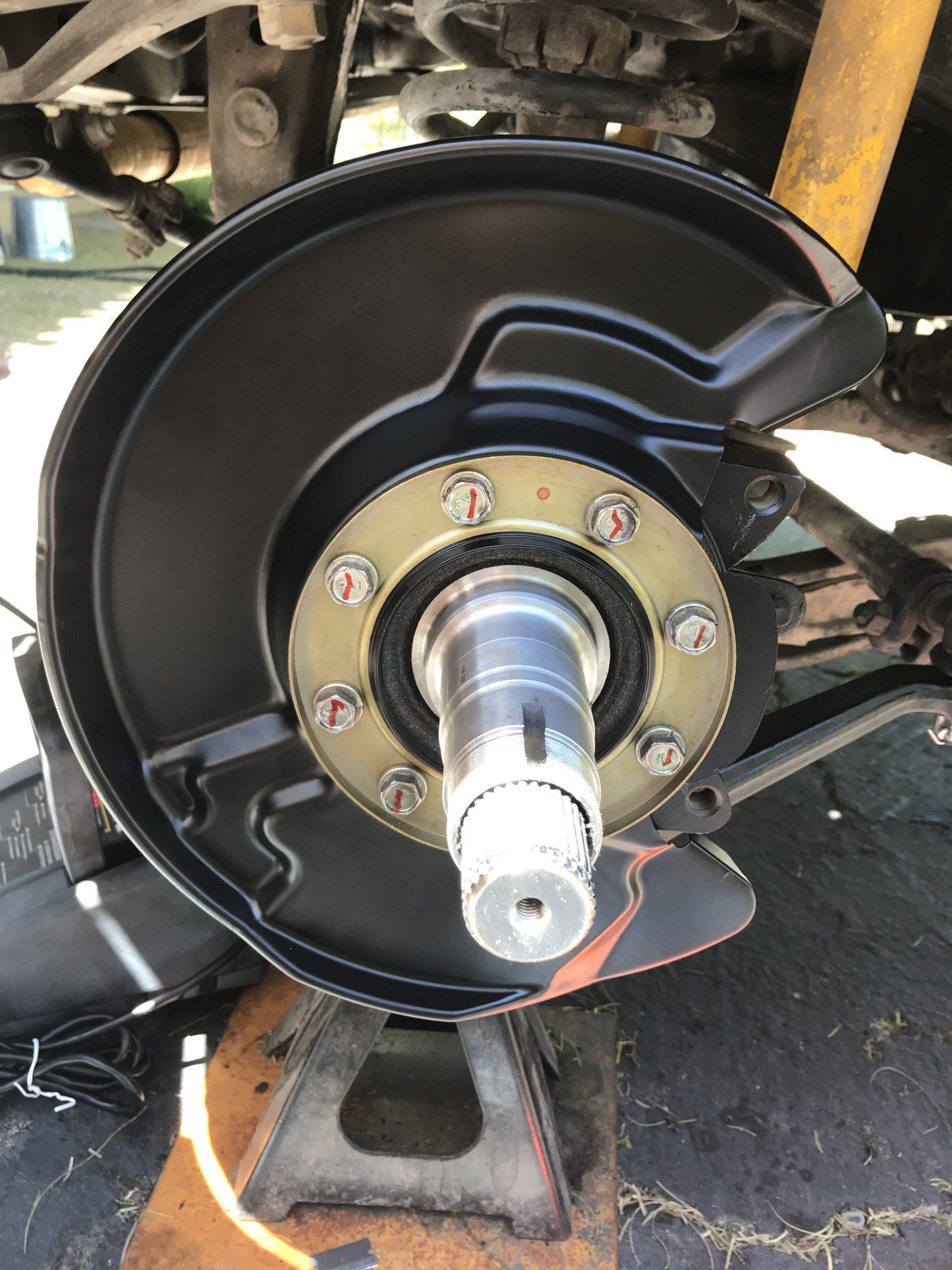

And driver side done. I only had half a day off from my usual chauffeur duties.
Looks like new soft brake lines and calipers are next. Brake lines are stiff and cracking. The pistons on the caliper looked a bit cruddy and were harder than normal to retract.
New tool I love? The c clip pliers recommended by @Tools R Us USA made and only $16. Took 3 seconds to install.
