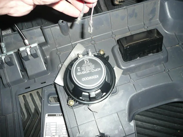

This is about the dash speakers.

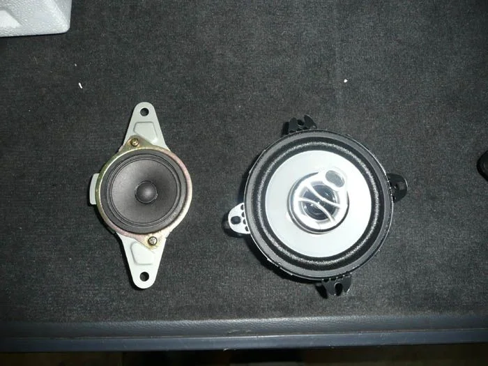

In the first pic, you can see the size difference in the stock speakers and the Kenwood 4". I looks like the dash grill is designed to use 4" speakers. Whey they didn't I have no idea. The 4" speakers fit perfectly on the driver's as you can see in pic 2 and bolted right up. I used some foam to keep the speaker stabilized so that it won't rattle, since only two screws only holding it in place.

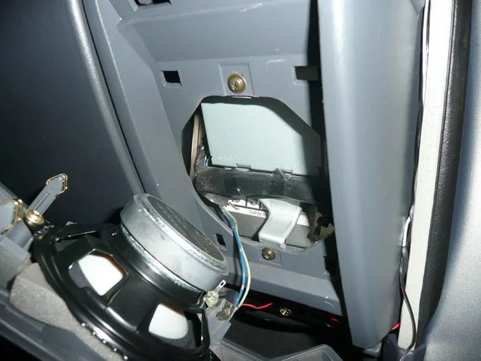

The problem came in the passenger side. The dept is too shallow thanks to what I think the factory stereo amp behind the speaker. I didn't have time to pull the dash apart, but I'll have to see if I move the amp back or relocate it to fit. For now I had to leave the stock speaker in place on that side.

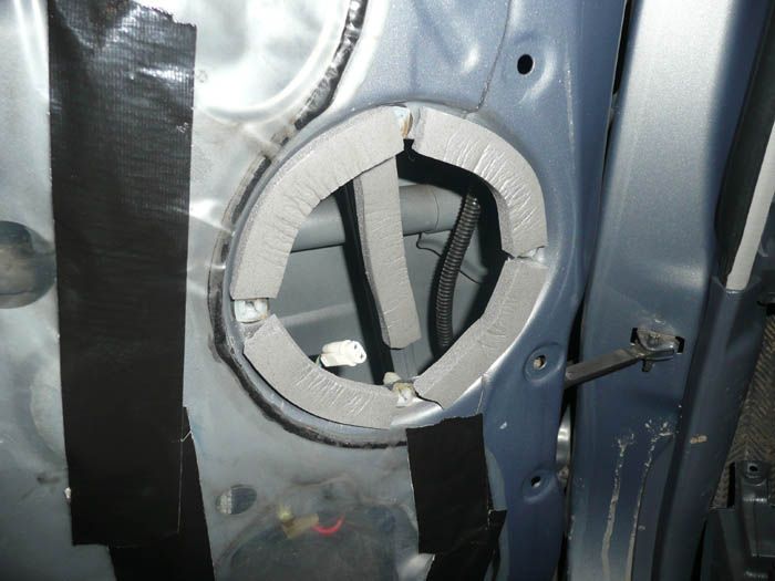

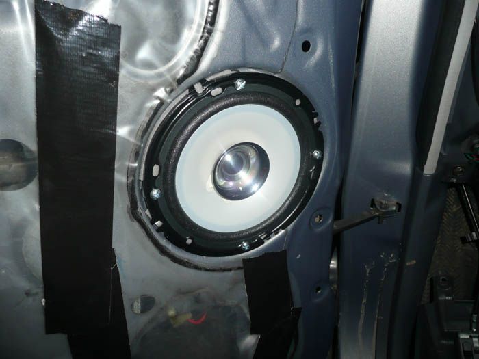

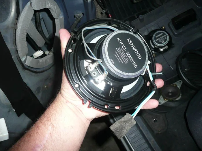

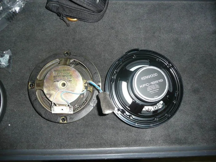

The front speakers were a little easier than I thought they'd be. I purchased spacer rings, since I figured they'd be too long, but I didn't need them.
I put some foam on the metal bar behind the speaker, because I knew the speaker would end up making contact here. I also added some foam around the speaker edge. There's about a 1/4" gap, which the foam helps to take up, while also providing cushion for the speaker.
When cinched down, the panel and stock speaker grill fit perfectly. I ended up cutting the wires off the stock speaker and soldering them into the new speakers wiring so it would plug in like stock.
Pic 1 shows the stock speaker and how thin it is with its unique design. You can also see the bar (window run) inside the speaker that prevents using a deeper speaker. Pic 2 and 3 shows the stock speaker (left) and Kenwood 6.5" (right).

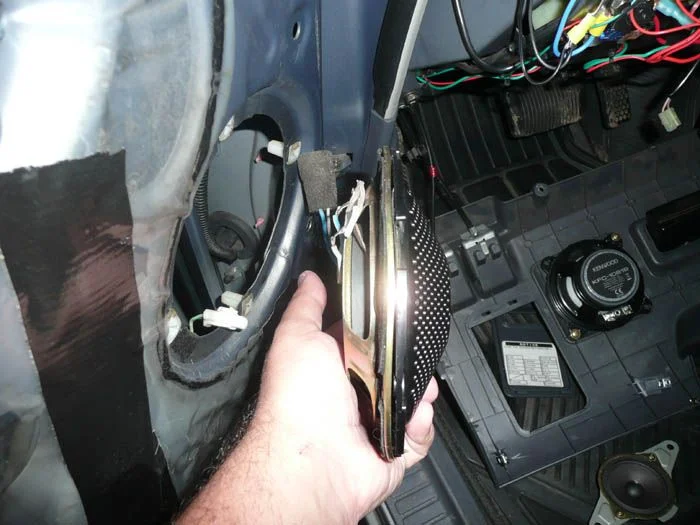

Pic 1 shows the factor wire soldered into the Kenwood speaker.
Pic 2 shows the foam in place on the window run and around the speaker well to act as spacer and cushion for the speaker. It bolted in place using the stock holes, but I had to use longer screws.
Pic 3 shows the speaker mounted...pretty much hassle free.

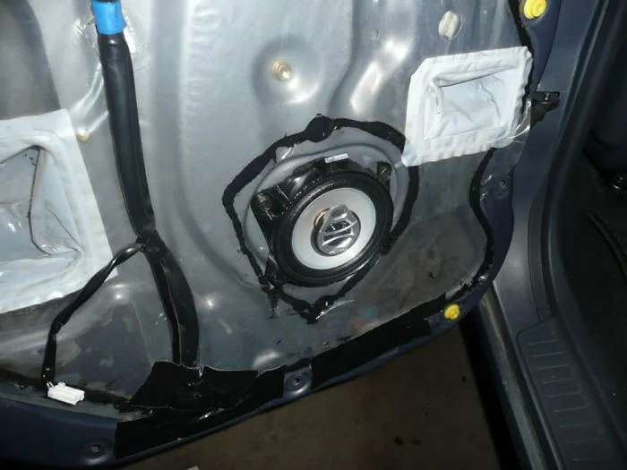

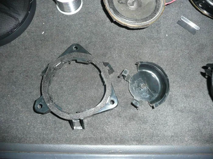

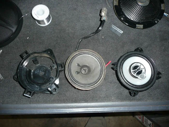

The rear door speakers required a little bit more work. I'm not sure upgrading them is even worth it, because it doesn't sound like they put out much output, but I did it anyway.
They using a unique speaker cup that the factory speaker bolts into and then that bolts into the door. A 4" speaker fits perfect, except it is slightly too deep for the cup. So I cut the bottom part out. Then glued the new speaker to the cup (the factory grill also helps to hold the speaker in place) and bolted it back into the door. I also soldered the factory wire harness to the new speaker wire harness.
Pic 1 shows the stock speaker cup, the stock speaker and the new Kenwood 4" speaker.
Pic 2 shows the bottom part (right) cut out of the speaker cup (left) so that the Kenwood would fit.

Pic 1 shows the new speaker glued (well actually black RTV'd) into the speaker cup.
Pic 2 shows the new speaker mounted into the rear door.

Take a look at the PS dash mount before you get too far into the project. It is very tight in there. The OEM amp sits right behind the speaker -- and the speaker is much smaller than you'd think from looking at it without the dash apart.
Of course you can remove and ditch the OEM amp. But there are several other ECU boxes back there, so you'll only gain so much room. Not saying a 5" speaker won't go, just that it will take some design and work. It's not a R&R type of project, which most of the rest is.
