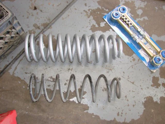

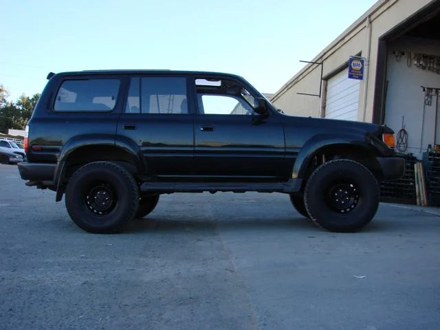

I put a slee 4" lift on my '95 along with some 315 BFG AT's on FJC steelies. The most difficult part was the camber correcting plates & grinding drown just the right ammount on the stock mounts to get them to fit.
Here's the before and after hub - flare measurements:
Before:
DS Front: 19"
PS Front: 19.5"
DS Rear: 20"
PS Rear: 20.5"
After:
DS Front: 24.5"
PS Front: 24.5"
DS Rear: 25.5"
PS Rear: 25"
I'm really happy with the end product, now I just need to get some weight on the truck to get rid of the bounce. It no longer sloshes around the corners.

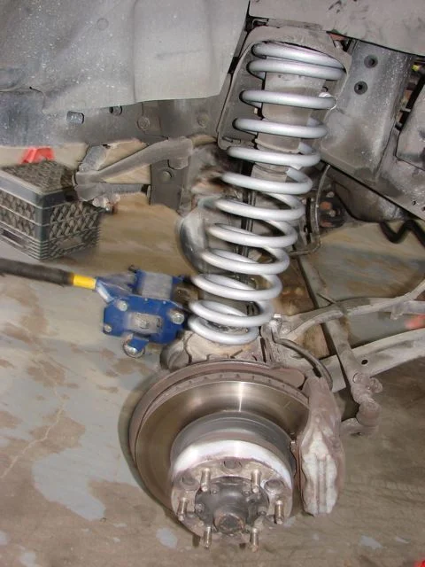

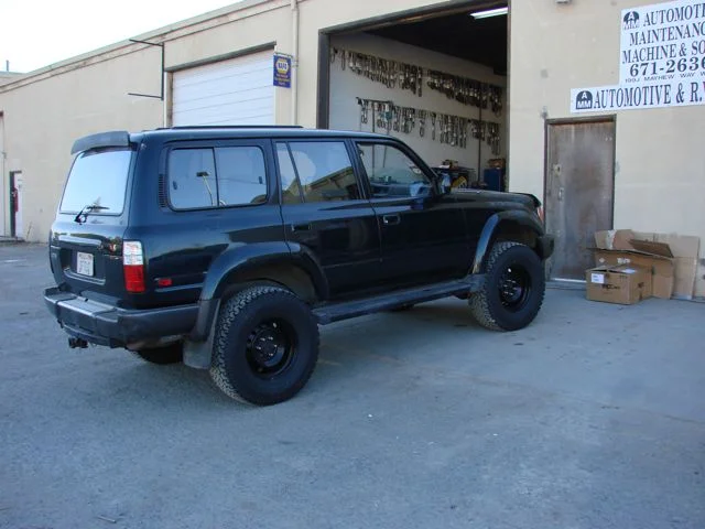

More pics:

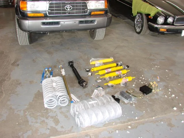

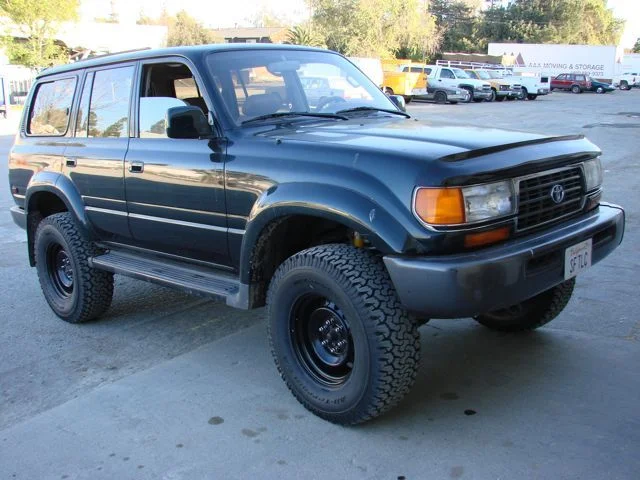

Finished pics:

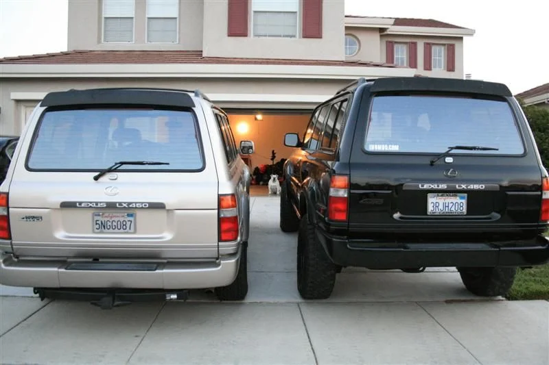

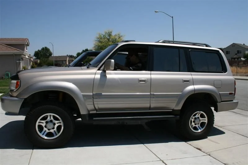

My buddy and I just finished his rig today
Sanchez is offline   Reply With Quote

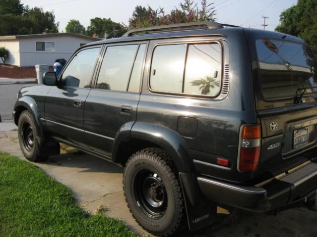

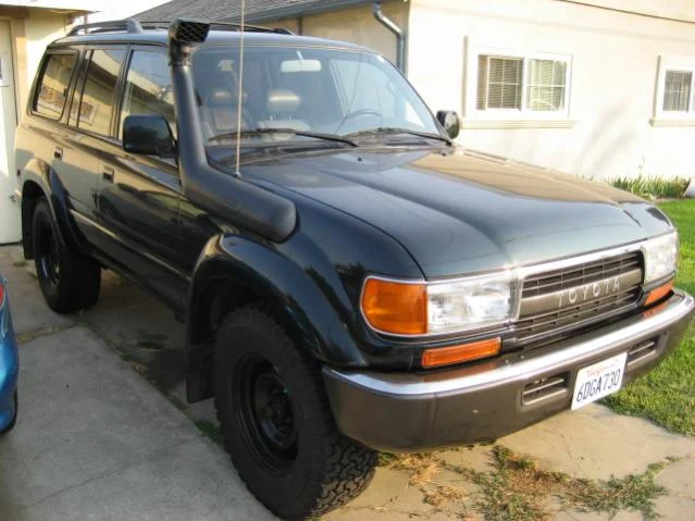

wow 4inch lift and 315's and black steelies looks awesome. Here is mine stock stock height with 285's

Love the FJC steelies. Here is a pic of mine.
Sid
