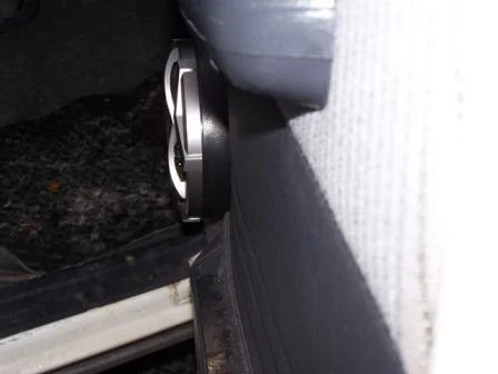

I had to use 1" shims on mine... Got them from Crutchfield for like $12 shipped. I have a full Kicker sys in my 89 and it sucks kicking those $200 a pair speakers when I get out. Doesn't seem to happen when I open the door all the way. Pics as soon as I figure out how.

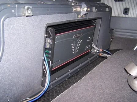

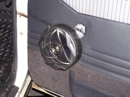

Pic of my sound sys install. We'll see if it worked. I didn't use irfanview... The work computer wouldn't let me. The hole in the door was from the previous sys, the dumb a$$ had tweeters there.

interesting amp location
did you do that yourself? have you tried sitting on the seat above it? how about heat, there can't be much circulation down there.
I just put in a new front speakers in the front doors of my 60. I used 5 1/4 panasonics and have no issues what so ever.
Yes I did it myself... It took a little longer than planed, but its worth it. I haven't had any problems with the heat, but it hasn't been in that long. There is like 3" between the bottom of the amp and the floor and the seat still folds down, which was a big deal to me. The seat is a little more firm now, but it feels fine. I've had 2 big guys back there just to see what would happen and it was solid.:beer:
