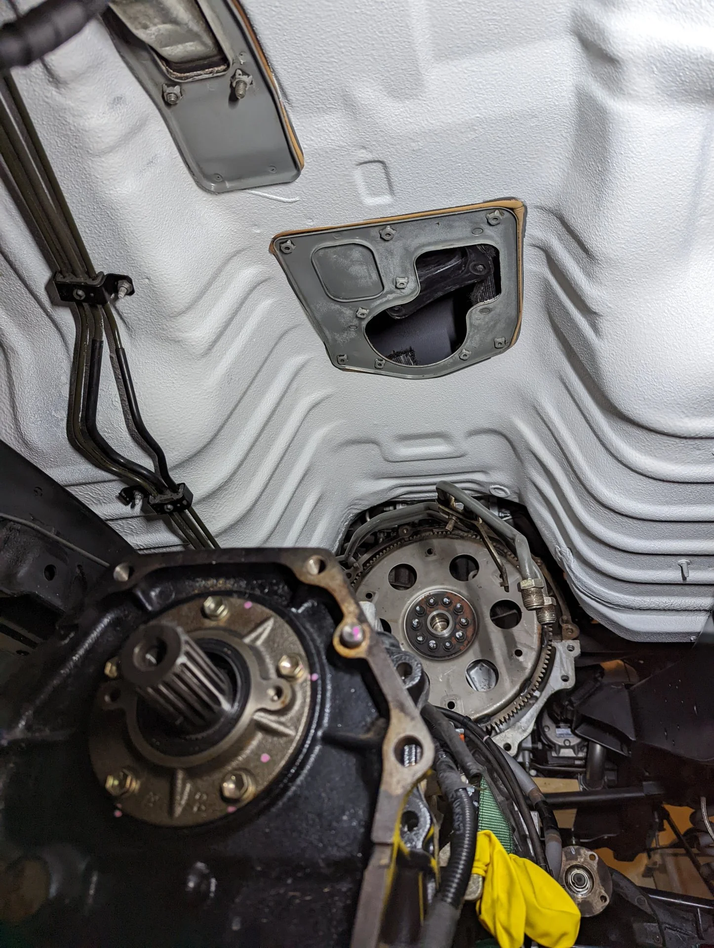

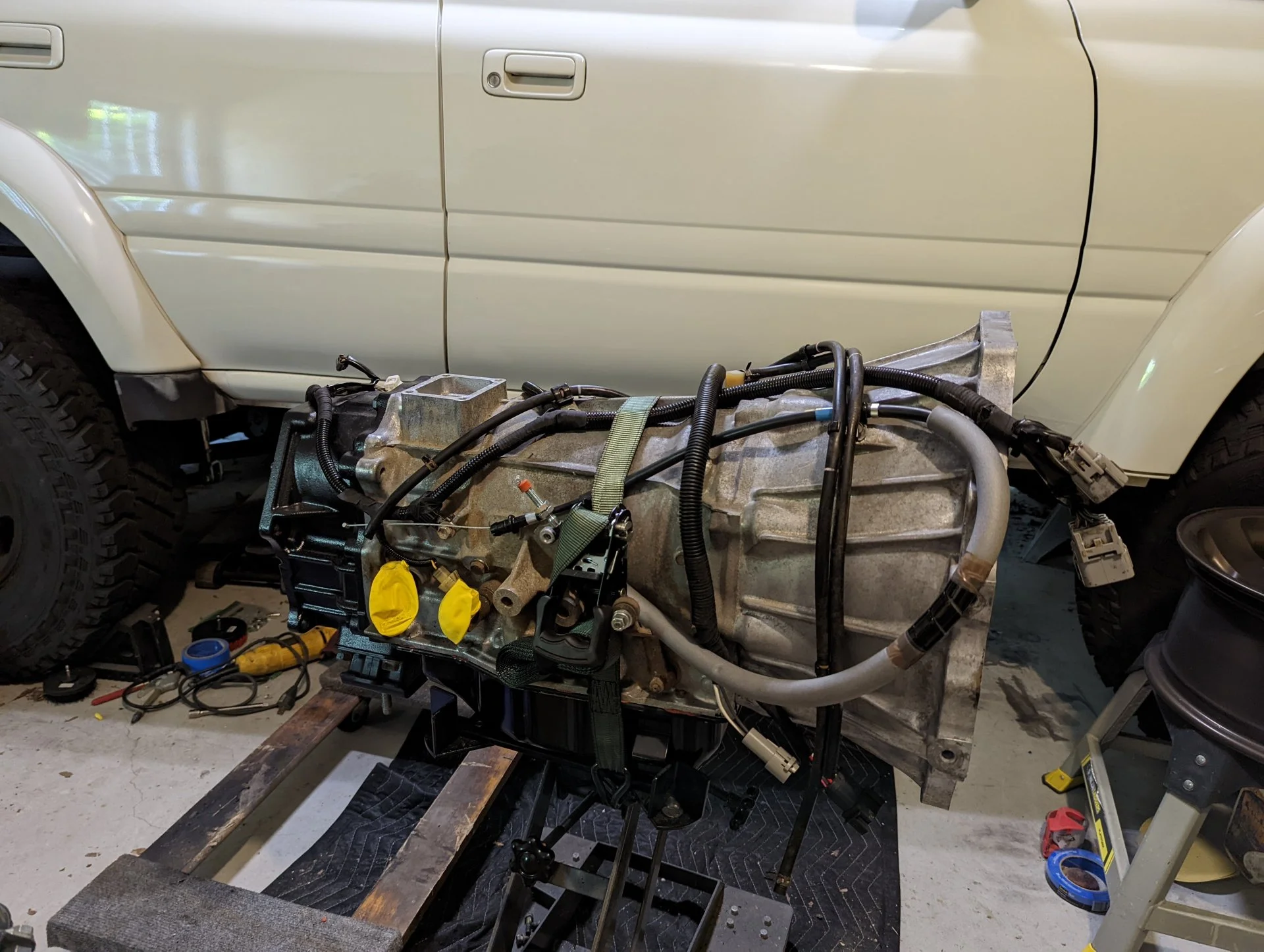

I have been dreading this... The tranny and transfer case were miserable to remove, and I have heard they are worse going back in. I decided to put the transmission back in without the transfer case, which I'm not quite finished with. With the Harbor Freight transmission lift, the now clean working environment (the truck anyway, the garage is still a cluster) and a bit of luck, it was no problem. Probably the easiest I have ever done, and I can bench press (well, I used to could anyway) old Datsun transmissions.
And yes, that is a new seal.

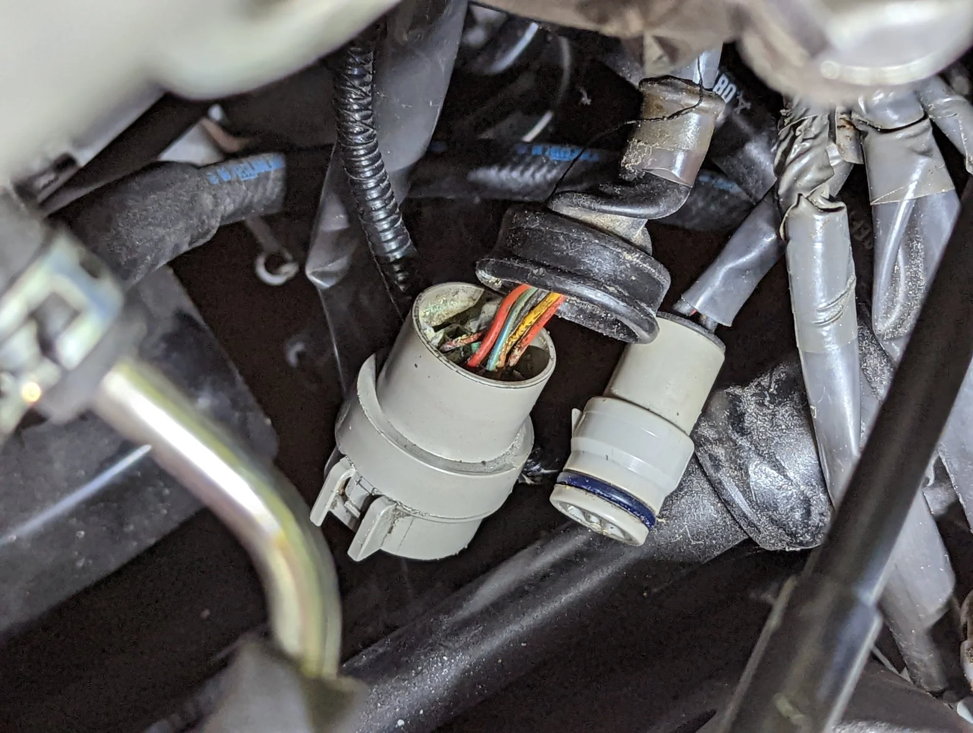

Edit, I almost forgot, because I ran in to this before pulling the transmission, but go through the harness while you are in there. My transmission harness was in far worse shape than my engine harness. Clean, re-loom, replace any broken connectors (almost all housings are still available from Toyota). No D light, or PRNDL at all ? Now's your chance.
^^this. I had a nasty connector between my NSS and harness. No PRND2L, no reverse lights, no gear holding in 2 or L. These connectors are all now soooo old and have been beat to hell in many climates. I Would absolutely inspect/ replace/ re-pin all my harness connections if I pulled the trans or the engine.

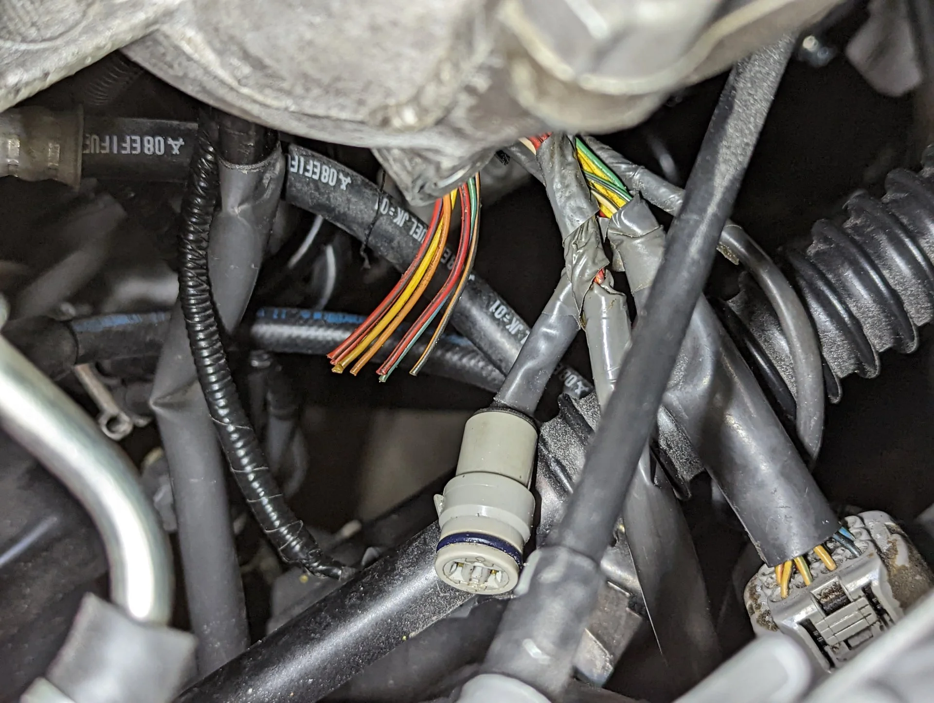

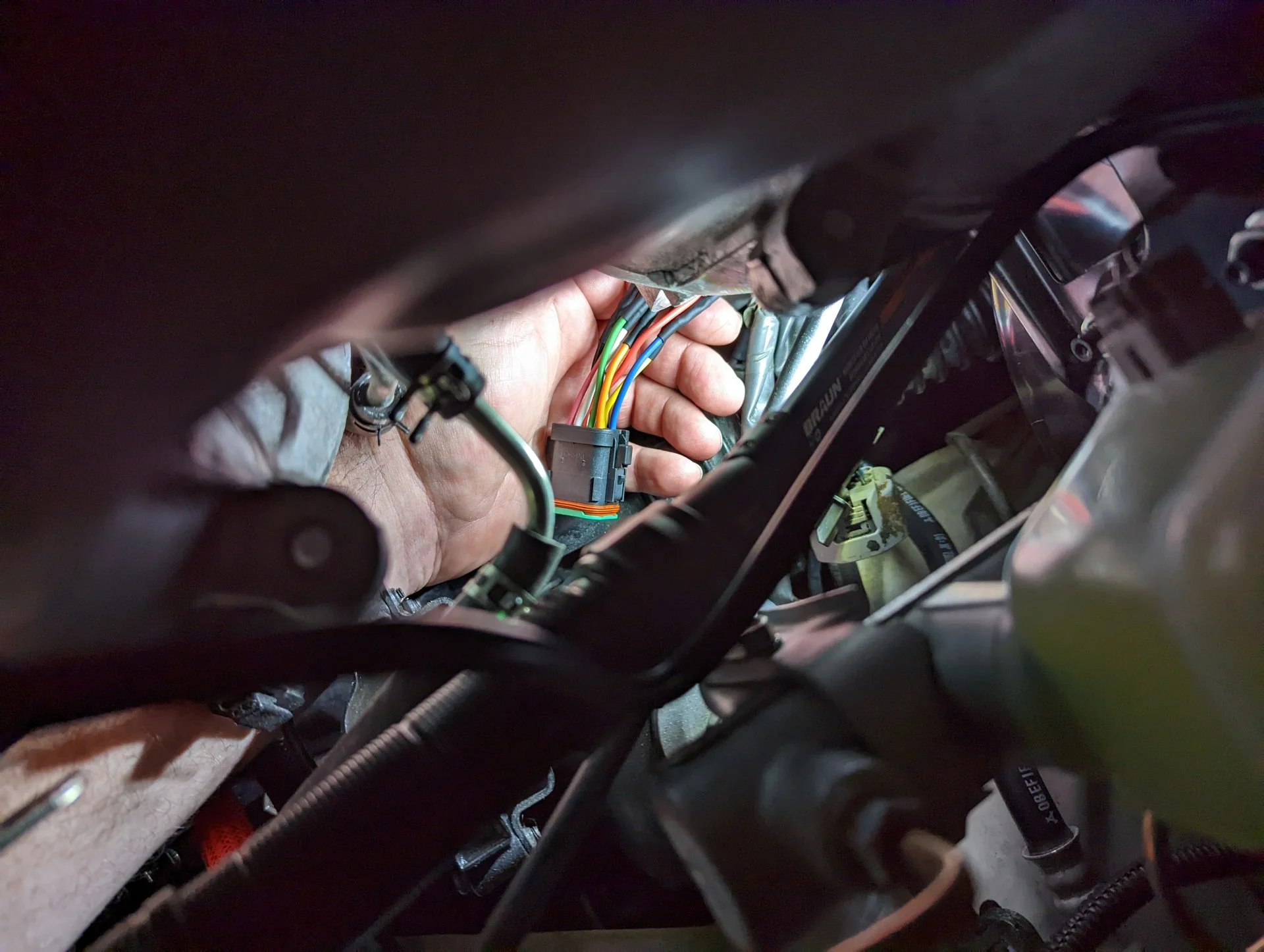

Following up on those tranny connectors.... It would have been 10X easier doing this while the engine harness was on a table a while back, but... I missed it. So, I'm playing operation from the top. This is the connector @PNWTreeOctopus is talking about above. If there is one corroded connector on your 80, this is probably it. Horrible location, and a joke of a condom protecting it.
So, bye....
And replaced with something better. Which one of these things is not like the other.... Which one of these thigs does not belong... ?
And the flex shot....

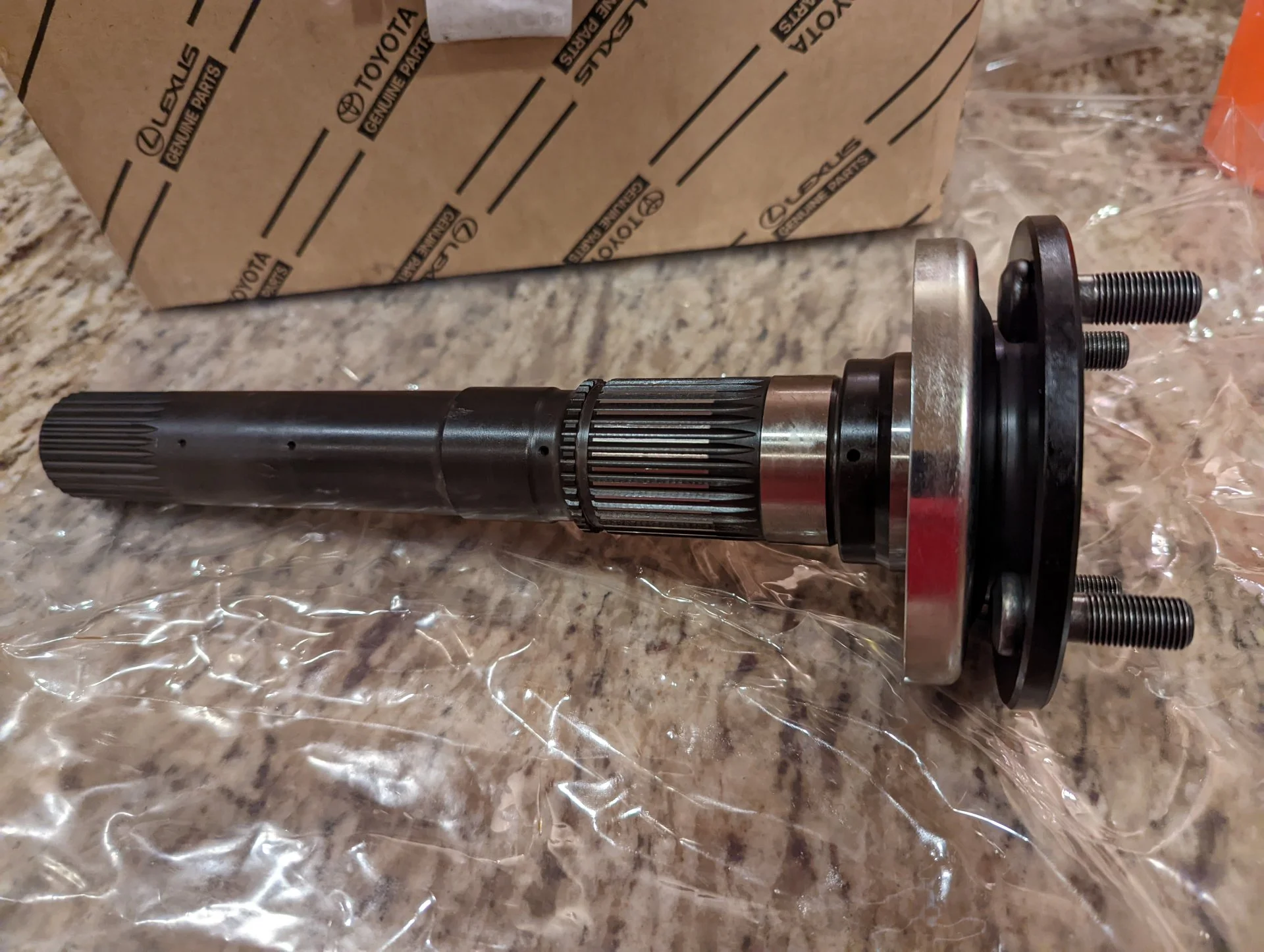

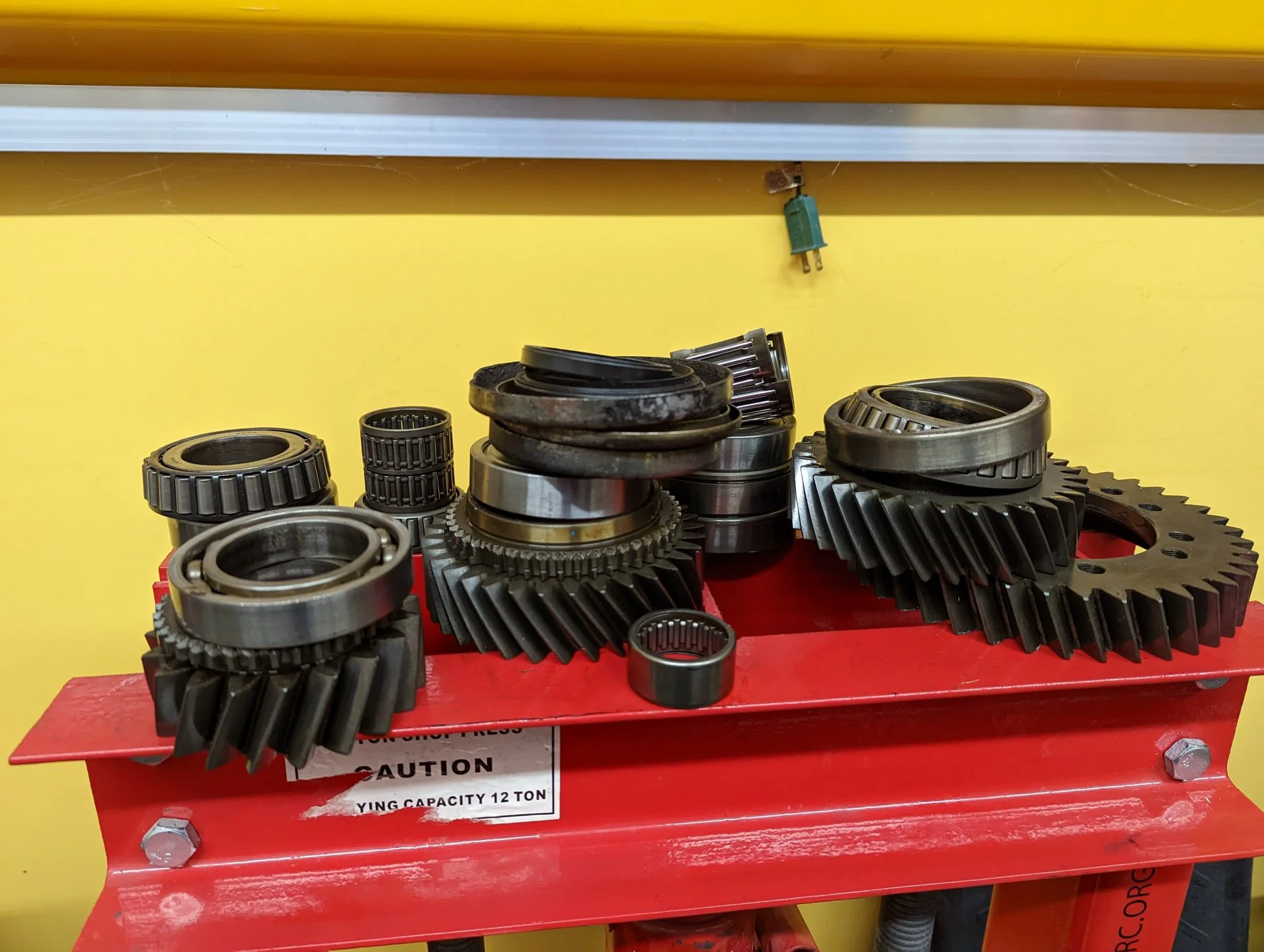

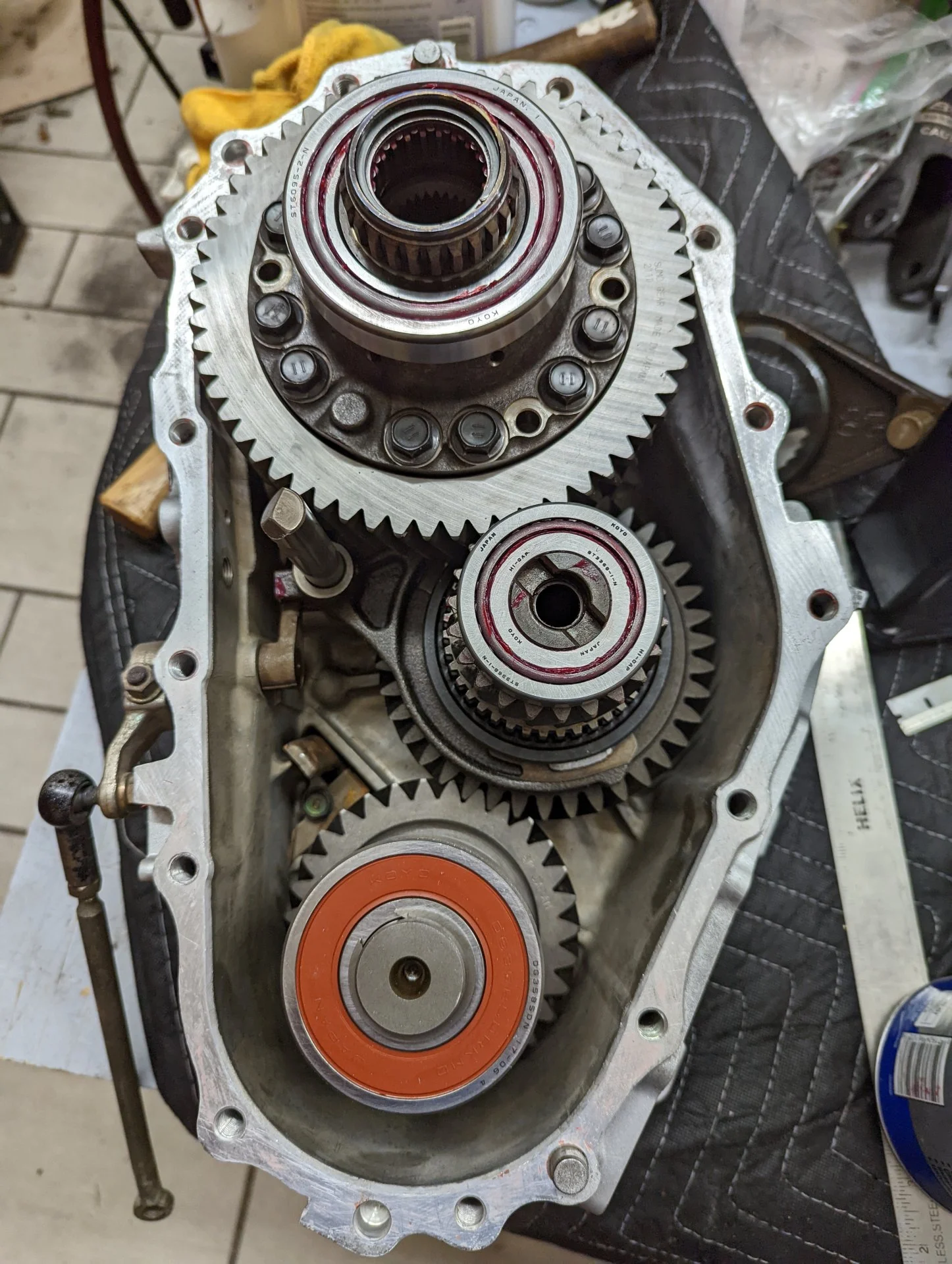

While I'm in there.... Took way too long to decide on the low range gears to go along with the high range underdrive, then way too long to actually do the work...
Old front output seemed bent. Better safe than sorry, I don't want to ever pull this thing again.
I had some parts left over....

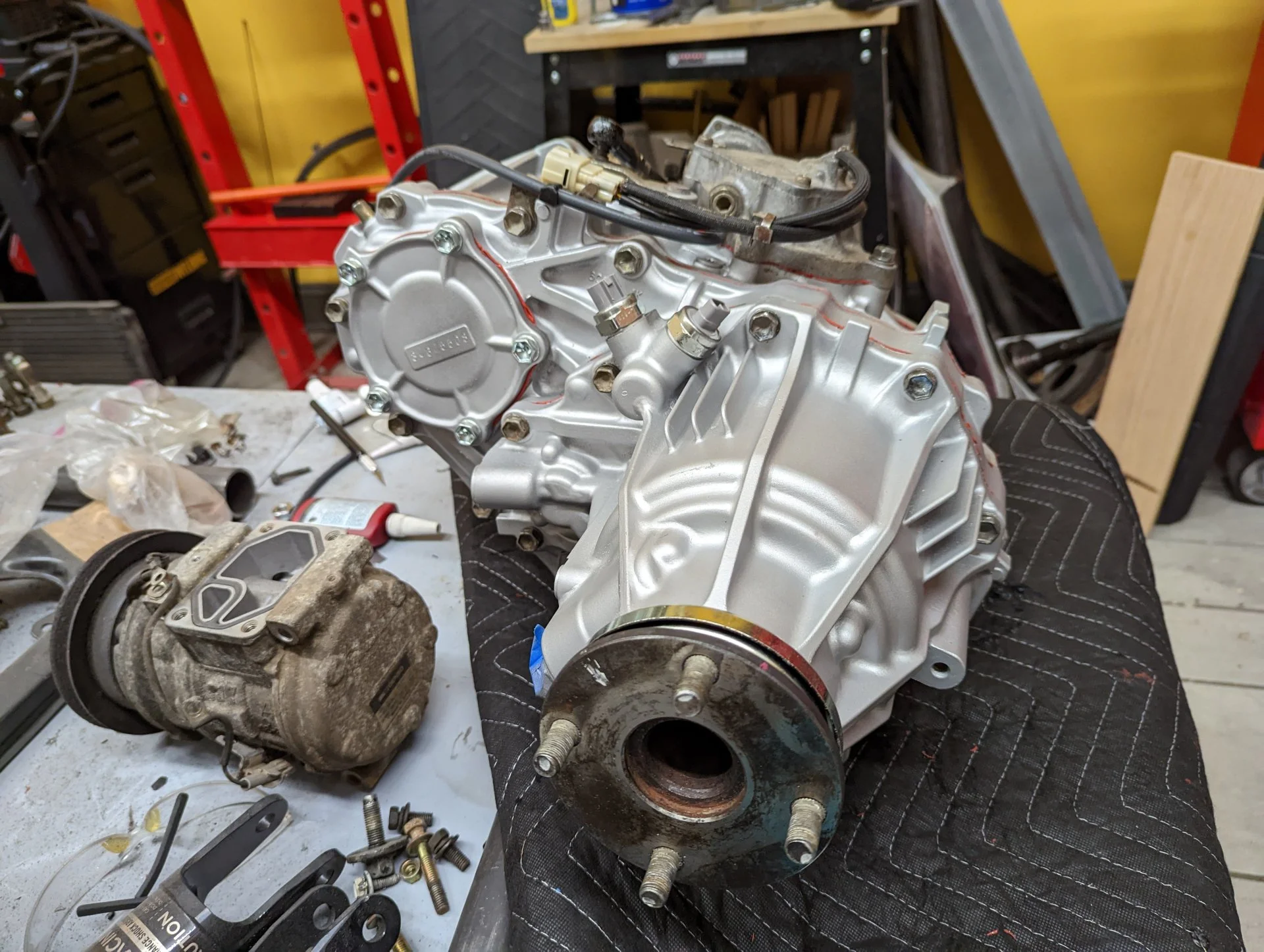

Past due update time ! The transfer case is back in (behind the transmission that went in in the pics above, which in turn is behind the rear main seal that I screwed up during the original rebuild). Me being me, of course that was a 6 month endeavor by the time I pulled the transmission and transfer case, cleaned everything up, decided to regear and rebuild the transfer case, Raptor line part of the floor, etc. The good news is that I have put a few miles on it (maybe 50 or so, need to check), and all the fluids are staying in their respective locations and not trying to rejoin the earth. Seems I can install a rear main seal on the second third attempt ! The bad news, it seemed to want to kill me. I had noticed the steering lock "sticking" a couple times before, but nothing serious. It was just a little grabby at first, you could tell the pin wasn't all the way back. Seems it happened at the alignment shop and they declined to test drive it. I made a mental note, but didn't really want anyone driving it anyway, and i had no other problems with it. But then it tried to kill me. After the transfer case was back in and I drove it for a day it was a little more "sticky", then making a hard right on to main street, it tried to lock and send me in to the curb. I was able to overpower it and pop it free before anything happened, but needless to say it sat in the driveway not moving until I figured that out. I had all kinds of theories, This was an e-bay steering column from Arizona to replace my very rusty one. I though maybe that sand had worked it's way in and worn down the mechanism. I even ordered parts for it. Once I pulled it apart (I can get a steering column out pretty quickly now) and taking it apart, I realized the answer was much simpler. This thing had been shipped across the country. When I received it, I just popped in my lock cylinder and a new switch with no problems, and installed the column. For those who come behind me, when you have both the lock cylinder out and the key switch off, the steering lock cam is under pressure from the steering lock rod spring, and just like any other cam under pressure, will try to rotate out of position. When it is 180 degrees out of position, the cylinder and switch will go right back on, but it will try to kill you later.... I rotated it 180 and held with a pair of needle nose piers from the switch end while popping the lock cylinder back in. Now the steering column locks when it is supposed to, and doesn't when it's not.
