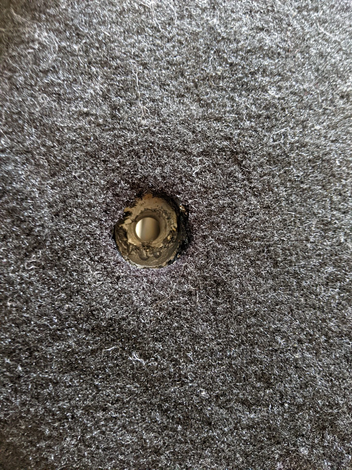

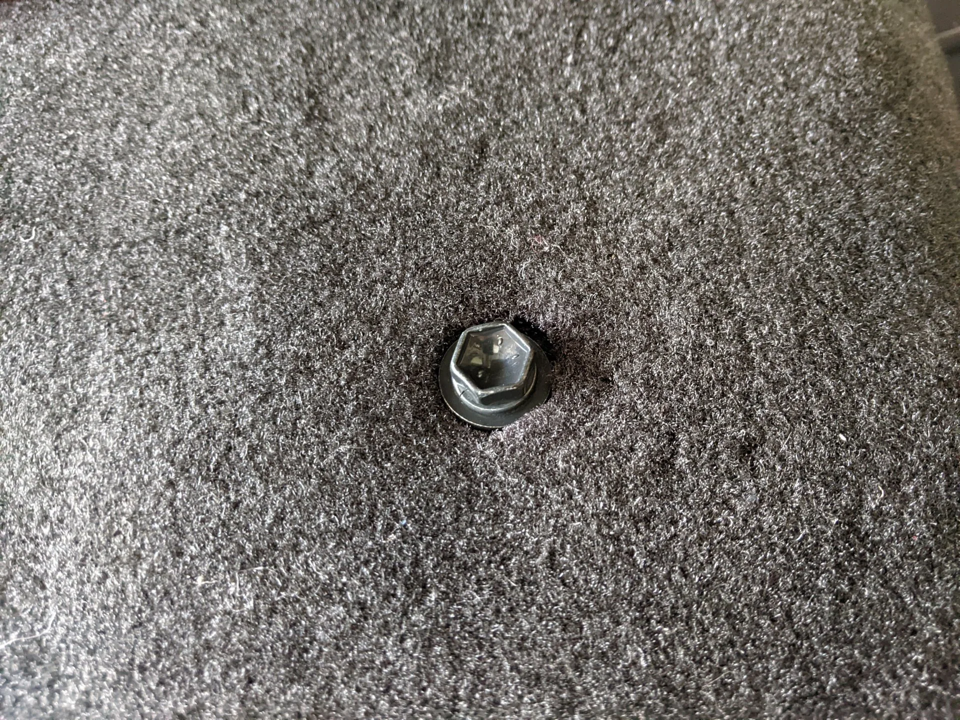

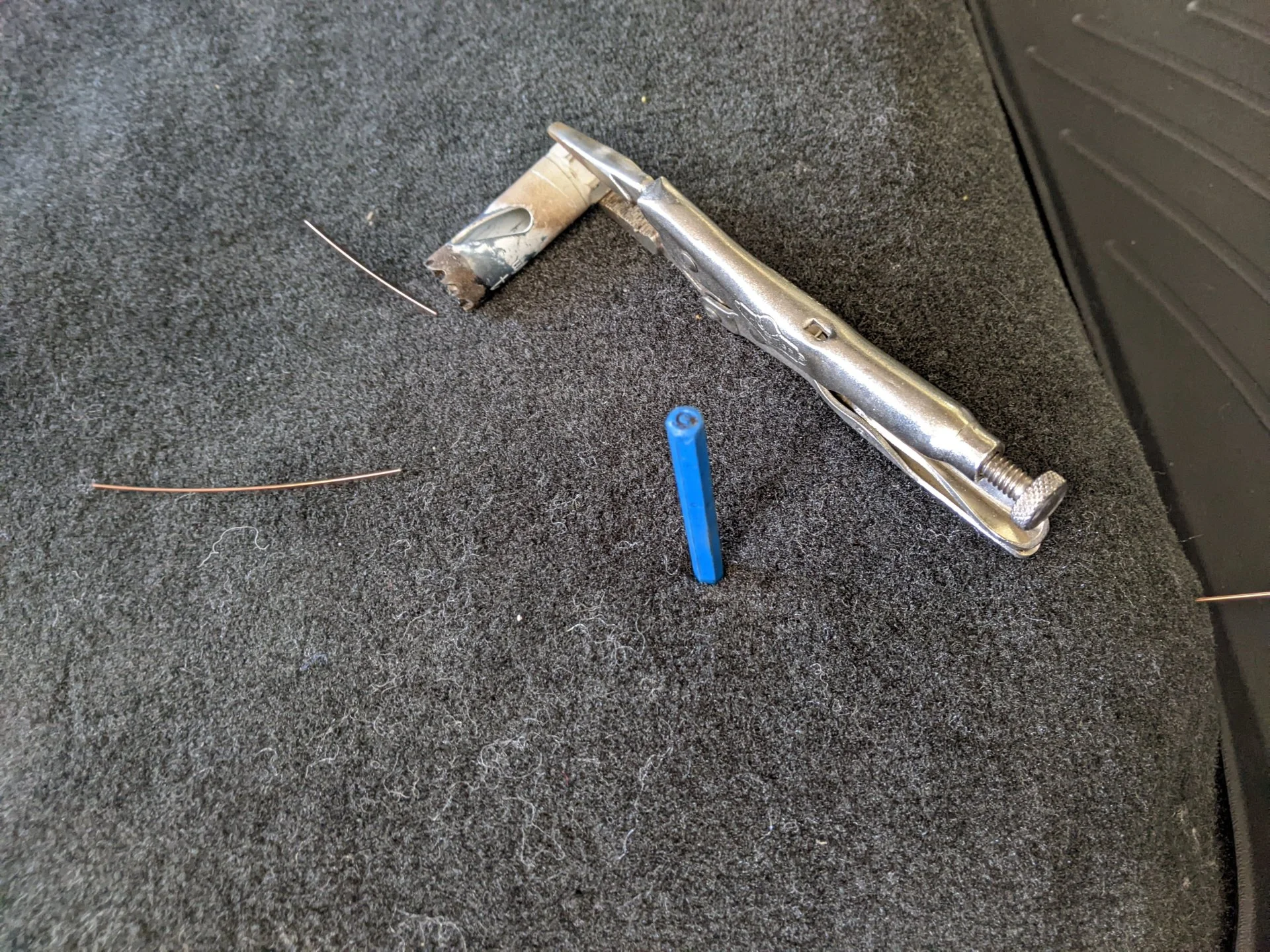

How I make clean bolt holes in new carpet. Not a tutorial, this is not OSHA approved, or even smart. I'm an idiot, don't do what I do.
The first time I ever installed a replacement carpet I tried to cut the seat bolt holes with a razor , it really didn't go that well. Now that I'm older and wiser, I have a trick. Won't work for natural fibers obviously, but works well on the plastic stuff.
First, find the hole. I like pieces of welding wire, it's stiff enough but doesn't do any damage. You could use any kind of wire, a pick, or worst case, measure.
Once the hole is located, I use a prick punch as a guide....
Then something metal and round, I often use short lengths of tube, in this case I've ruined a perfectly good hole saw.
Heat the tube or hole saw with a torch., and use the punch to center. Quick slide over the punch, in to the carpet, twist and pull out. I don't have any pictures of this step, I don't like burns.
Pull the punch out of the hole...
...et voila !
A round, centered, not going to unravel or tear hole.
It even works as a hole.
Jason

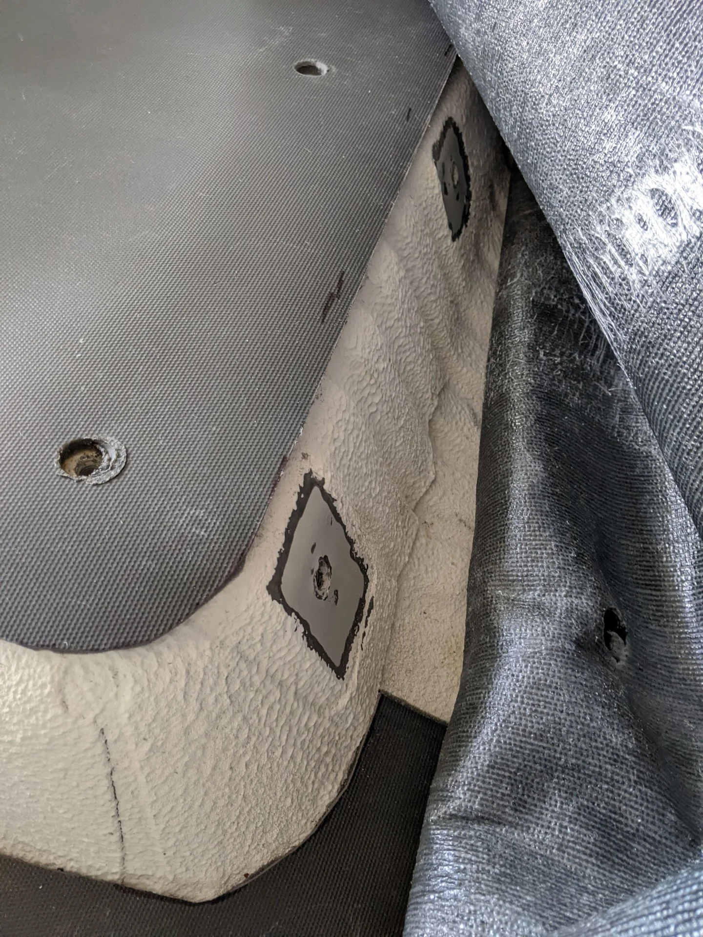

I was having a hard time aligning the seat to the freshly made holes until I realized the thickness of the Lizard Skin was the problem. Removed it from the area of the seat brackets...
White layer is Lizard Skin Ceramic Insulation, black is Sound Control....
More better...
You can also see the color difference between the stock carpet still on the bottom of the rear seats, and the ACC Dark Slate I replaced everything else with.

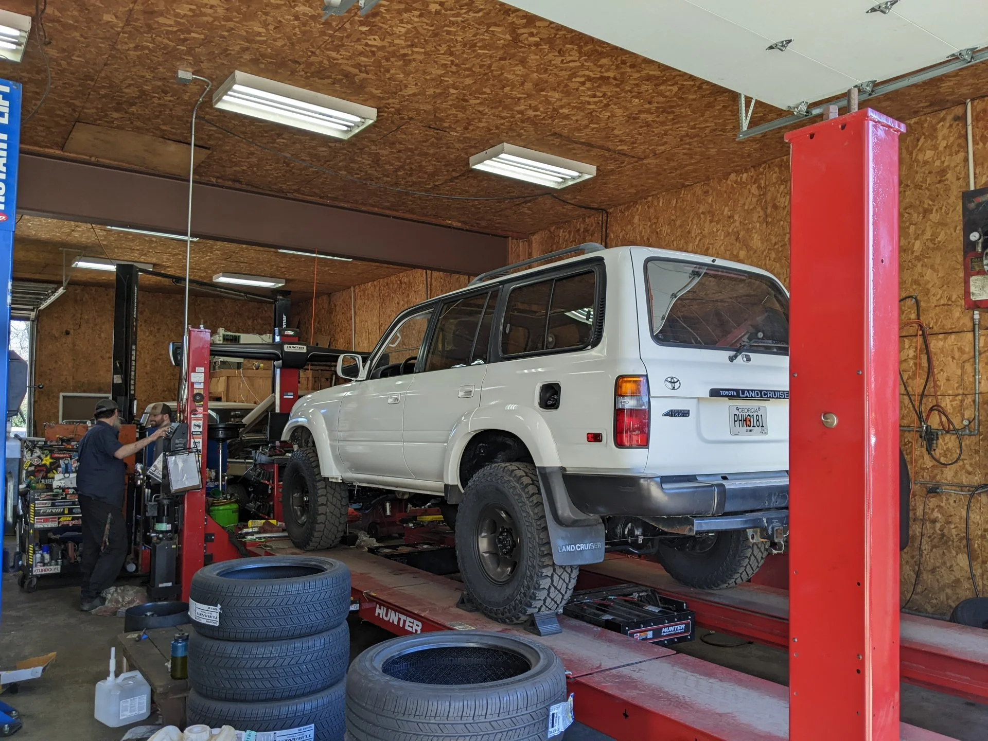

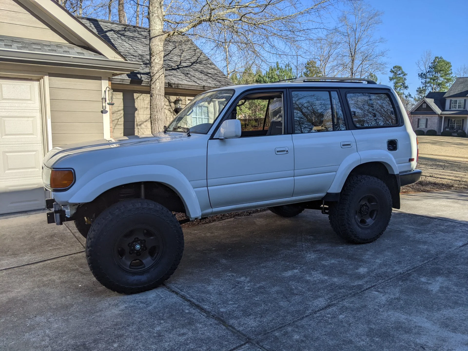

Well, we took a test drive to get an alignment...
Definitely still some work left to do. Throttle adjustment seems to need some work, and I have to get back to that tranny connector, it isn't shifting very nice. But it made the first 8 mile round trip with no explosions or major failures.

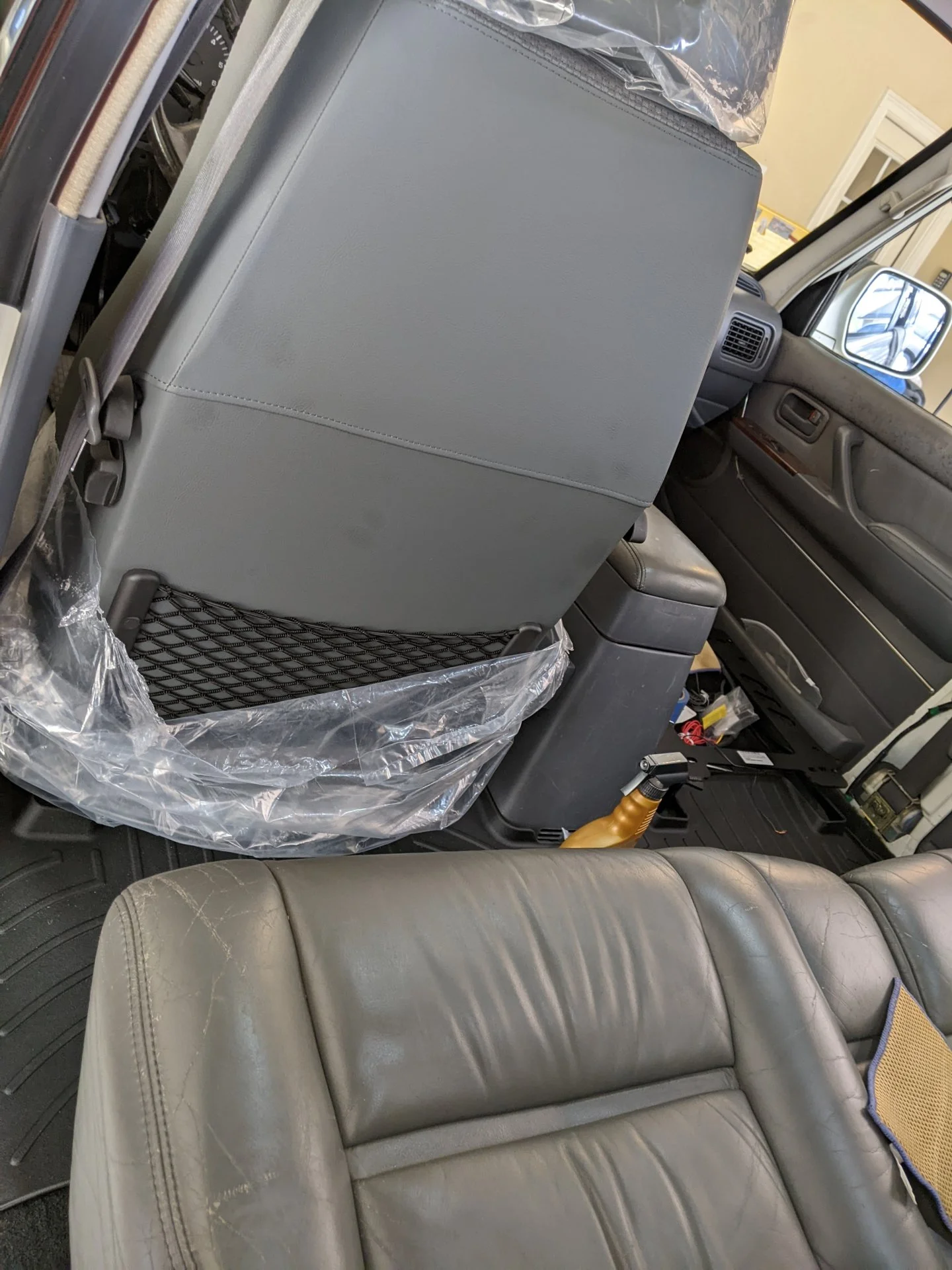

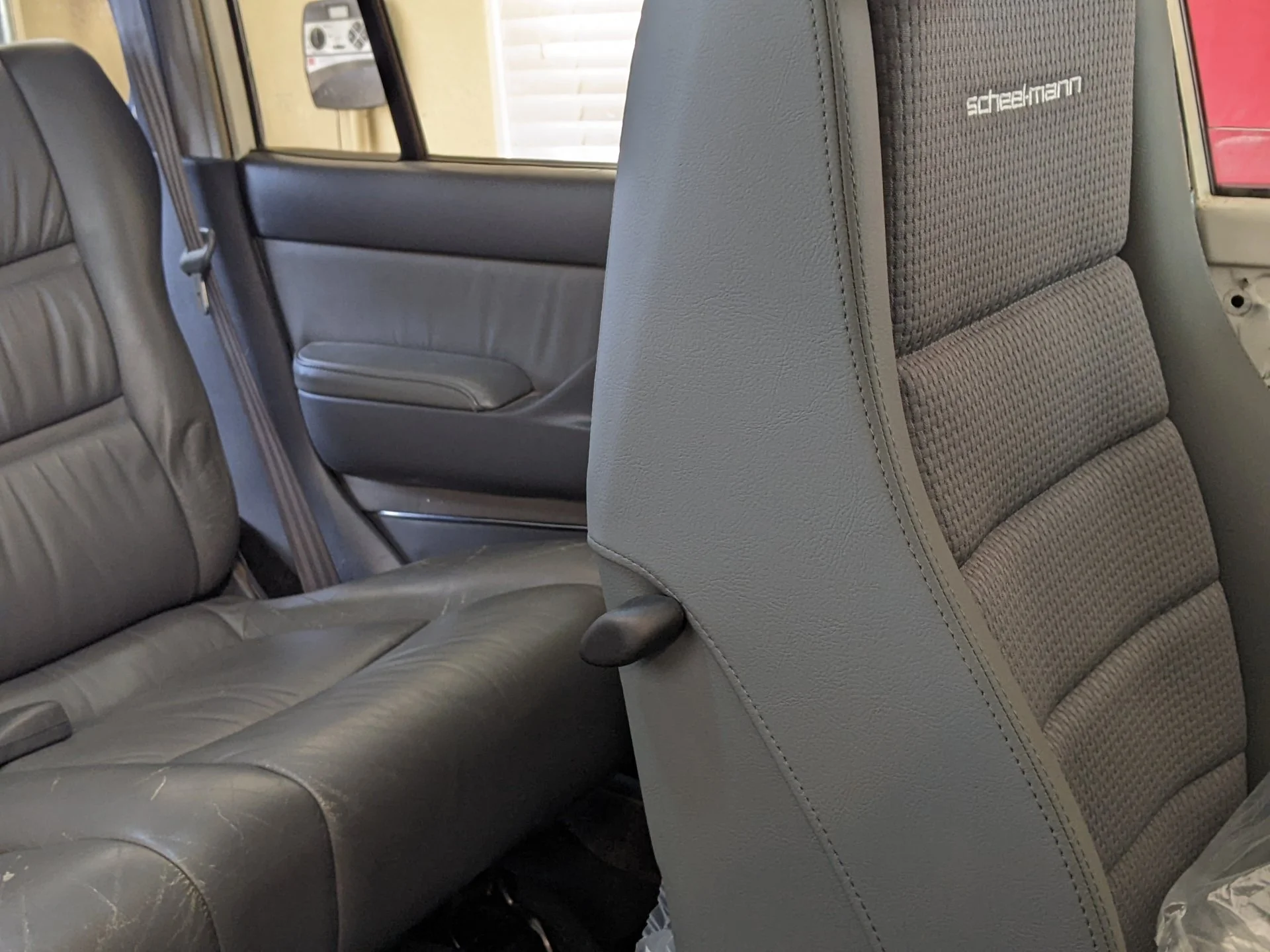

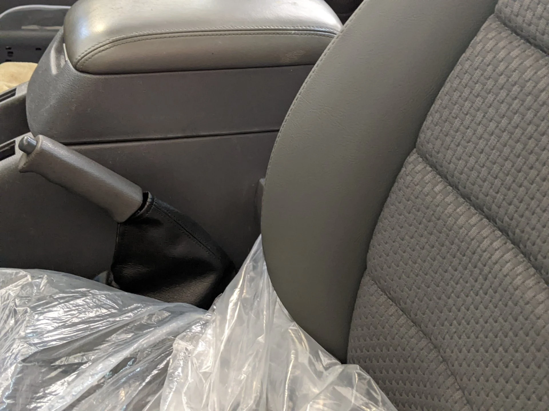

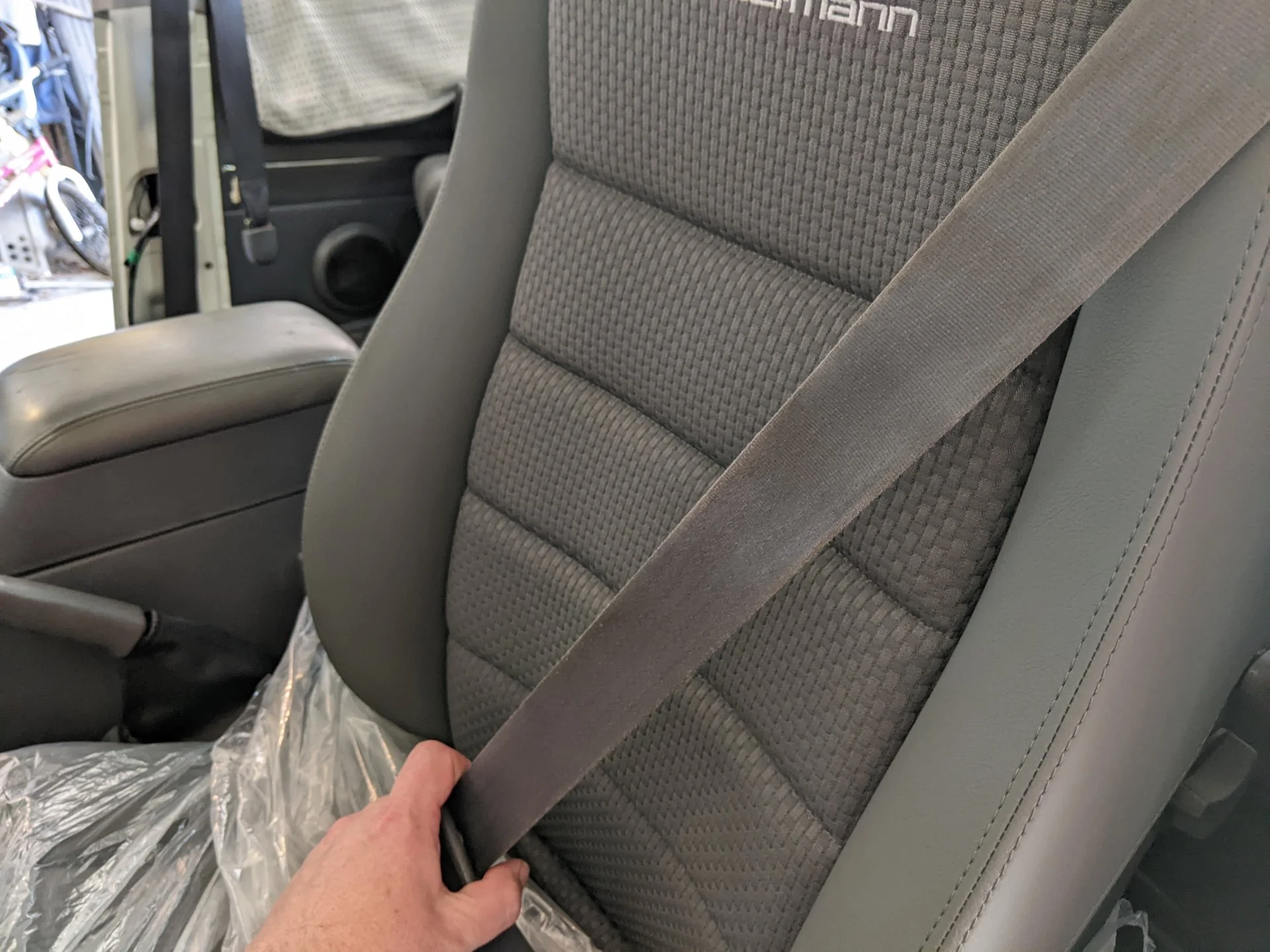

Had a question on how well the Scheel-Mann gray seats work with the factory interior. I wondered the same before I ordered, so here are a few pics. This is in the garage under a mix of natural light, and LED in the garage and dome lights. I would say they don't "match" but they "go together" very well. Yes, my wife and daughters taught me that... @FFFbuff
Passengers side will be here Tuesday. Kids can pay their own way to college.

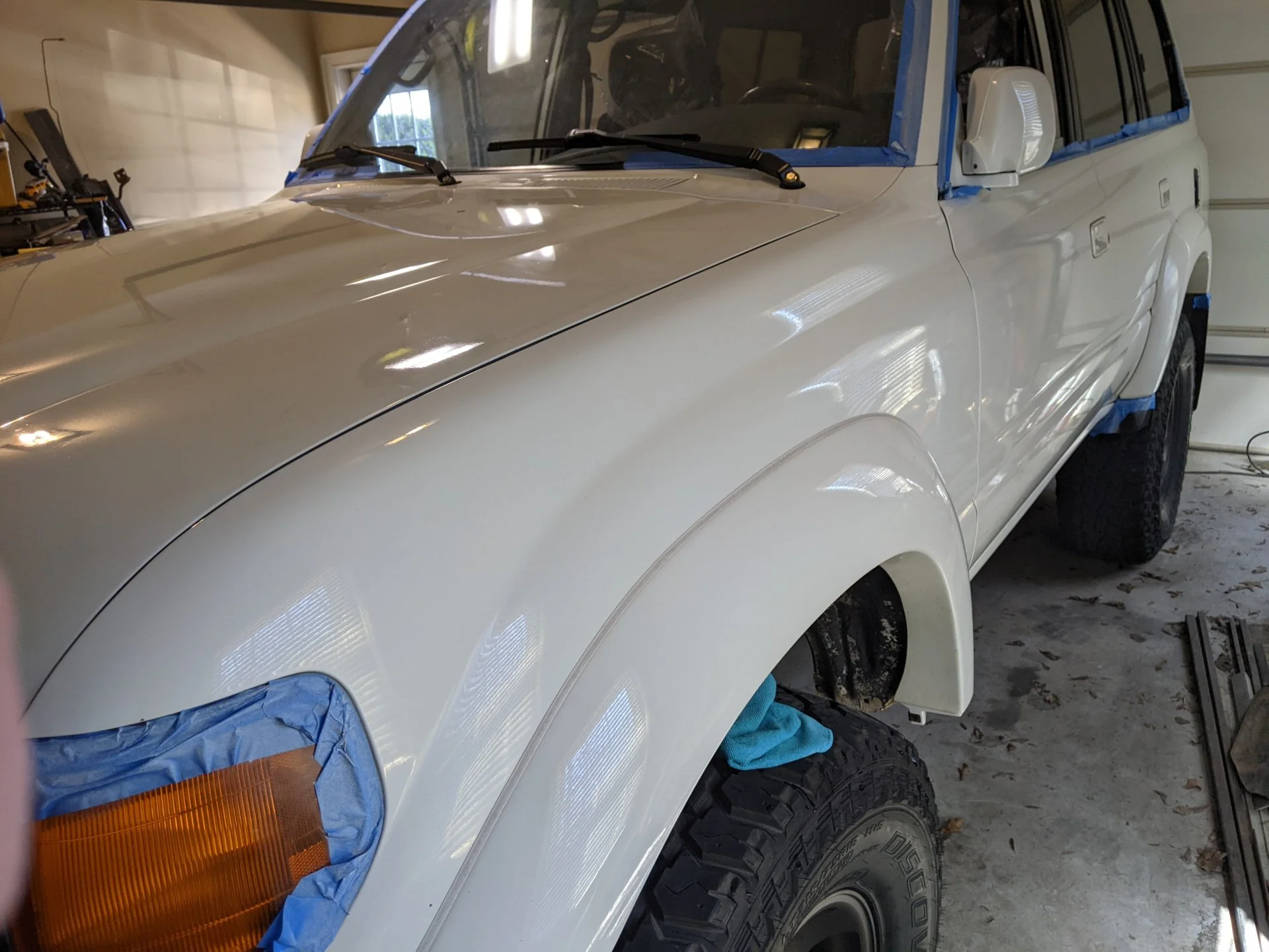

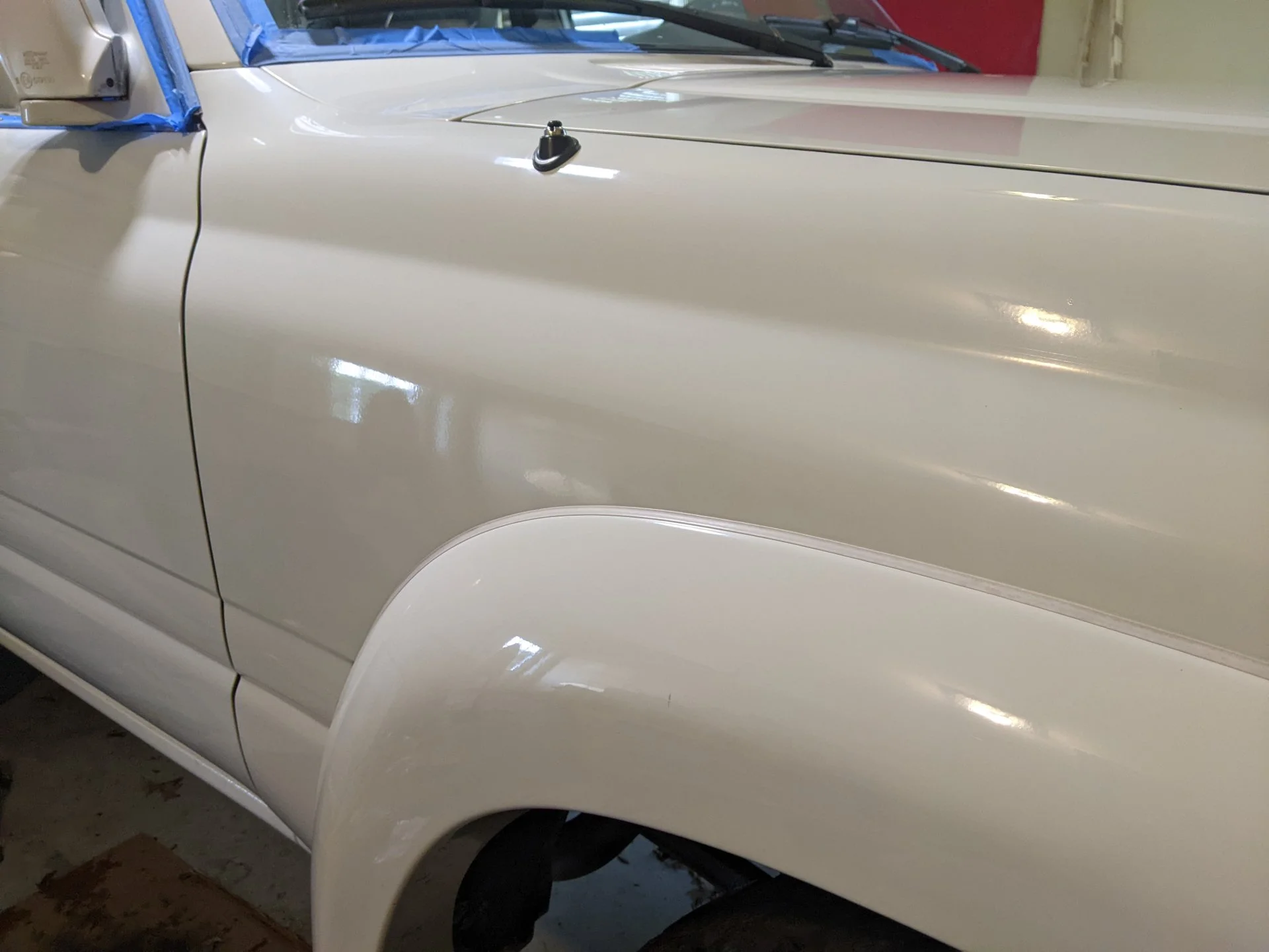

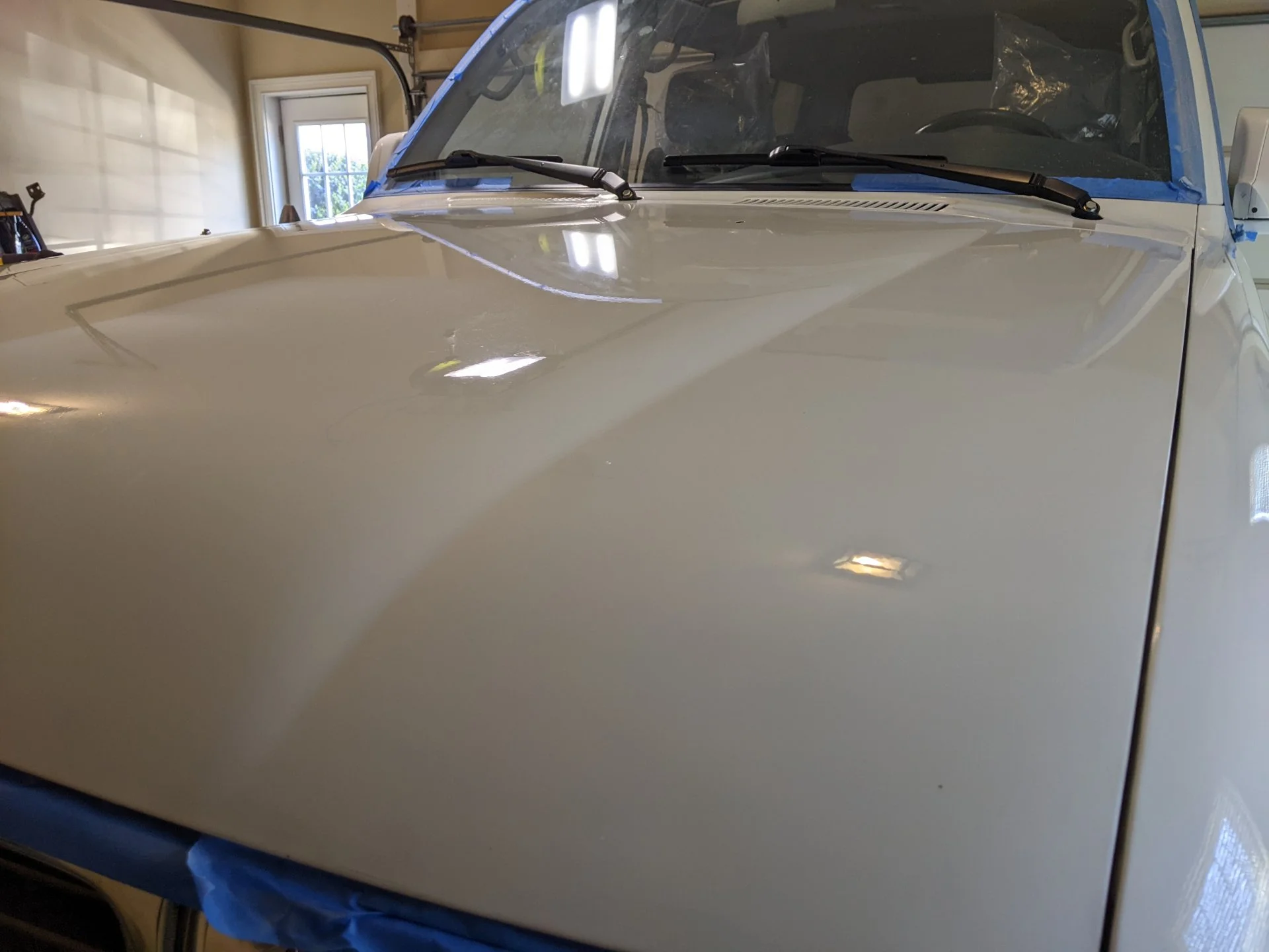

38 degrees and 20 mile per hour winds didn't seem like Cars & Coffee weather to me, so I did the next best thing, more polishing and coating.
Last polish round before "wax"... It's far from perfect, but for 29 year old paint and how it looked when I got it, I'm amazed.
Jason
I don't think I've buffed a car since they started calling it "paint correction", so I watched a bunch of videos to find out what is out there. Back when I did a lot more of this, Turtle Wax was the paste in a can your grandpa used. Now it seems like they are leading the market and still priced right. Used two rounds of the 1 and Done, first an orange pad, then white, on a Griots Garage dual action polisher. Applied the To The Max Wax with a red pad. Hopefully this will make it easy to wash, and prevent the white paint from being stained by Georgia red clay again.
The only negative to the to the "wax" I see so far is that it needs to cure for 24 hours before getting wet. That could be hard if you don't have alternative transportation or a garage.

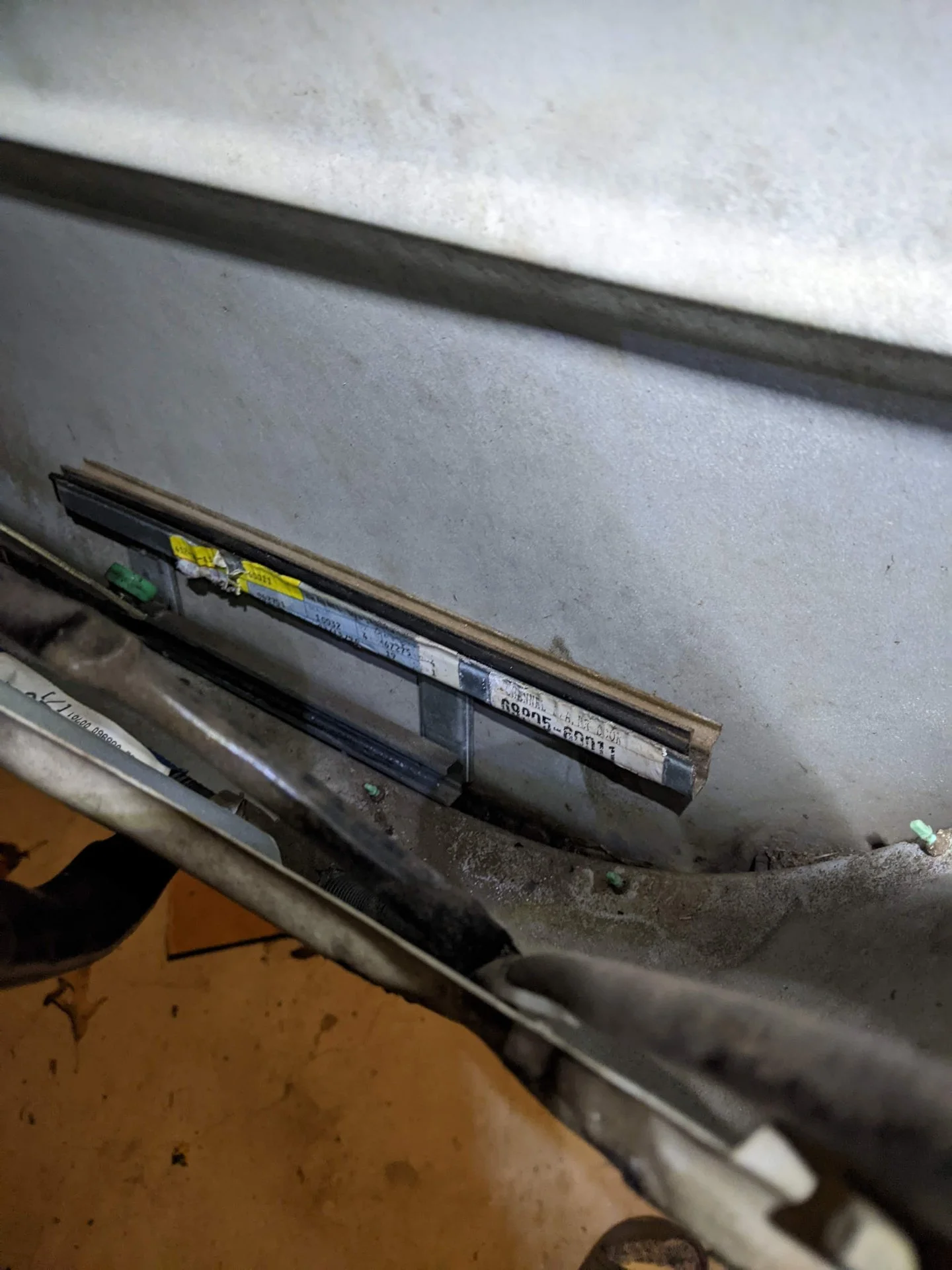

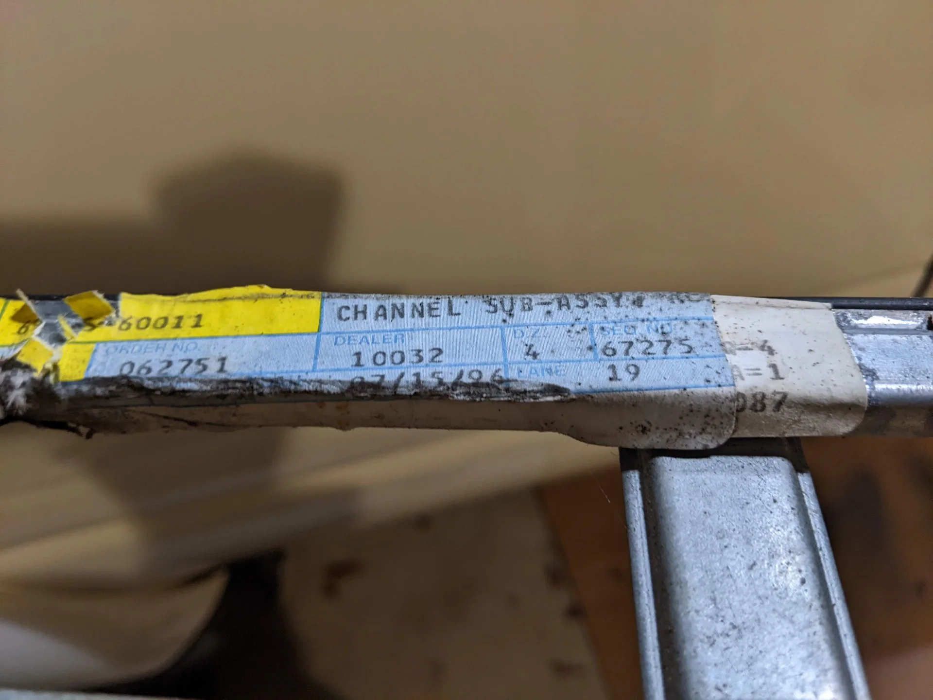

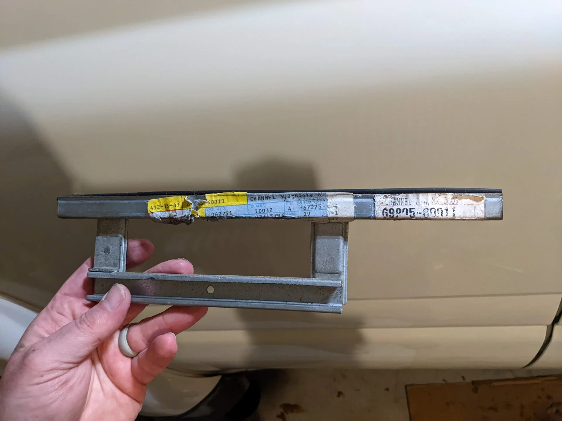

I love the archeology aspects of doing this for some reason. Here's another example. The right side rear window stuck down during my recent test drive. Pulling the door panel off it was obvious someone had been in there before, and they weren't overly careful. Unfortunately it was also obvious that despite looking pretty good on the outside, this door panel is also seriously water damaged and needs to be replaced, so I'm looking for door panels. Anyone have good gray 93 + panels for sale ? Anyway, here's the scene I found in the bottom of the door...
So.... That shouldn't be laying there, and it shouldn't have that all too familiar Toyota parts department label on it. Also under it and coated in years of grime is glass from a broken window.
The date is still legible, 7/15/96. So, in July of 96, before her third birthday, she had a shattered right rear window. There is no other obvious evidence of the door being repaired (and the glass in the bottom tells us this is the door it was broken in) so I would assume just the glass was broken out. May be a break in, but not sure why it would be the rear, so maybe just a baseball or other incident. The fact that the channel was replaced though makes me wonder if there was maybe some type of part or assembly issue that caused it. Unless the part was just cheap enough that the shop didn't want to pick glass out of the old one. Maybe that, since they didn't vacuum the glass put of the door either....
