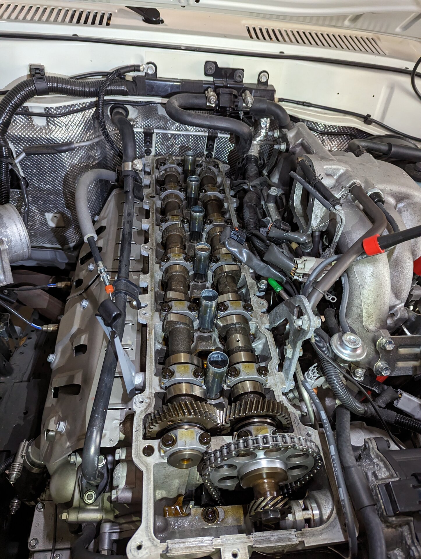

The high idle had to be corrected, so I eventually admitted I needed to pull the throttle body. Having read a thread or two where people had head issues after rebuilds due to oiling problems, I was a little paranoid. Granted any major issues should have already shown themselves, but... While I was in there with the TB removed, might as well check in on the valvetrain. Seemed appropriately oiled and new looking. Only surprise was that a couple of the spark plug tube seals had let a little oil by (I guess on the bright side, that's another sign that the head is getting plenty of lubrication.
Jason
I'm going to call this a win. Found the throttle dashpot was not allowing the throttle arm to hit the stop, leaving the throttle cracked open. Saw some people saying this is because of a weak throttle spring, but the spring felt pretty aggressive. The dashpot still works, just seemed maybe a bit stiff at the end of its travel. Seems it's NLA. Well, it has an adjuster on it, I take that to mean it can be adjusted. Backed it off until the throttle arm hit the stop, adjusted the TPS for what I hope is the last time, and tried it out. It actasilly wanted to idle at about 400 RPM until it learned the new position.
Jason
Update time. Little over 1,000 miles on the engine and transfer case rebuilds. All the parts and fluids are still where they belong, so I feel pretty good. Changed the transfer case gear oil around 600 miles and no sparklies or chunks. The idle was great for a couple days after the dashpot adjustment, then went high again. Back the adjuster screw all the way out and we're good. At least we were for a week, then it was way high again. Quite relieved the adjuster screw had just screwed itself back in (I had just backed it out with a socket and not tightened the lock nut. Back to all good after backing it out. Issue was the "soft close" dashpot for certain.

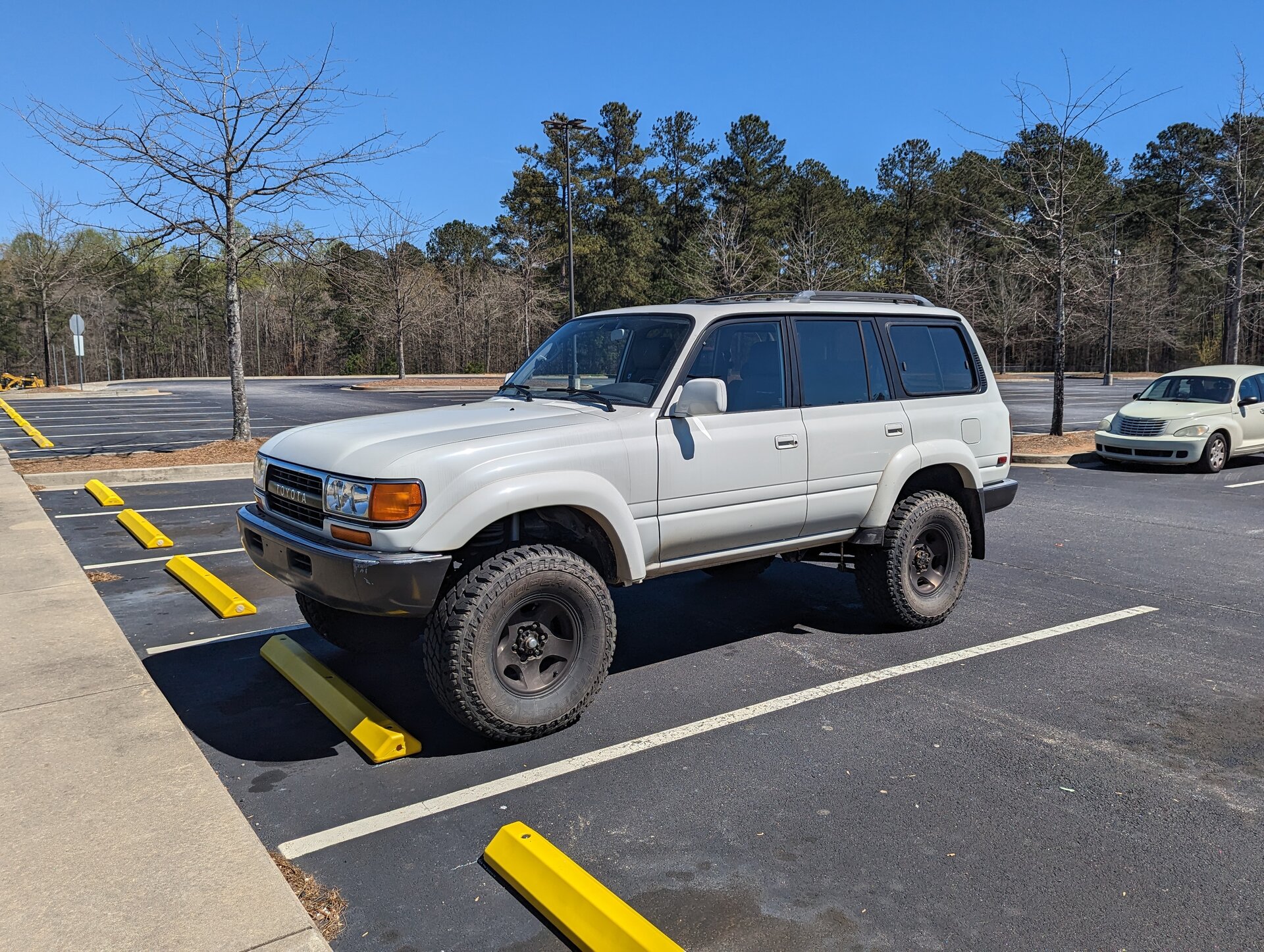

Overall, things seem to be going very well (knock on nearby imitation wood). Other than the vague on center steering feel, the suspension is better than I expected. It cruises down the road far better than I thought I could expect with over 3" of lift and "35's", and it seems to be smoothing out even more as things break in. That could also be me not listening or feeling for every bump, tick, knock or whistle....
Four years (but only ~1,500 miles) after the intro post pic....
