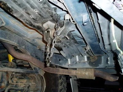

The basic idea is to raise the cross bar that houses the spare tire winch and thereby raise the spare tire for better departure angle and clearance. It has been done many different ways. I used longer bolts for the 6 that hold this crossmember to the frame and stacked nuts over it between the crossmember and the frame. IIRC you can get an additional 1 1/2" or so more clearance. Cheap and easy. Sorry don't have any pics to offer. If you remove the spare tire and look around up there it will immediately become clear. Good luck.

I had this going B4 the swingout.
Its laying on my garage floor now.
I can Email better pics if you want.
Gave about 2" lift with 2" winch drop.
HTH
ken

If you drop the winch it will work sweet.
Check the previous pic.
ken
Raise the cross member, drop the winch, just use longer bolts and some washers or nuts as spacers.
Just did it today, easy as it seems and the departure angle looks at least better, and even if it is not you are still less likely to damage your spare...

I just did this mod over the weekend. First of all, my 35" tire just barely fits up there to begin with. I had to remove my drop hitch for the tire to even fit.
I started by spacing all the bolts evenly as everyone else has done. I wasn't that happy with how far it still hung down at the front. I ended up playing with different amounts of washers until I had it as high in the rear as it would go as this is the limiting factor. The tire hits on the underside of the rear bumper. In the end I think I ended up spacing the rear up 1/2", the center up 7/8" and the front up 1 1/8". Doing this coincidently kept me from having to space the chain winch as well.
One more thing that I did that nobody has mentioned is that I supported the front of the tire as well. If you grab the rear of your tire while it's up there an pull down, it doesn't feel very solid. I had the same problem with my 4Runner. I could actually feel the tire rock when I went through dips fast and thump back there. I bolted a piece of angle iron to the frame just forward of the spare (putting pressure on the top front of the spare). There are actually holes tapped into the frame so bolting it is easy. Now when I crank the spare up tight it is solid as a rock.
