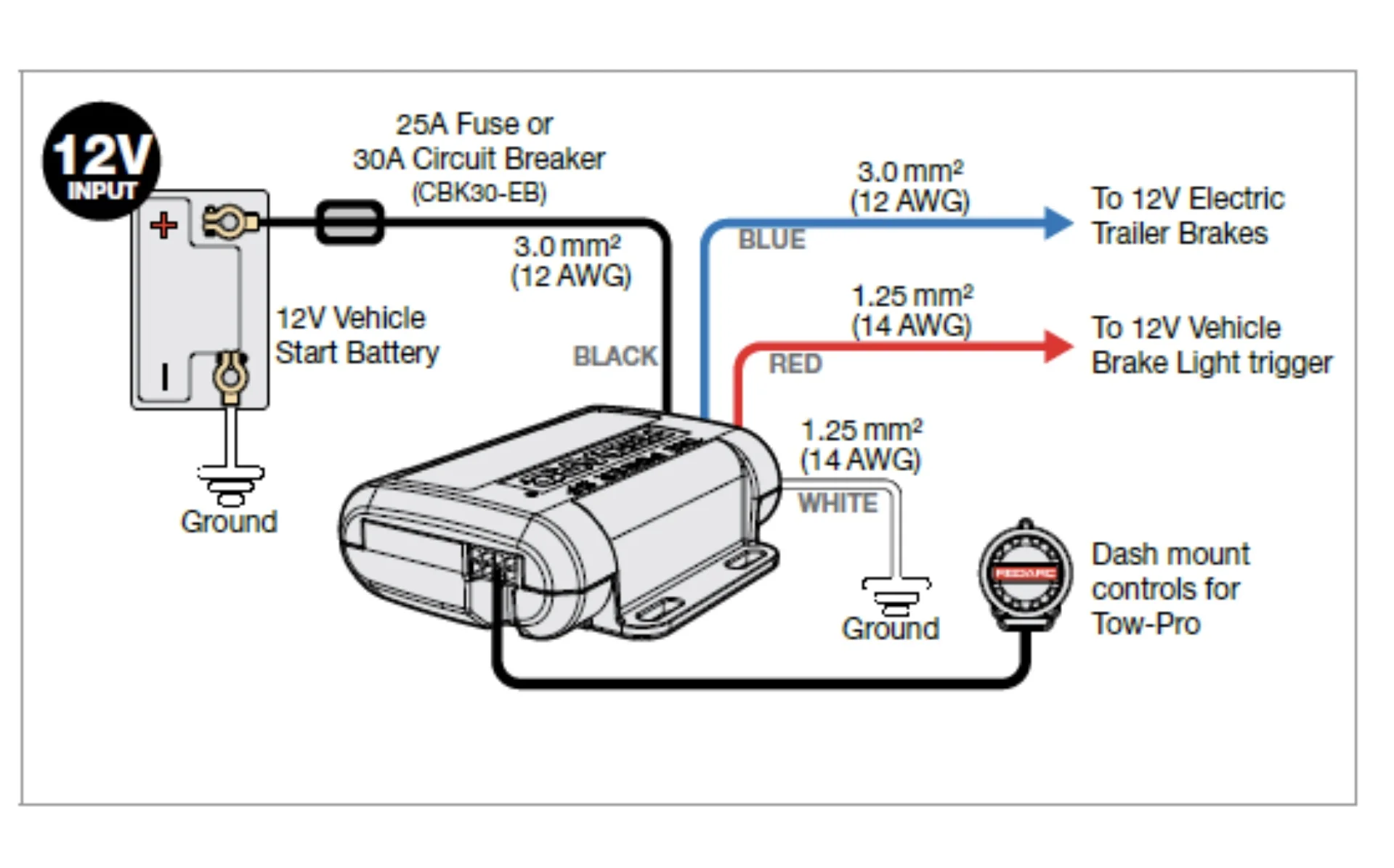

I'm installing a Redarc. I already have the Red 30 amp 12 awg wire going to the battery. I don't want to run the full length
of the vehicle for the blue wire which is 12 awg and doesn't need to be fused.

To be safe, you are correct, it should be fused, but if I follow the wiring diagram as per Redarc, it doesn't have to be fused.

I should be more precise about what I am trying to accomplish. I am installing a brake controller under the dash, and I am converting a 4 pin to a 7 pin trailer harness. The blue wire is coming from the Redarc all the way back to the brake controller output of the 7 pin, the 7 pin also needs a 12 constant. Rather then running the 12 v constant from the battery up front, is there a 12v constant near the spare tire to connect to the 7 pin? The arrow wire is what I'm looking for near the spare tire.

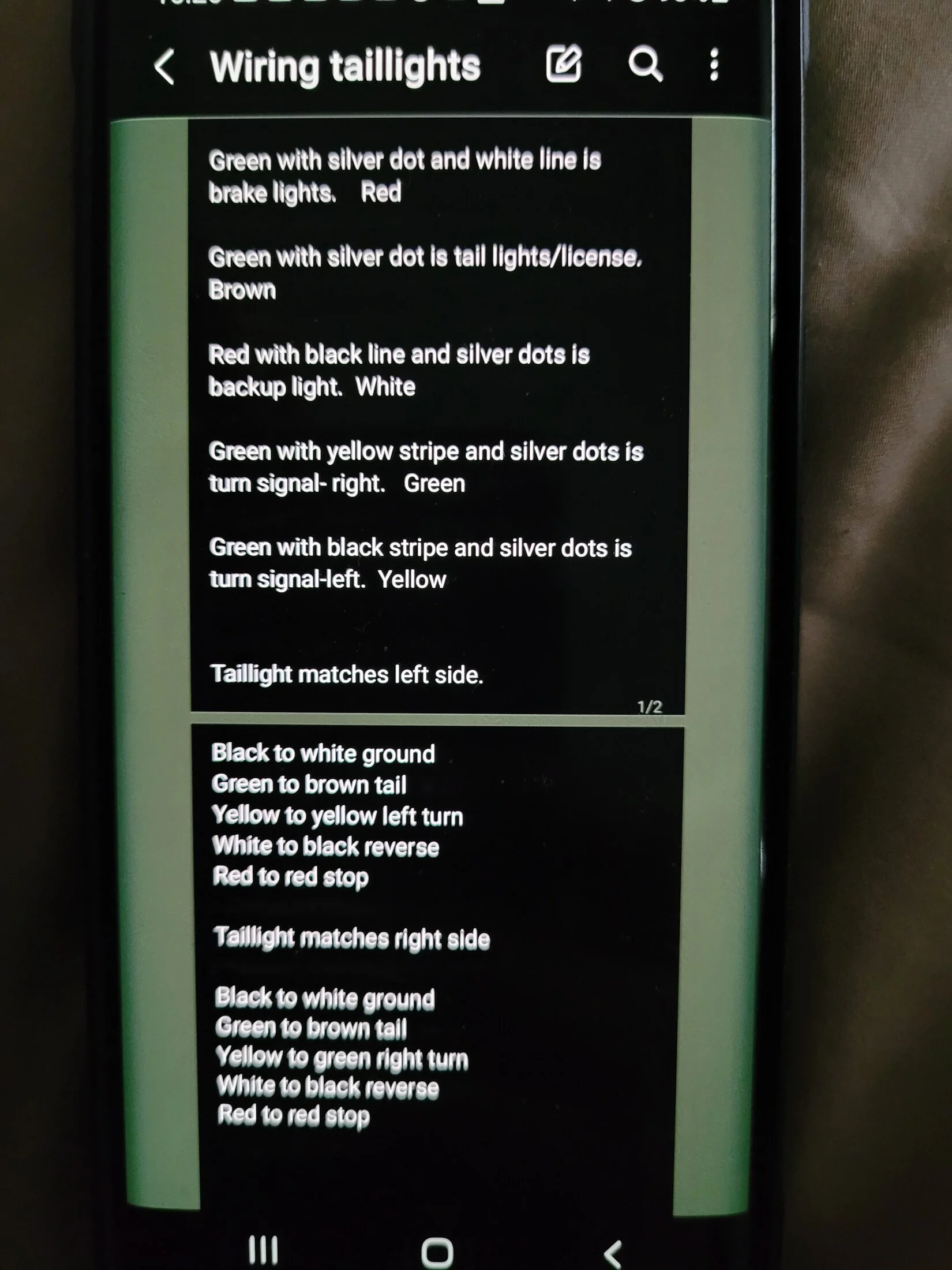

There likely is a constant 12v wire available at the rear of the 80. Probably on the taillight harnesses. I don’t have an EWD handy to find the wire. I would not get your 7 pin Black power source from tapping an existing fused small gauge circuit though.
Run 10awg duplex from the 7 pin, along the frame DS, to engine bay. One wire is for the 7 pin Black one for 7 pin Blue. Black goes to battery + with a breaker. Run the Blue wire and Black wire from the Tow Pro thru the firewall. Crimp Blue on to the other duplex wire (the one your crimped onto 7 pin Blue. Black Redarc wire goes to battery + with a fuse or breaker (30a). Secure and protect wires under the vehicle. This eliminates you running wires thru the interior.
Finish with under dash local body ground (Redarc white) and brake tap (redarc Red). Just my suggestion. I install these on various vehicles.
