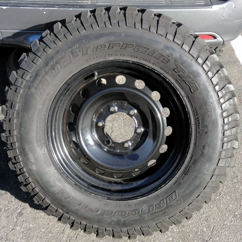

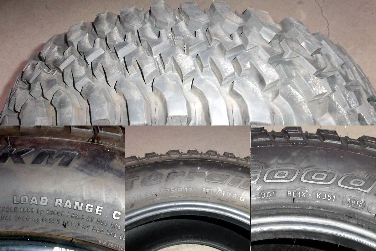

Found spare in almost new condition 255/75R17 BFG Mud Terrain KM for $60. This is the 32.1x10R17 tire that will be my spare to my 285/70R17s. Spare tire is C rated or similar to 6-ply or 111 load rating. Manufacturing date is 4913 = week 49 year 2013
I’ll post another picture once mounted and installed in spare location.

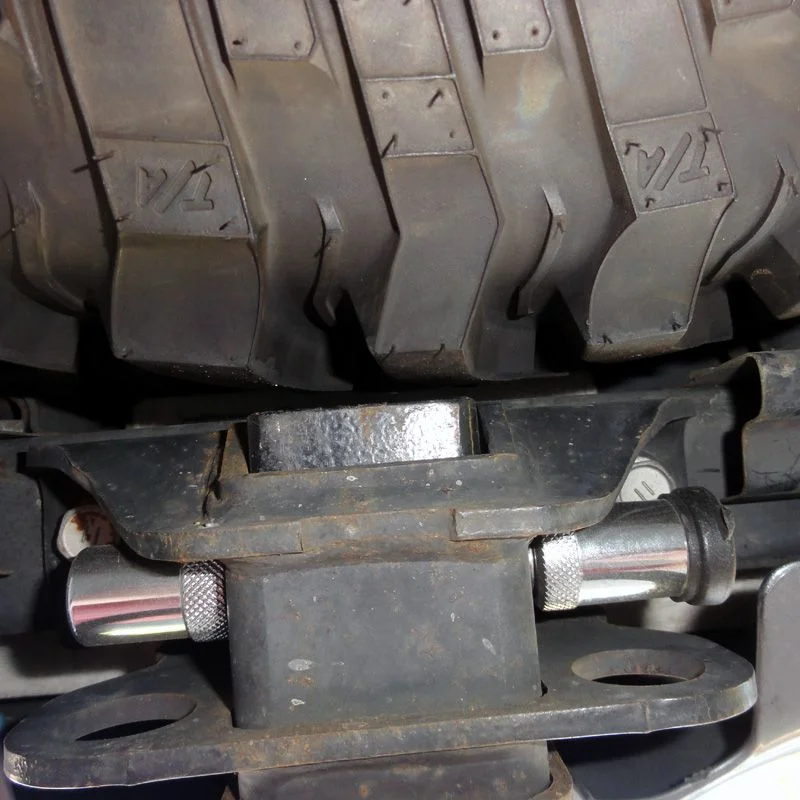

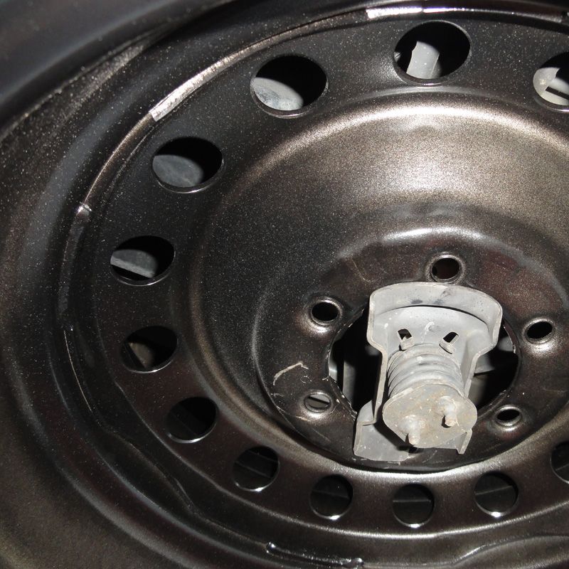

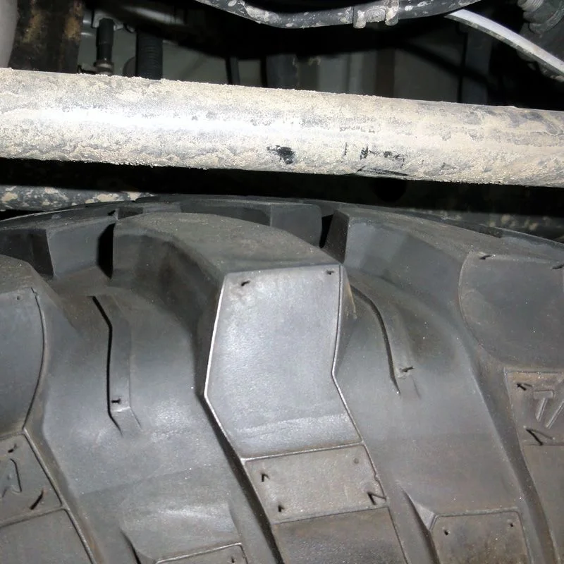

Mounted and installed my spare in the OEM spare location...
Spare Tire: BFG Mud Terrain KM 275/55R17 inflated to 60 lbs
Spare Rim: FJ Cruiser Steel Rim 17x7.5 with +14 offset
This spare tire should be like a 32.1" x 10" R17. It fit like a tight glove under the spare location.

Homers, Do you have KDSS? I went with 255/75/17 BFG Mud Terrains on stock rims but my spare is about a half inch too big and is wedged against my KDSS.
No kdss for me. You will need to deflate your tire and carry an air pump.
