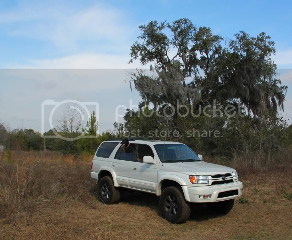

Thanks Ian! Tan interior indeed and I personally preferred the tan interior over the black- felt more "Lexus" to me haha. And deep down it reminded me of my 3rd gen limited with the tan leather on white.

Nice looking GX you have there, love the rims and stance. Nice 3rd gen as well.
