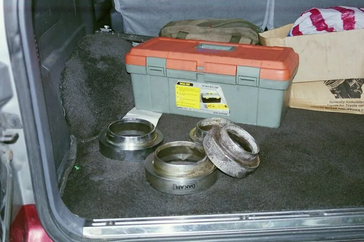

I had a 2" droop up front with a former set of springs and solved the droop with 1" steel Dakar ring spacers. Of course, that still left an inch droop, but I thought it better to leave it as I sometimes carry heavy things in back. Since then, I have installed 4" springs and the Dakars and former springs are resting in my garage.
There are plenty of rubber ring spacers here and they are unpopulr simply because they compress so easily and quickly. Even the poly spacers, which costs us much, are said to compress after a few years, but at least give you a period of good use. In all instances where I was witness to a droop fix or a lean fix, the poly spacers, chosen for correct height, solved the problems.
I've never experienced pinion problems, or dealt with them so I'm not able to offer help here. Do please be kind enough to post whatever solutions you discover.

I bought mine second hand. The PO didn't like his LC so tall and seeing mine, asked my advice on how to lower it. I saw them on his car and told him how to remove it and to call me if he needed help. The end of the story is he and his wife were plenty happy with a shorter LC and I bought the Dakars from him. They actually came from Japan as he bought his LC from there. Same model as mine.
You can have some metal ones made up in a machine shop. The only spacers I've seen locally are the poly stuff and they cost a lot less in the States than here. I'm holding on to this set in case I opt for bigger tires that would require more lift.
