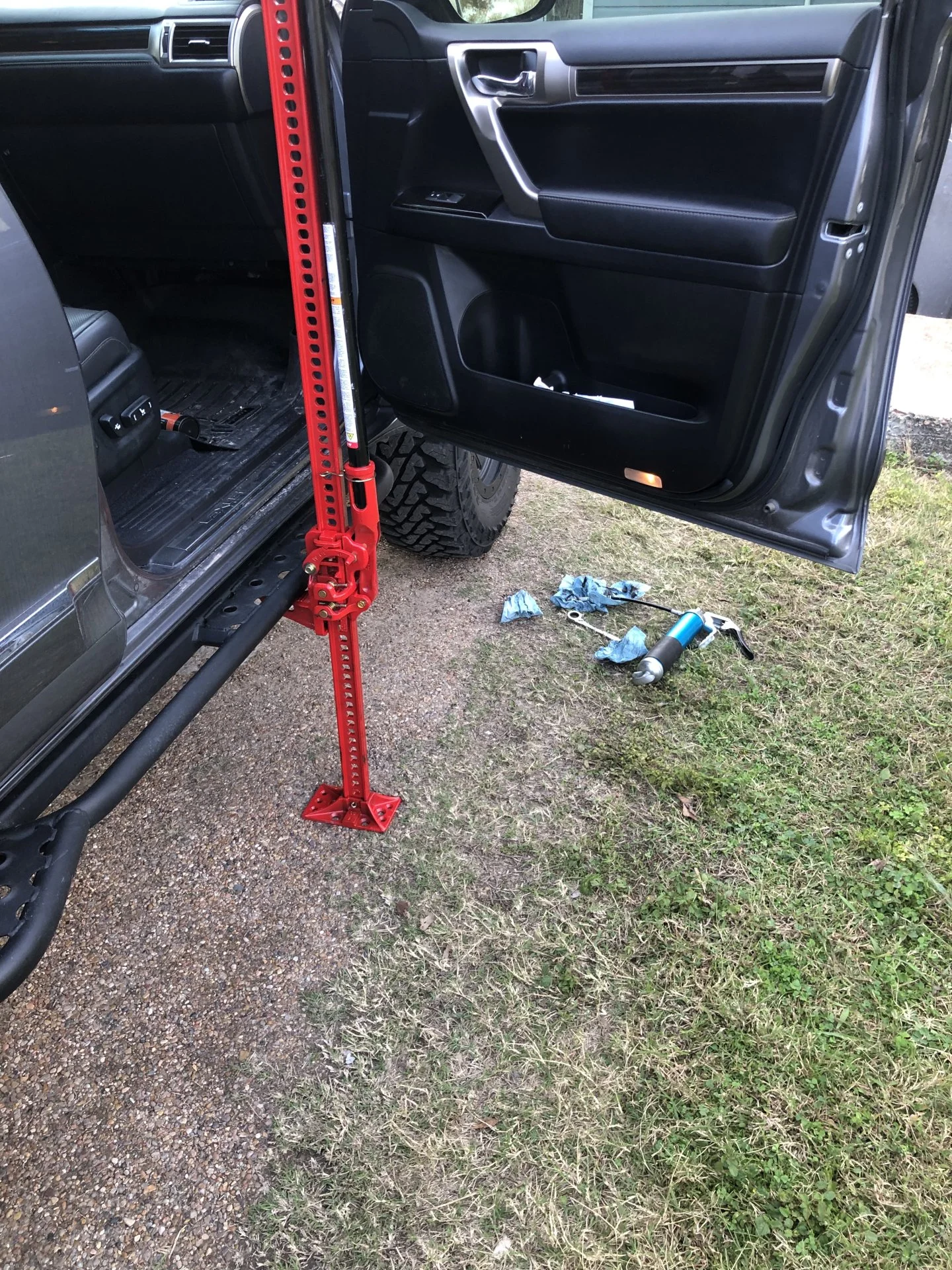

Over the past couple of days I’ve learned to to respect high priced tools and that having the right tools for the job make everything so much easier. I usually go to a buddies house to grease the UCAs and check torque on the front suspension. He was out of town this weekend for work so I decided to tackle it myself. I’ve bought tools similar to his over the past few months and learned that I should’ve just shelled out the money for the same stuff. My kobalt torque wrench was a good deal, but the distance between clicks is too much for the tight spaces of the fender well. The crowsfoot torque adapters are a pain compared to the box end ones. Also broke a craftsman ratcheting wrench. Looks like my Christmas bonus is getting sent to snap on for the same wrenches and adapters we were using previously. Also got a gearwrench 120xp extra long 19mm flex head wrench on the way. His made loosening the uca nuts so much easier with the extra leverage.
That said, I also like to live dangerously lol. Got a hi lift jack and used it to lift the gx for the job. I’ll be getting a pro eagle when I get my drawers and fridge done so I can figure out a way to mount it in the rear.

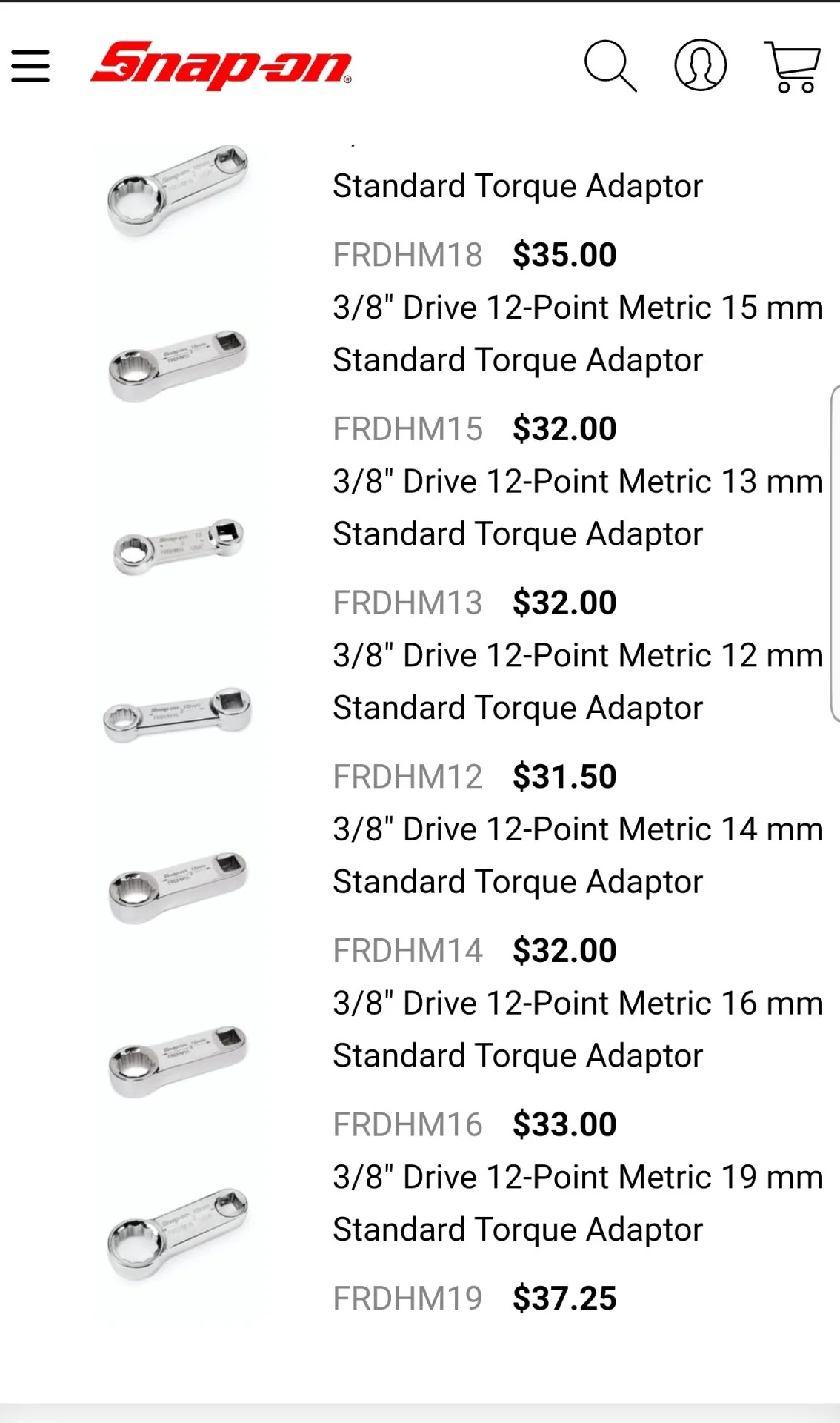

What tool do you use to torque upper control arm nut at ride height? No way my torque wrench gets in there around the tire. I took tire off, and jacked lower control arm up until hub to fender was at ride height, then torqued, but if you have a tool combo that works with tires on the ground, that'd be awesome. My torque wrench might not have enough "clicks" either.
Snap on techangle flex head 3/8” torque wrench with a 19mm snap on box end torque adapter gets it every time. I’m waiting on the torque adapter to come back in stock to see if that’s all I really need since it’s only about $40. If not I’ll either get the same torque wrench or try the gearwrench 120xp flex head version. Watched a couple videos on it and it seems like a pretty good setup. We also use that wrench with a 9/16” adapter for the strut tower bolts since the rear one is a pita.

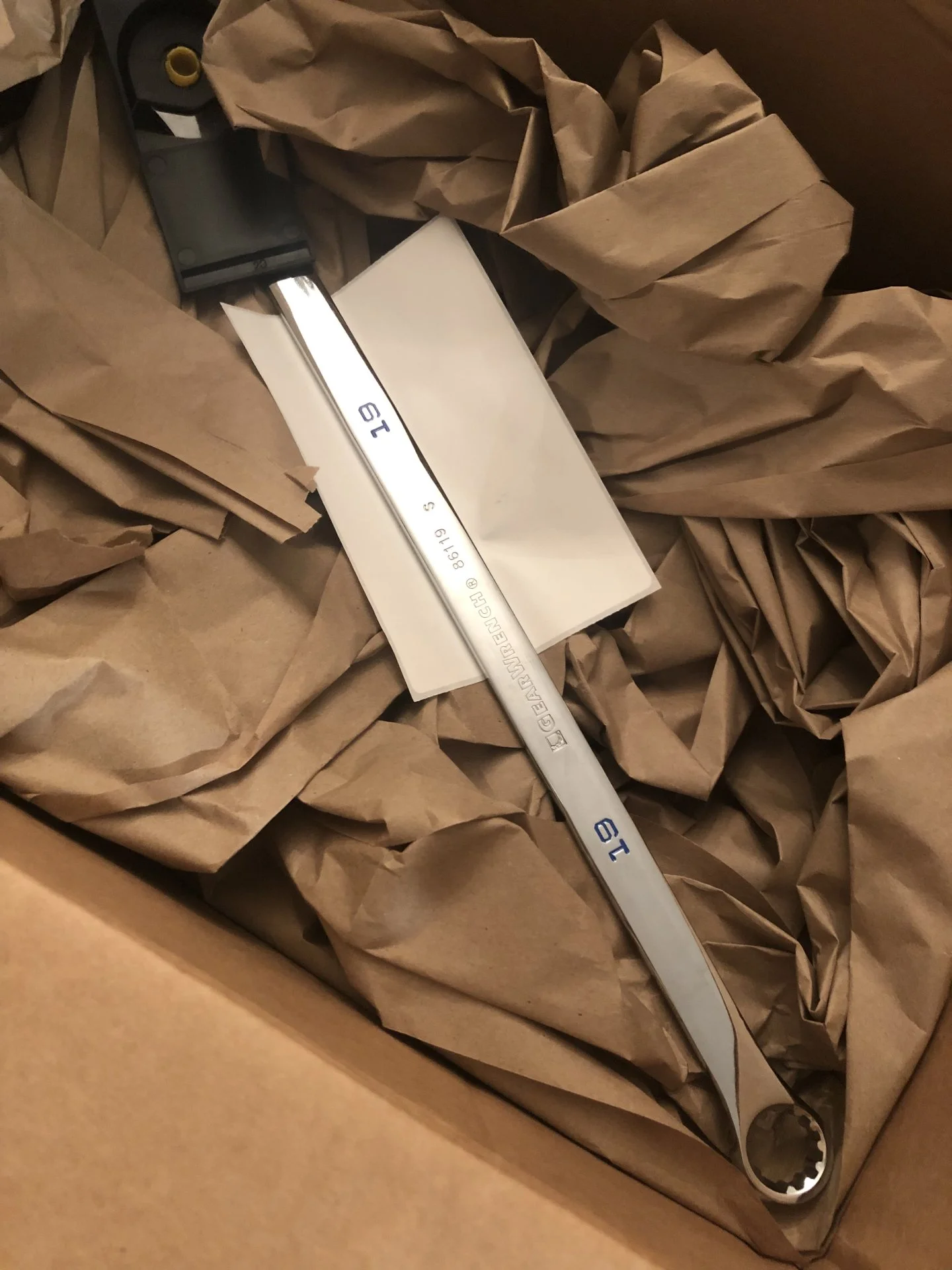

I got this in the mail today and it should help with breaking the nuts loose with the extra leverage.

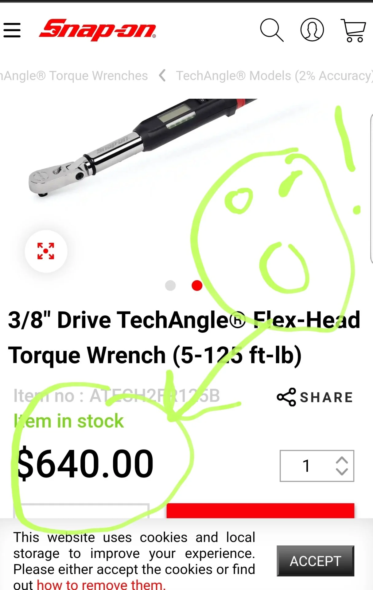

Double-O_o...
I'm clearly new to purchasing snap on tools. That'll do the trick, but at that price point, and my frequency of usage, I might be better off just going to the dealership.
Ha! Welcome to my world.

Why not a 1/2" drive breaker bar and maybe a section of pipe on the end?
Then you can use the breaker bar for other tough nuts.
Shallow sockets are too shallow and deep sockets are too long and hit the hard line next to the thru bolt. I’m guessing it’s a brake line. A shallow socket and wrench won’t work on the other side due to the fender.

Crazy money for a torque wrench that's 3/8" and only goes to 125.
