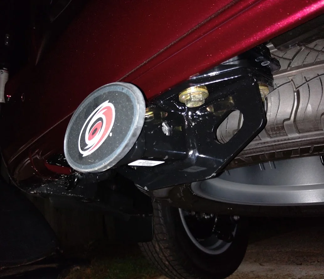

However, when I had the wheels off Amazon stopped by and dropped off my Curt hitch. Talk about a one-minute install. They even included the spacer plate!

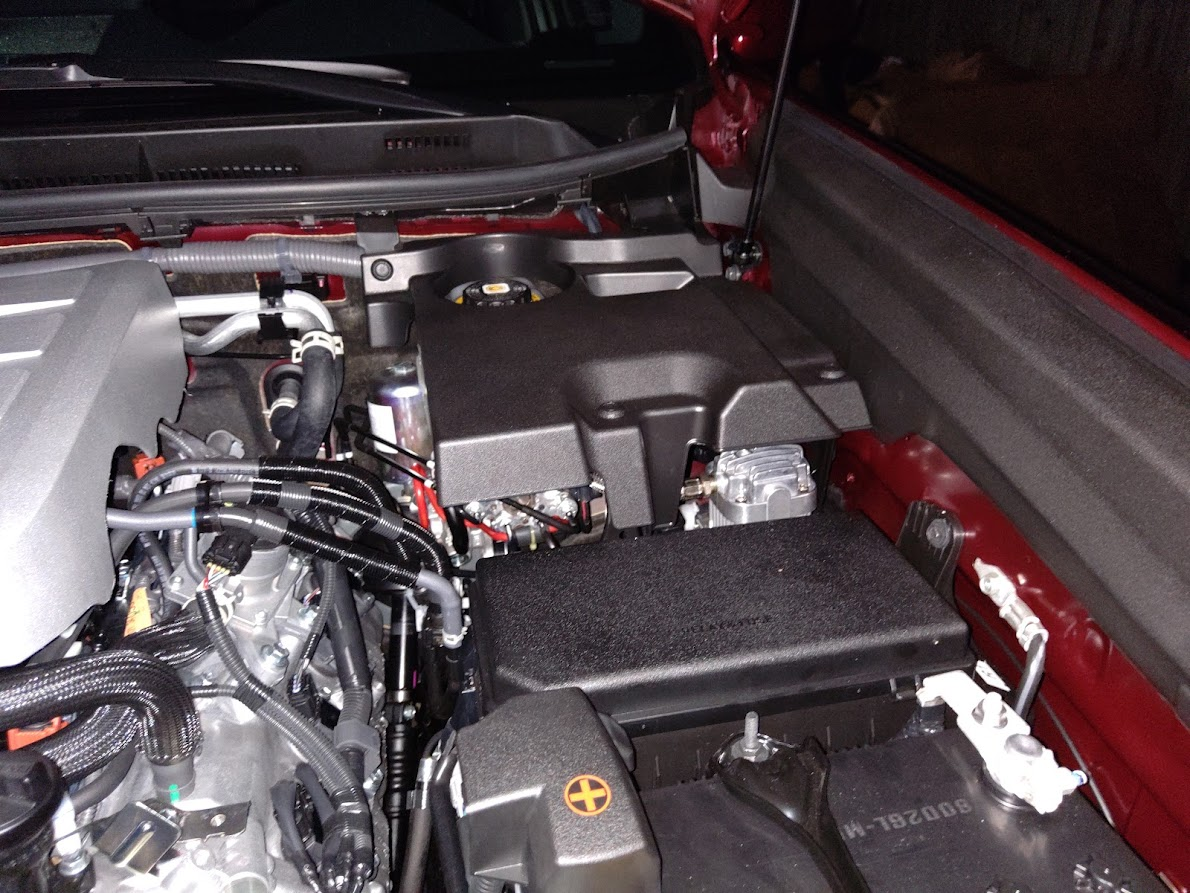

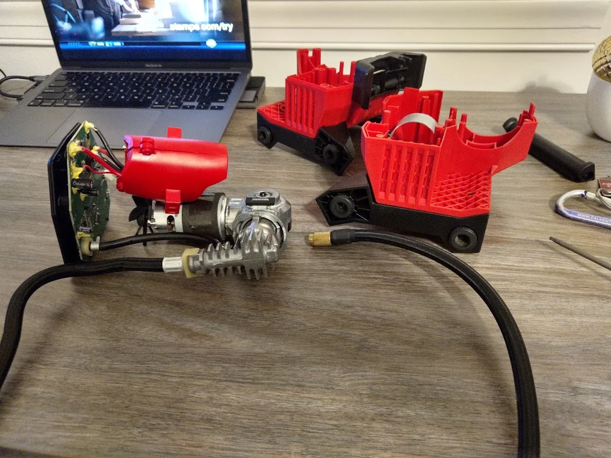

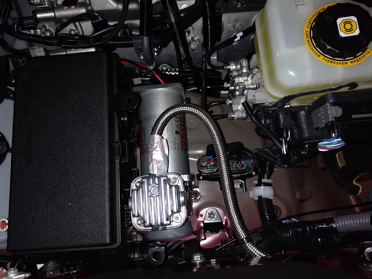

This little guy was waiting on my door step when I got home, the Viair 350C. I'm not going to be running air lockers or power tools, however I still wanted the 100% duty cycle that this provides. Drawing less than 20 Amps was also nice, and the size of the compressor wound out being perfect. For now I'm just going to be using this to air up tires, but eventually I want to find a place to put a small air tank. But for now, just mounting it would do.
For location, I looked squarely at the huge opening between the brake booster and the fuse box. There was a little module in the way, after searching the part number I found out it was the air injection control driver. I didn't have a problem relocating this part since it is not connected to any safety systems. After unbolting the driver and seeing how perfectly the compressor sat in there, I was hooked.
I bent the locating tab in for the driver bracket and drilled a hole a few inches away to a spot where the wiring would reach comfortably and not rub. Grabbed a M6x1.00 nut to go with the factory bolt to secure it to the inner fender. I nestled the compressor in there, center punched, and drilled out three 1/4" holes, the fourth hole was a hole that the factory drilled. Bolted her down and test ran it, flawless. The fuse panel had to be unbolted and moved over a little bit to access the screws, but that was really the hardest part (which isn't hard at all). I used some dielectric grease on all of the bolts to prevent rust. Seriously, dielectric grease is worth its weight in gold.
The factory cover even fits back on for a stealthy look.
If you couldn't already tell, I was well out of daylight. I'll leave the plumbing and the wiring for another day, because I'm going to do this the hard way.
I assume you're taking the control unit from a smaller handheld and using it to make it a set and one-touch deal? Set pressures to 28 or whatever with the auto cutoff, but with the VIAIR.
Exactly. I had a Milwaukee tire inflator laying around. Decent little unit for something battery-powered, but I wanted something bigger and powered by the car.
However, the control panel is awesome. Set the pressure and wait until it cuts off. The panel goes up to 120 PSI, so I could still run a tank off of it.
