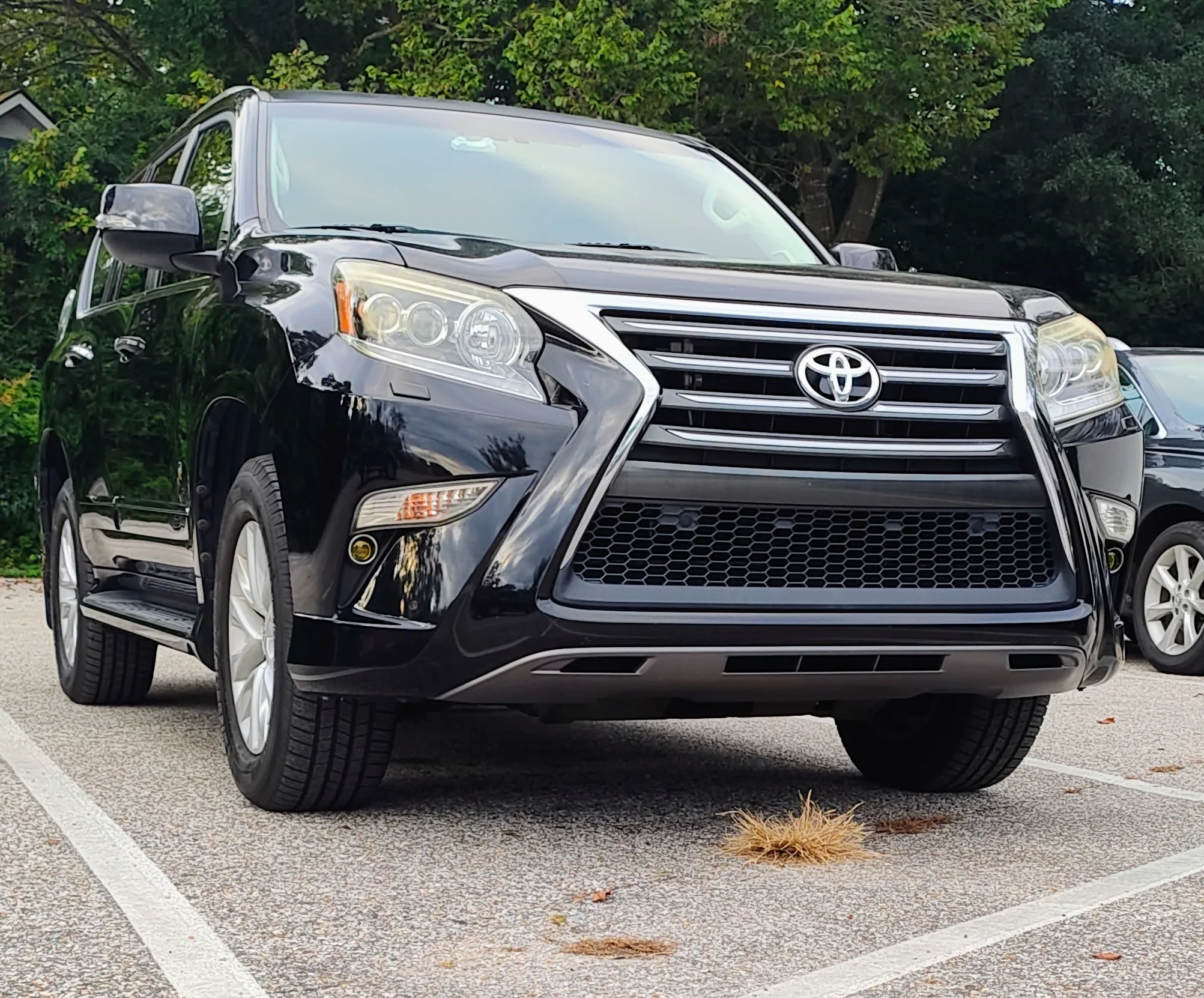

Hey everyone, I want to introduce myself and my rig.
I come from a long line of fuel-sipping hatchbacks, and I made the switch to something I can fit into better last June. THIS (in the voice of Dough DeMuro) is a 2015 GX460 with 73k mi, no rust, and perfect service records from the Lexus dealer. In short: a mall-crawler in its prior life. I researched this forum heavily before settling on this 150, and y’all seem all right and really knowledgeable.

I prioritized great maintenance history and low mileage above everything, and I got that. However, this thing has sat under one too many Florida Summer suns. I think that the clearcoat on the hood and roof is shot: the paint is cracked like a Michigan highway. Not flaky, more like crow's feet all over. I do not intend to make this Concours-worthy, but I do want to prevent rust and not get funny looks. I am open to a Maaco job just to get it into serviceable condition.

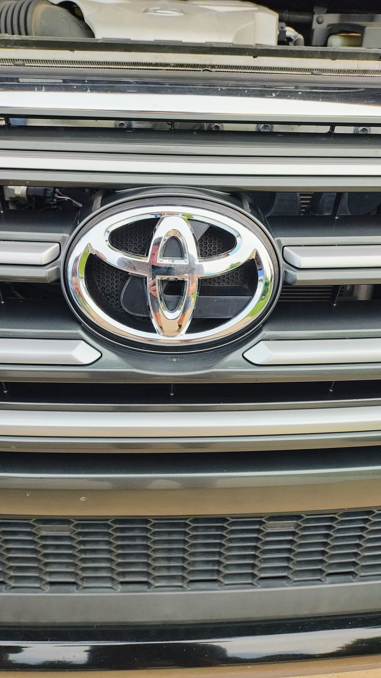

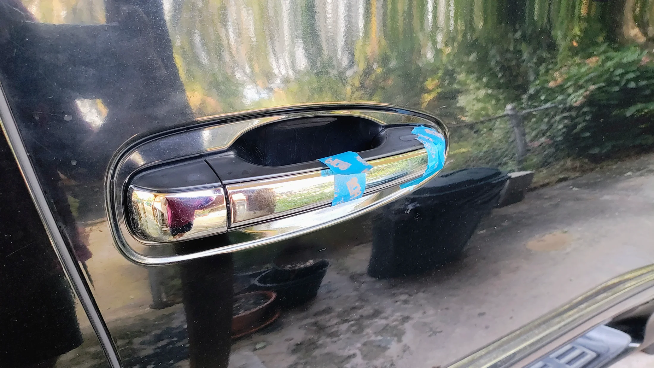

The intention of the first phase of modifications is to familiarize myself with the car, minimize spending after the initial vehicle purchase, and make incremental upgrades to its appearance. So Phase One was a Toyota badge swap, yellow fog light covers, and replacing the exterior door handle chrome.

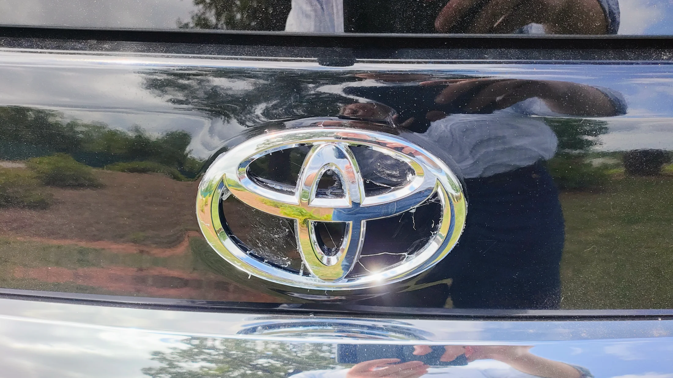

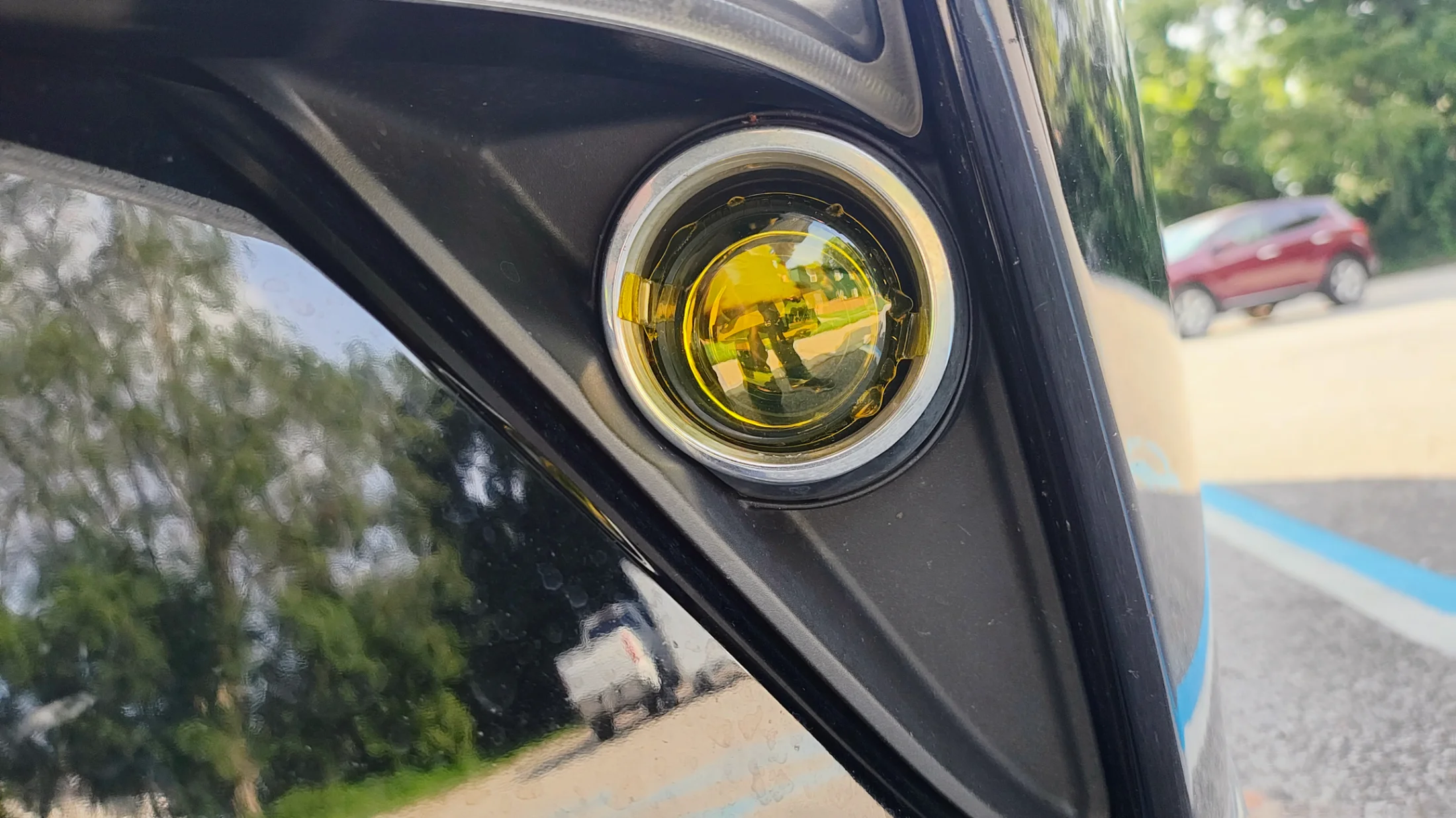

I liked the idea of swapping the Lexus badges for Toyota ones. It’s subtle and helps shield me from the perception that I’m making bukoo bucks at work. I got the part information from Sedonut’s post on here. The front swap was straightforward. Removing the rear Lexus and model emblems were completed using a borrowed heat gun, rubbing alcohol and mineral spirits. I used a 3M epoxy to affix the new, rear badge (poorly and hurriedly). It’s on my list to fix before the year-end. The fog light covers came from Lamin-ex and I put them on during a lunch break at work. Exactly what I wanted. The door handle chrome showed a lot of wear on the front driver’s side, and the front passenger’s side was missing. I bought a 4 pack off eBay, used the aforementioned heat gun to remove the adhesive, then affixed the new chrome onto the handle using the same 3M epoxy. I learned from my badge mishap and employed masking tape to hold the chrome piece down while the epoxy did its work. I haven’t done the rear chrome yet, because they are fine.
