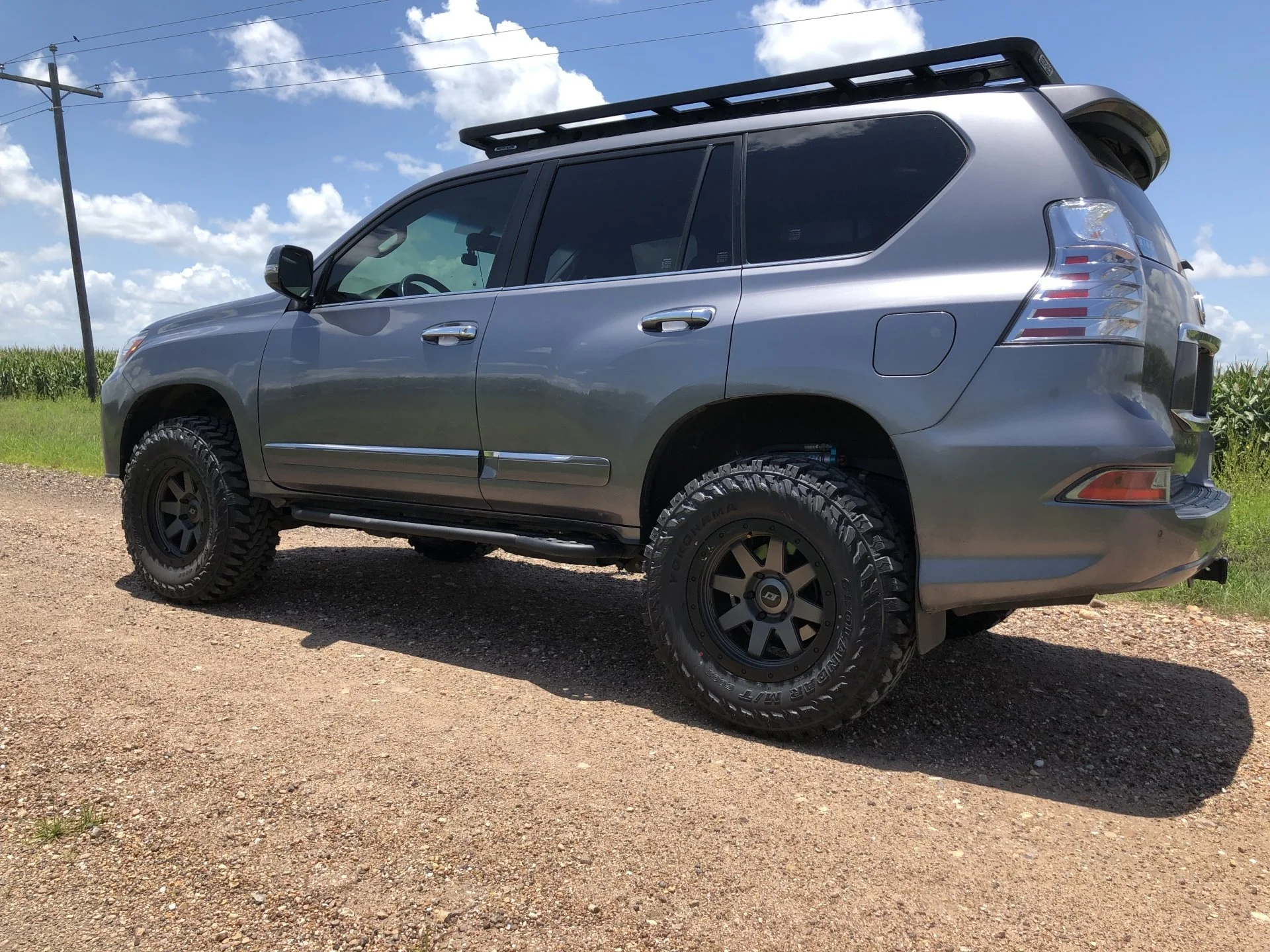

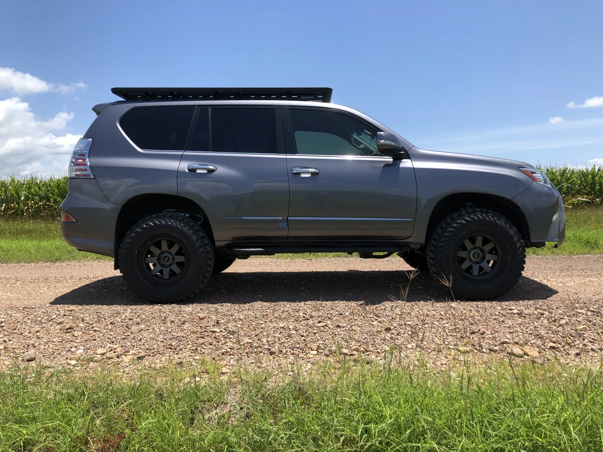

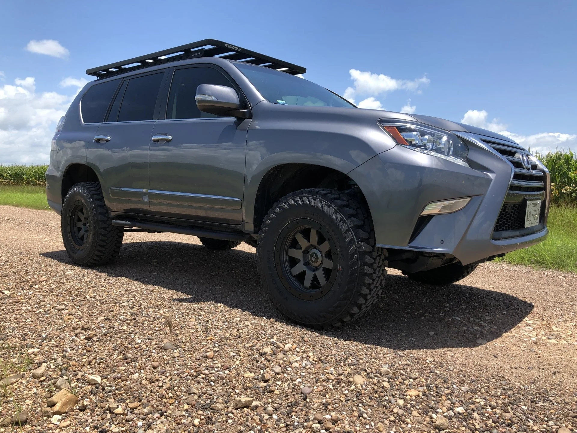

The road to where I usually test out the flex on new setups was closed off so pics on a gravel road will have to do. Not sure why they were so quiet yesterday, but I can hear them now. They’re not as loud as many MT tires, but you can hear them.
Dammit if that doesn't look bad ass though, wow, what a setup!
