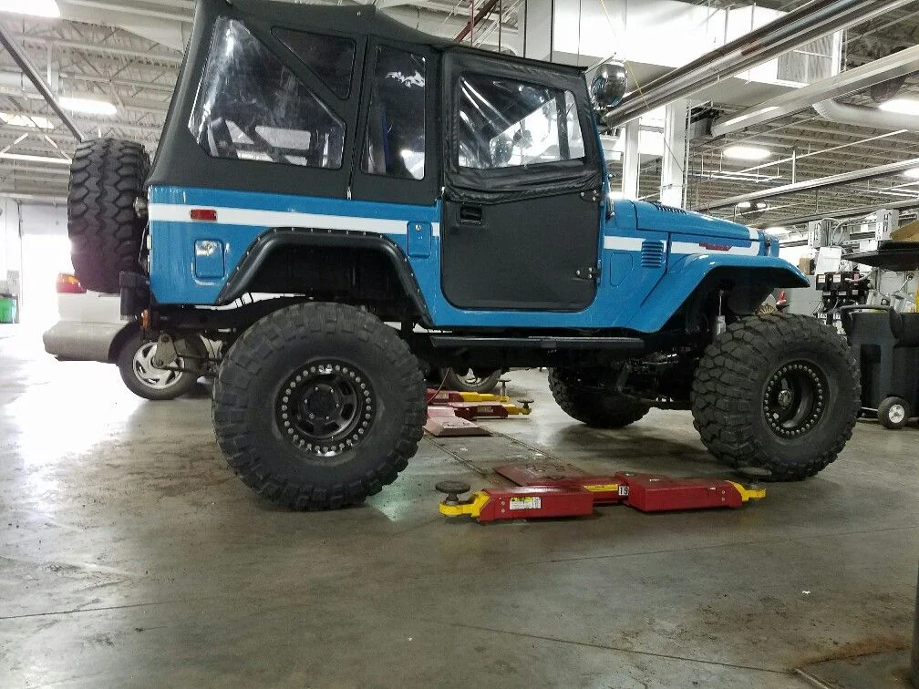

Part of problem is if you have a hard top with rear corner windows the factory soft top doors are straight and the hard top is angled. Could probably modify those but besides benting the top of the door in to match the hard top angle the window channel would need to be spaced away from the door as it goes down to keep it straight. But that is the route I would probably go. While the window at the front isn't a working vent window the door looks like a factory door and not something aftermarket/jeep looking in my opinion.
Here is a pic. I sent u a pm
