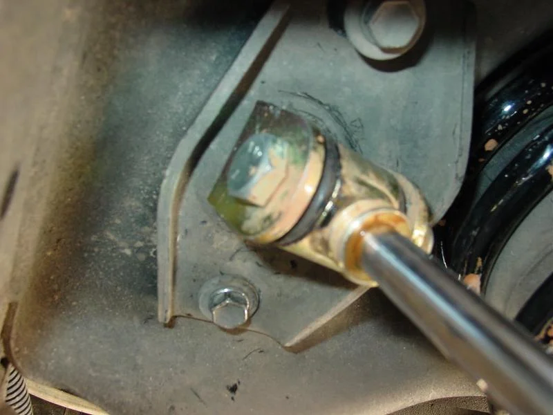

Romer - you don't ever need L shocks for 35" tires, and you don't need much more lift than you have now. These are Bilstein 5100's on a 3" lift running 35" trxus MT's using shock adapters for an eye to eye mount. Forgetting how much better Bilstein 5100's are than OME shocks for the moment, with proper bumpstop extensions there is 5" of up travel and 5" down. Virtually none of this is the wasted up travel you get with pin mount shocks when you want to run the larger tires, although the front end cannot accomodate 10" of travel or anything close to it anyway.
This is with a completely unloaded vehicle with stock bumpers, so with a more typical load on about 2.5" of lift we are looking at 4.5" up and 5.5" down. Pretty damn good for a suspension that cannot realistically use more than 10" of travel anyway without other mods. I did not need 4"-5" of lift to achieve this.
Bottom line: you don't need more than 3" of lift for 35's in terms of suspension design unless you believe that your suspension must somehow be designed on OME principles using some OME parts. I would not be looking at L shocks just to keep a pin style mount, as this is the least desirable shock mounting system...just look at how much bushing you have on OME shocks....ever wonder if 2" of bushings might let the shock itself move?
Nay
